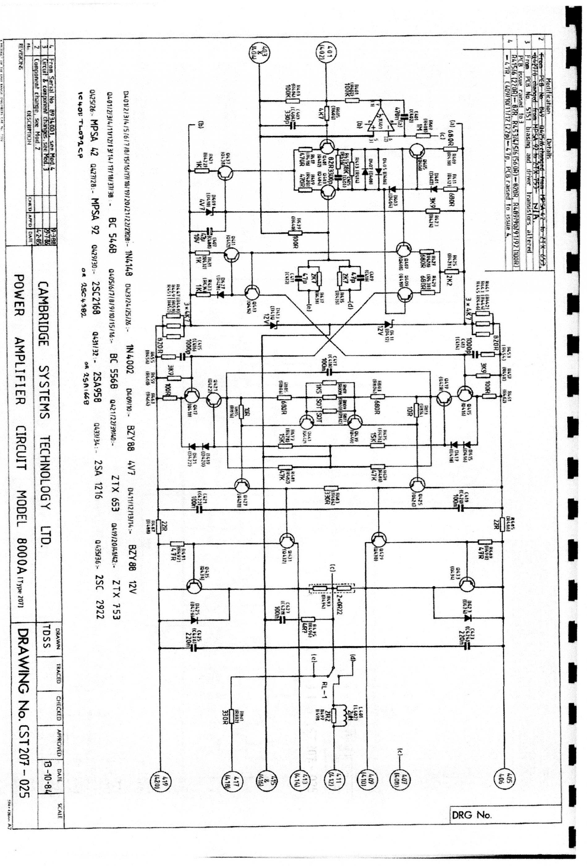

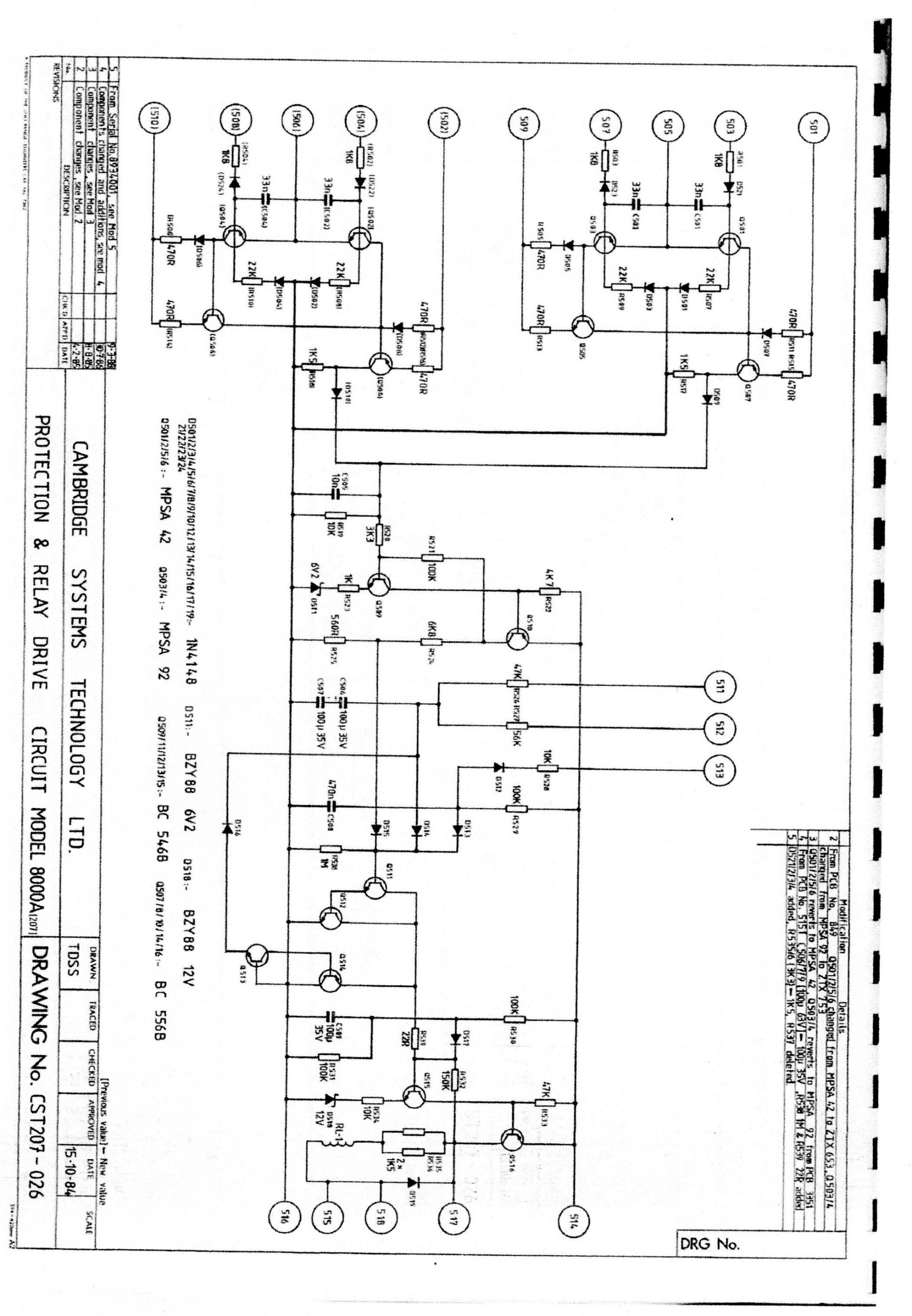

Hi
I have aquired another 8000a with a fault on the left output. It is the original mk1 with the 180 degree 5 pin din out/ins. The output transistors are short circuit on the left channel causing the 2a fuse to blow. I have removed these transistors which are BD912 and BD911's, and will problably end up blanket changing all of the other transistors associated with the left channel. Does anyone have any experience of repairing this version and if so could you share your knowledge with me. Also does anyone have a circuit diagram of this output configuration.
Dave
Dave
Sorry friends
The circuit diagram within the thread is near enough perfect. I was not paying enough attention.
I now have quite a selection of short circuit or high resistence transistors and a coupe of discoloured resistors for my collection.
Any help would be appreciated.
Dave
Dave
