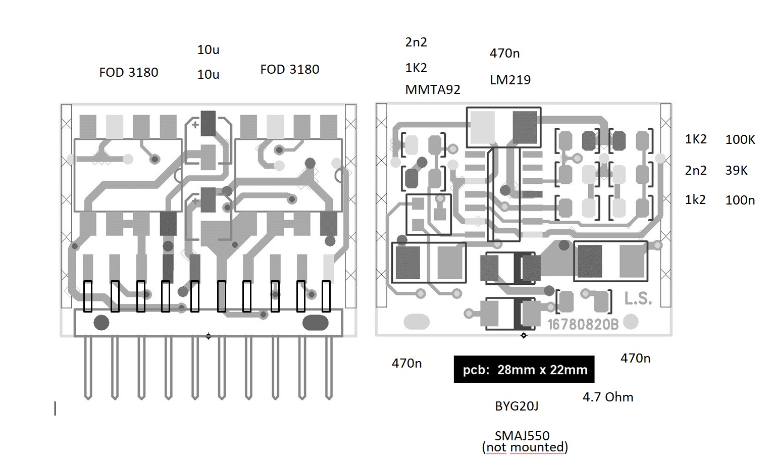

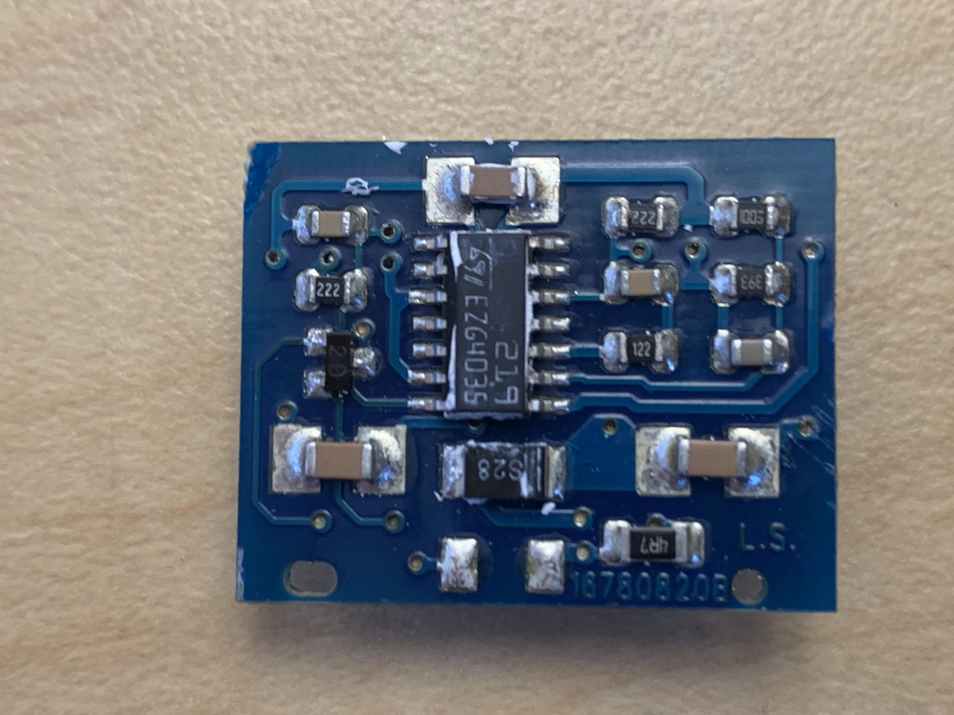

Hello. I am also looking for an AD2K circuit diagram. I bought a damaged audison srx 1d for repair. Unfortunately, the AD2K board is missing. Does anyone have a schematic of this board, or accurate photos without integrated circuits
Thanks in advance.
Thanks in advance.
If you can't buy one from the manufacturer, try to find a warranty or authorized repair shop to buy one from.
Thank you for your interest. I searched but not available. I will easily make such a circuit board, but I must have a diagram or photo of the circuit board. The image must be without a comparator and optocouplers for the paths to be visible.
The pictures above are almost good, only the LM219 and FOD3180 cover the paths.
Of course, the best would be the diagram ...

Hello. I had some time and I did pcb. I connected everything and the amplifier works, but I haven't tested at full power yet, because the amplifier is not mounted on cooling.
I have a nice square wave on mosfets, but I am worried about the frequency, it is 218kHz. In my opinion too high.
Does anyone know what the frequency should be there ???

If this is a self-oscillating class D, the idle frequency will be higher than when driving high power. If this amp is designed for higher than sub frequencies, they may use higher than normal frequencies.
I understand, but I made the control board myself and would like to know the frequency on the original pcb from the factory. I'm afraid I made a mistake. I have already measured a lot of D class and it has never been so high.
If anyone knows or can measure I will be grateful.

Why not put it in the heatsink and drive it into a load to see if it drops down to what you expect?
If you used the correct values, especially in the feedback loop (assuming that it's self oscillating), it's likely normal.
