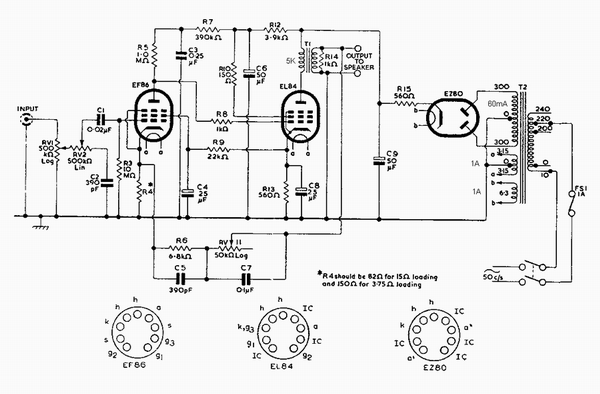

FlMike said:could r3 and r5 be omited in this amp? if so what size R would be used in their place?
You must be referring to the neat little phase-splitterless PP amp. R3 is the tone control, it & the cap in series with it could just be eliminated. R5 is the volume control, it could be replaced with a fixed R.

About the above schemi posted by Tomcat, there is a pot in the feed back loop, what does this pot do? and what type/kind of output tranny should be used??

RMS: I'm not sure about the pot in the NFB loop only to theorise that a) to be able to vary the amount of NFB to taste (it does make a diff to the sound), or b) to adjust to make up for the parametric spread in components and prevent oscilation, as whoever at the time and just as now, would not be able to access the exact same components, so this feature allows for that methinketh humbly....

I have had in my house on lone a pair of the Mullard 3 monoblocks and got wonderfull sound from them. There was no pot in the feedback circuit and a volume pot had been installed between the input jack and the 6267/EF86. I don't know how good your opts are but if you have the bandwidth this is a nice amp. I was driving 92db efficient speakers and got lots of volume before they started to clip the amps.

planet10; my amp is finished!
Hey Dave, thanks to your help my amp was a success!
I thought everyone should know that I built that first schematic at the begining of this thread and its working fine. For the most part all the values for the ressistors and caps that I used are fairly close if not the same to what is in the map. Though I did use an extra cap in series in the first filterstage to take the surge of the solid state rectifier diodes. At first testing no sound at all, then I cliped the negative feed back lead that goes to ground and it worked and I cliped the other feed back lead and there was no difference in sound so that is all gone now. Its also plenty loud enough and drives a 12" speaker very clearly.
Here are the test results:
B+1=331VDC, B+2=262VDC, B+3=235VDC
EL84= pin9=261V, pin7=311VDC bias=47mA, pin3=6VDC
