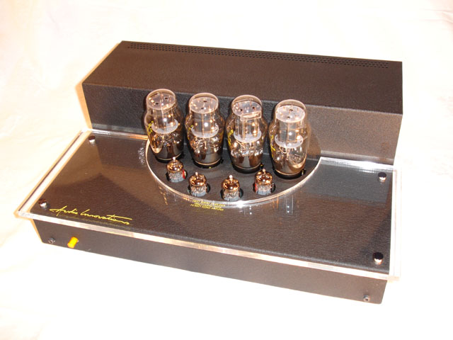

I don't know if this is the amp you were looking for. Its a parallel 2A3 Push Pull Class A
http://diyparadiso.com/mod-ppp2a31.htm
Not anyone with a schematic?
Here is a picture of the amplifier
the schematic above was for the Second Audio which was slightly different in a number of ways besides being parallel push pull.
The First Audio was just a push/pull design giving 7.5 Watts per channel in Class A
It was available in 3 forms. Initially it was supplied with 6B4G's with an ECC88 input & driver stage. decent NOS 6B4G's became harder to find but the Chinese had started making 2A3's and were able to supply Octal based versions. (New production UX4 bases were also hard to find then, this was the late 1980's! No-one else was using 300B's or 2A3's in any quantities back then.) Finally, the input stage was re-designed using ECC82's and the input sensitivity was slightly reduced.
Here are the schematics for the ECC88/2A3 which is I think the amp pictured above although the LT supplies appear to have been modified.
hope this helps.
