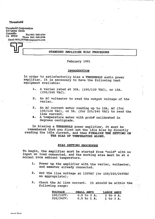

Found this reply from Nelson Pass at this forum on the biassettings for a SA/4
"Exact value of the bias is heat sinks at 50 deg C - good for a
5-10 second touch."
So stick with the value you got now.
Here's the Service manual also good for your SA/4.
This one recommends a setting of "only" 2 Amps per channel after an initial setting of 1.6A.
And another one recommending 2.1A as a final setting.
My SA/1's have some lower temperatures at the front because the huge frontplate also helps to cool down the amp.
As said before the official biasprocedure indicates to measure the temperature in the last screwhole. 63 degrees is definitely to high and the difference of 11 degrees is strange. After the amp is settled a temperaturedifference of a few degrees is acceptable.
I think you could have a problem with your Stasissection. These are the first two sets of TO3's on every side on the back then there's some space (where the driverboards are) and there are 12 sets of currentdumping devices all the way to the frontplate.
The SA/1 has also two sets of Stasis devices (divided over two heatsinks though) but they become just as hot as the rest.
Maybe Nelson can comment on this huge temperaturedifference between the middle and backsite of your SA\4. Maybe it is intended
5-10 second touch."
Wow, this is great stuff, but the uploads seem to be incomplete. Can you take a look at what's here and put up the rest?
You know, I'm still thinking about this. Should we not be dissipating 50 watts per polarity, for a total of 100 watts per side? That would take current through each rail fuse down to 1.14 amps, not 2.28 as I have it now.
The current values shown in the document are confusing (though this may be because some sections are not complete). For example, the cold start value shown for the 4e is 2.1A. I presume that's current draw from the line, not at the rail fuse.
Thanks for this!
Oh- this "locking in" behavior has been driving me crazy. Now I see it's normal and how to double check.
Thanks for this!
If your amplifier shows a 2 amp bias, then it will enter
cutoff at 4 amps peak, which into 8 ohms is 4 X 4 X 8 =
128 watts peak which becomes 64 watts rms with a
sine wave.
So you need 2.5 to get the 100 Watts Class A RMS:
2.5 amp bias, then it will enter
cutoff at 5 amps peak, which into 8 ohms is 5 X 5 X 8 =
200 watts peak which becomes 100 watts rms.
This is along the lines Nelson explained it to me.
I would not bother to much with the math or values in this manual.
Just see them as a guideline how to bias your amp properly.
If you keep your amp beneath 55 degrees Celcius it's okay.
What worries me more are the temperature differences of more then 10 degrees.
I'm not familiar with the 'E' series amps (the last series supervised/designed by Nelson Pass) but I know that the outputstages of all the Stasis amps starting from 1983 till 1992 are pretty the same.
Succes
