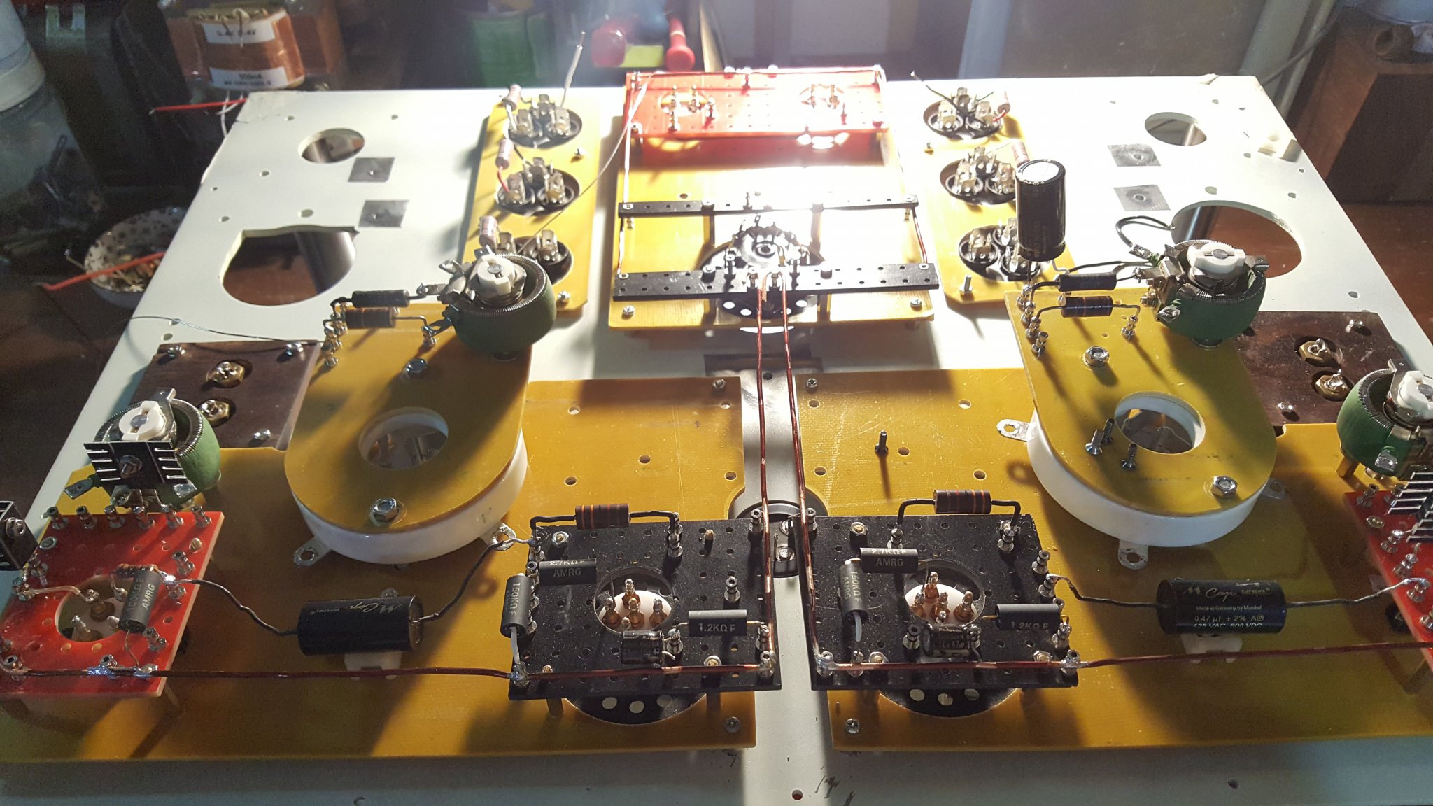

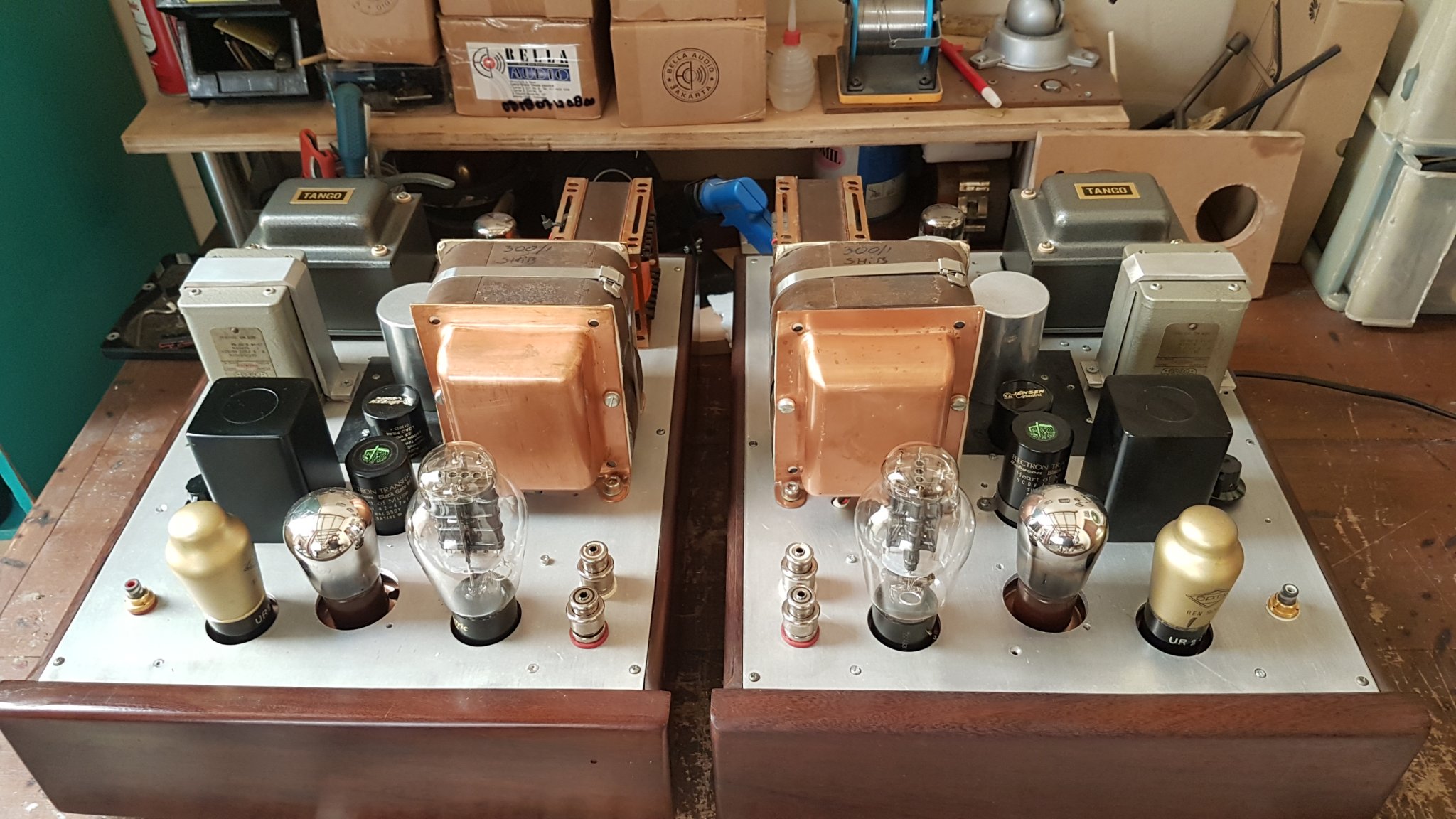

When looking at your postings on this forum so far, I see lots of planning, which is of course is great, and at least for me, part of the enjoyment of this hobby.
Did one or more of your plans materialize? If so, could you show us one of your builds?

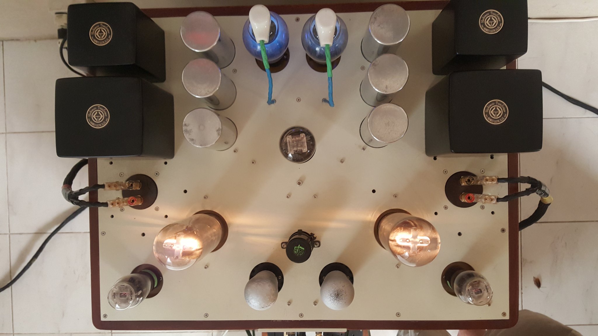

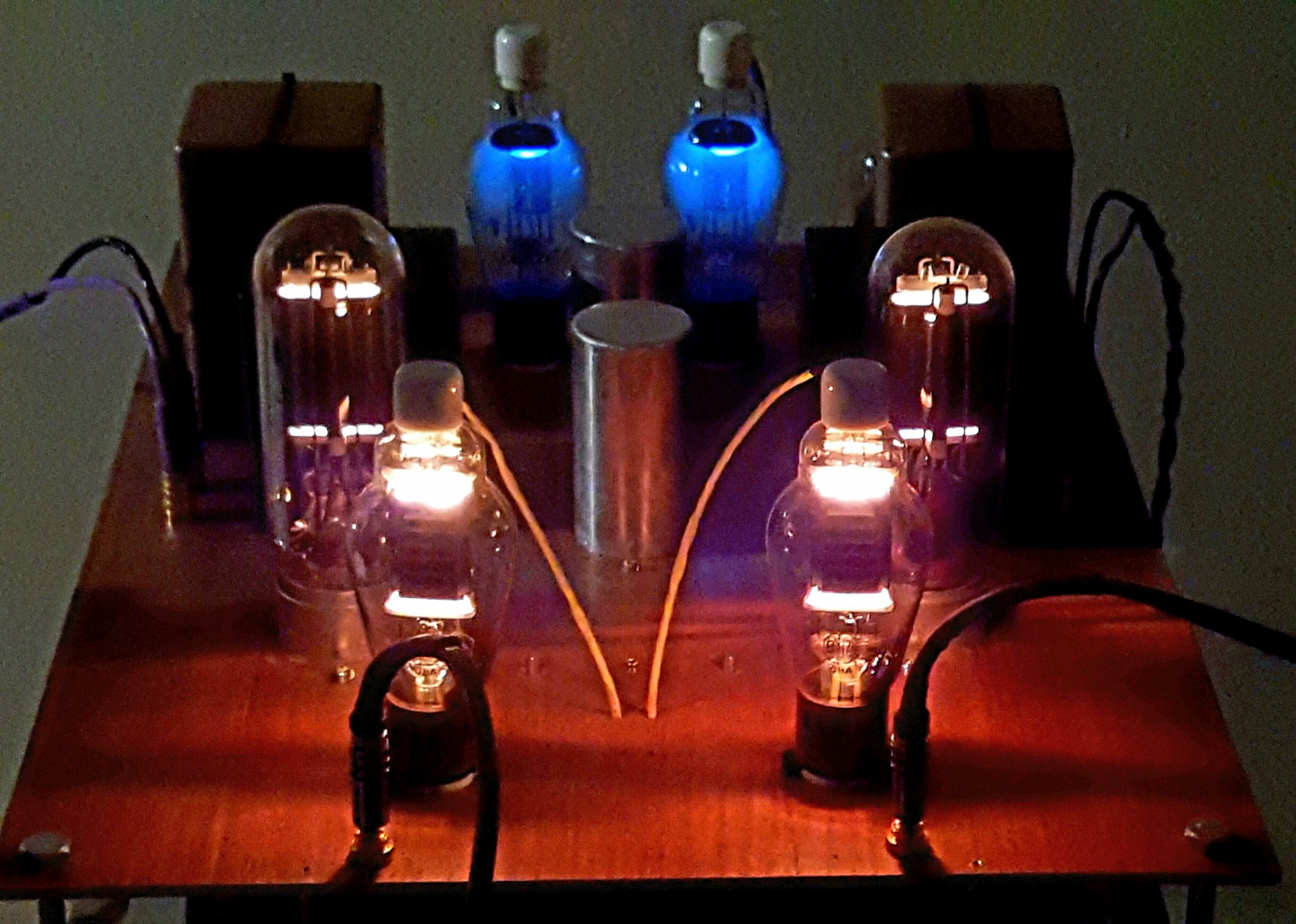

i have tried it,with IT 1:2 DIY.
it just ecperiment and i have change with 2stage+ IT
ren904 + B403 + 211GE + OT 10K

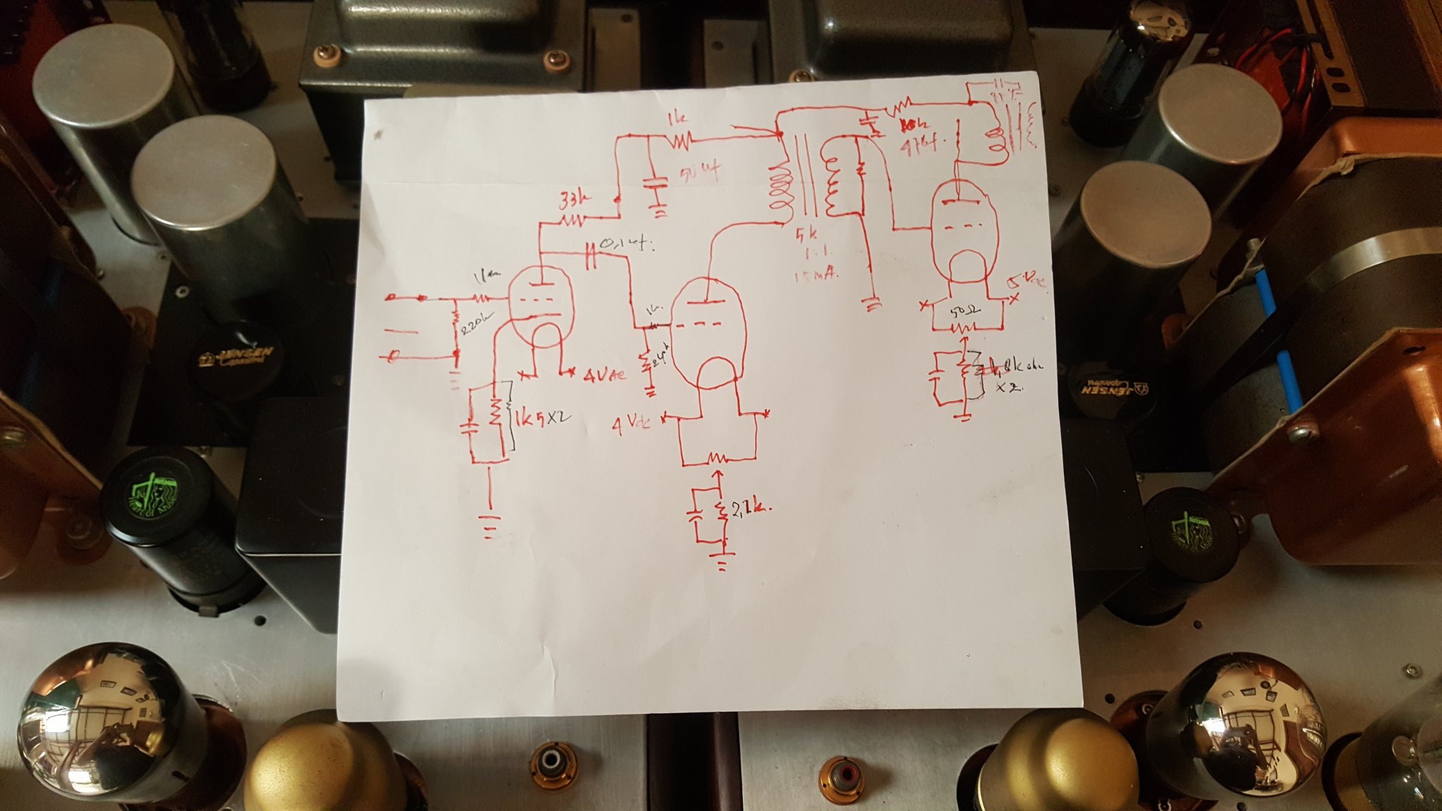

It's a nice tube the REN904. I have a few, plus more of its equivalents like AG495, K1694, E428, A4110. These are all really good sounding triodes with a mu of around 30 - excellent driver tubes. Very few people use these old radio tubes or even know about them. They're a European tube - very few made it over to the USA, but they're prized in Europe.
I really like REN904, as an input tube, an indirect heat triode tube which is mu medium an alternative solution for DHT.It's a nice tube the REN904. I have a few, plus more of its equivalents like AG495, K1694, E428, A4110. These are all really good sounding triodes with a mu of around 30 - excellent driver tubes. Very few people use these old radio tubes or even know about them. They're a European tube - very few made it over to the USA, but they're prized in Europe.
I apply it to my 300B SET Amp. with REN904+B403+IT+300B, have nice Sound.
NOTE: CORRECTION IN PREVIOUS POST, REN904+45+211.
