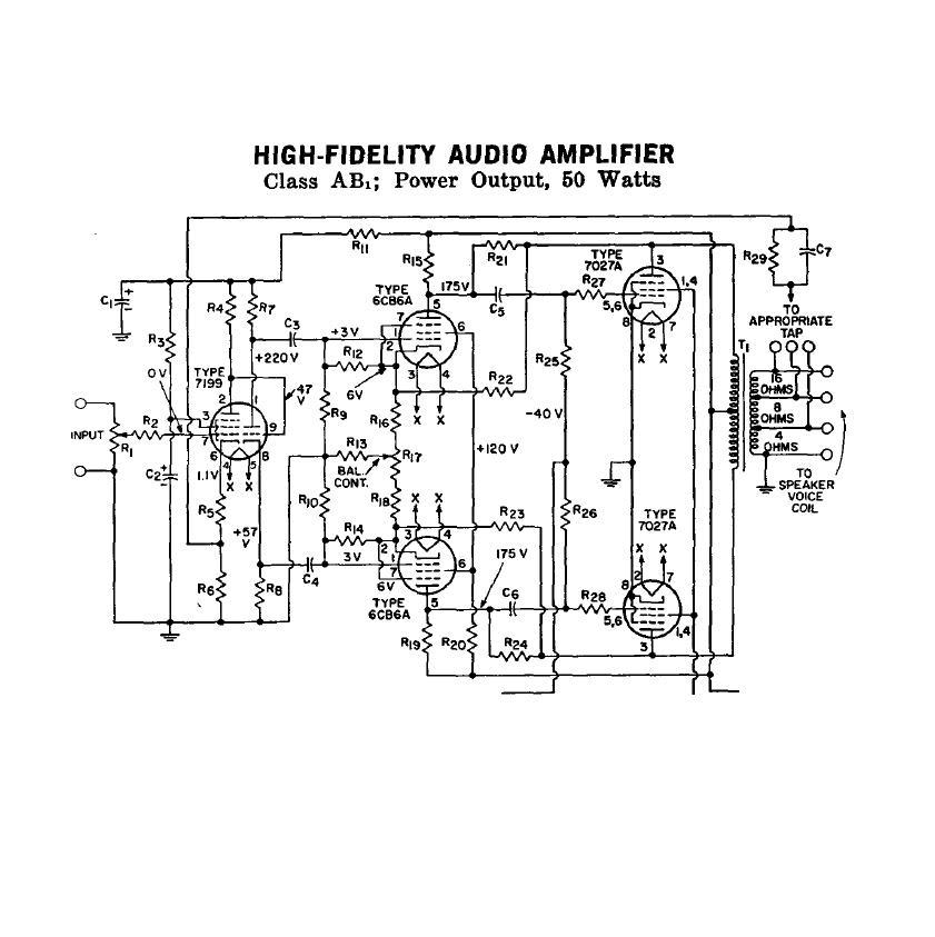

As you add stages in an amplifier there is enough phase change between the input and the output so that negative feedback becomes impossible. The feedback becomes in phase and positive so the amp becomes unstable. I've built a few SE amps using Schade, or plate to plate feedback. Is there any reason you couldn't use this feedback in a differential push pull design?
Since the feedback loop is confined between the plates of the voltage amplifier and the output tube the phase difference is, I think, 180 degrees out of phase. But my real question is would this also work in a differential PP design?
I've looked at the schematic and there seems to be a mistake in the description of the circuit? It appears to me that there is output tube plate feedback to both the plate and the cathode of 6CB6A. Via r21 to the plate of the 6CB6A and through r22 to the its cathode. I've included the excerpt from the RCA description. Am I missing something here?
What would be the purpose of feedback to both the cathode and plate of 6CB6A?

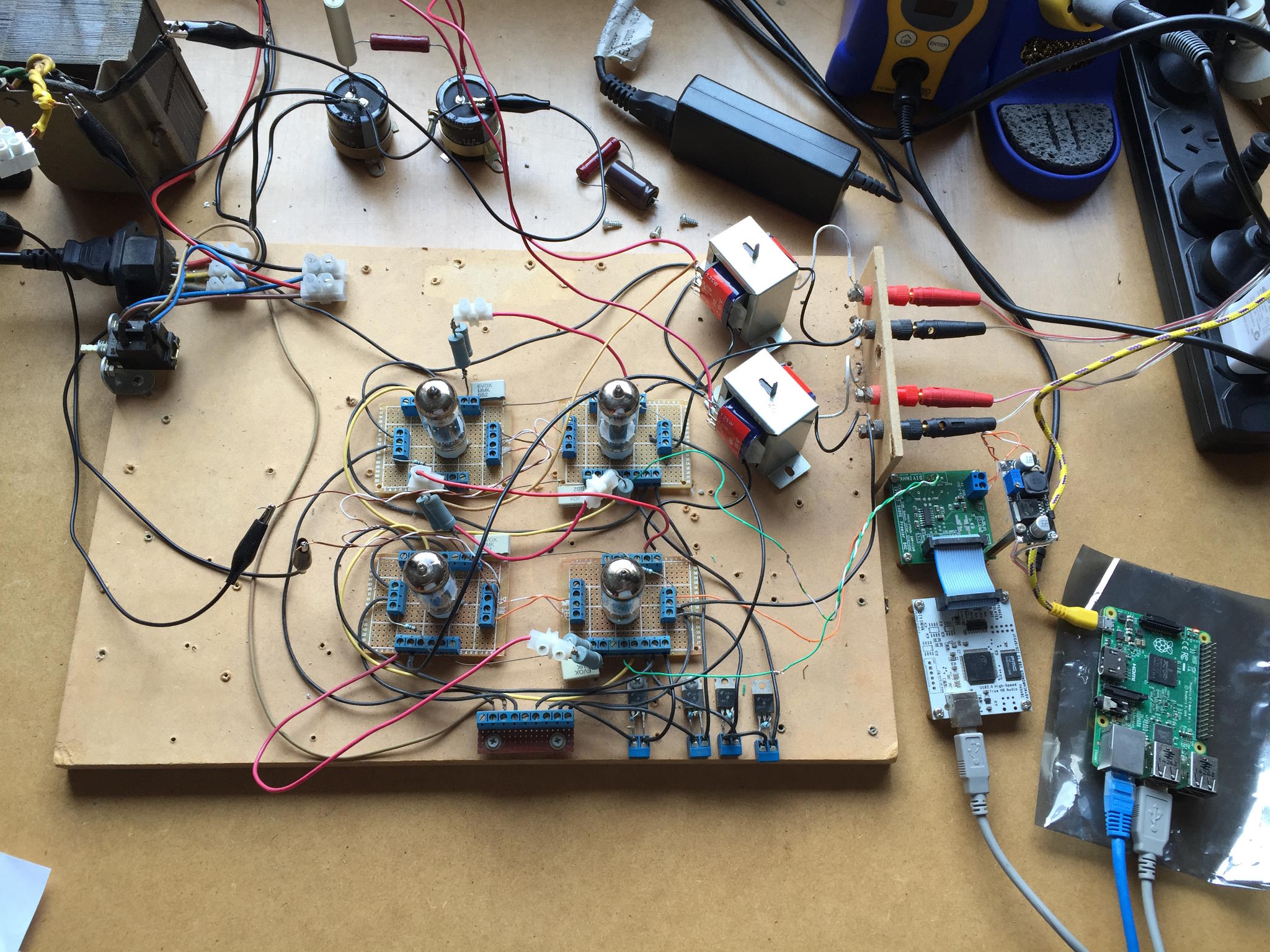

Hi mr2racer,
It works, listening to one now - a pair of 8CS7 (dual dissimilar triode) per channel, line matching transformer (Altronics M1115) driving near field speakers either side of the monitor. The voltage stage is CCS/LTP, the power stage is CCS/LTP and the VA and PA plates tied.
Also see Baby Huey for an example of feedback.
Scary:
I wasn't thinking of using the global feedback at all. Wavebourn is there any reason to use feedback at both the plate and the cathode?
Yes, to reduce current required by the tube.
As you can see from the schematic diagram, there is no dominant pole compensation. That means, the amp with nested feedbacks is stable. No deep global feedback is needed, but it helps to sweep the rest of dirt under the rug. Find values of resistors for that RCA amp, and you get a very good project. Playing with nested feedbacks I come to similar result in my Pyramid amp, with no need for a HF compensation.
