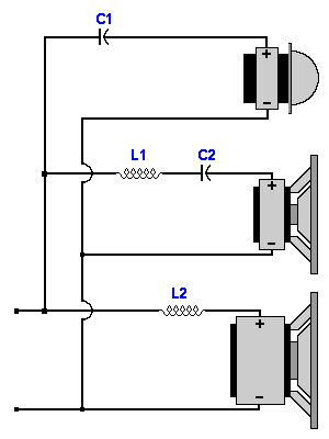

OK. Assuming the mid has an impedance around 4 ohm and we go for an attenuation of 3dB, here are some values to start experimenting with:
Series capacitor of 33uF followed by L pad resistors (see attachment) R1= 1.0 ohm and R2 = 10 ohm. Both resistors to be 10/15W ceramic (wire-wound) types.
Since that amp puts out ONLY 5 watts max, a smaller 3-5W resistor will be just fine.

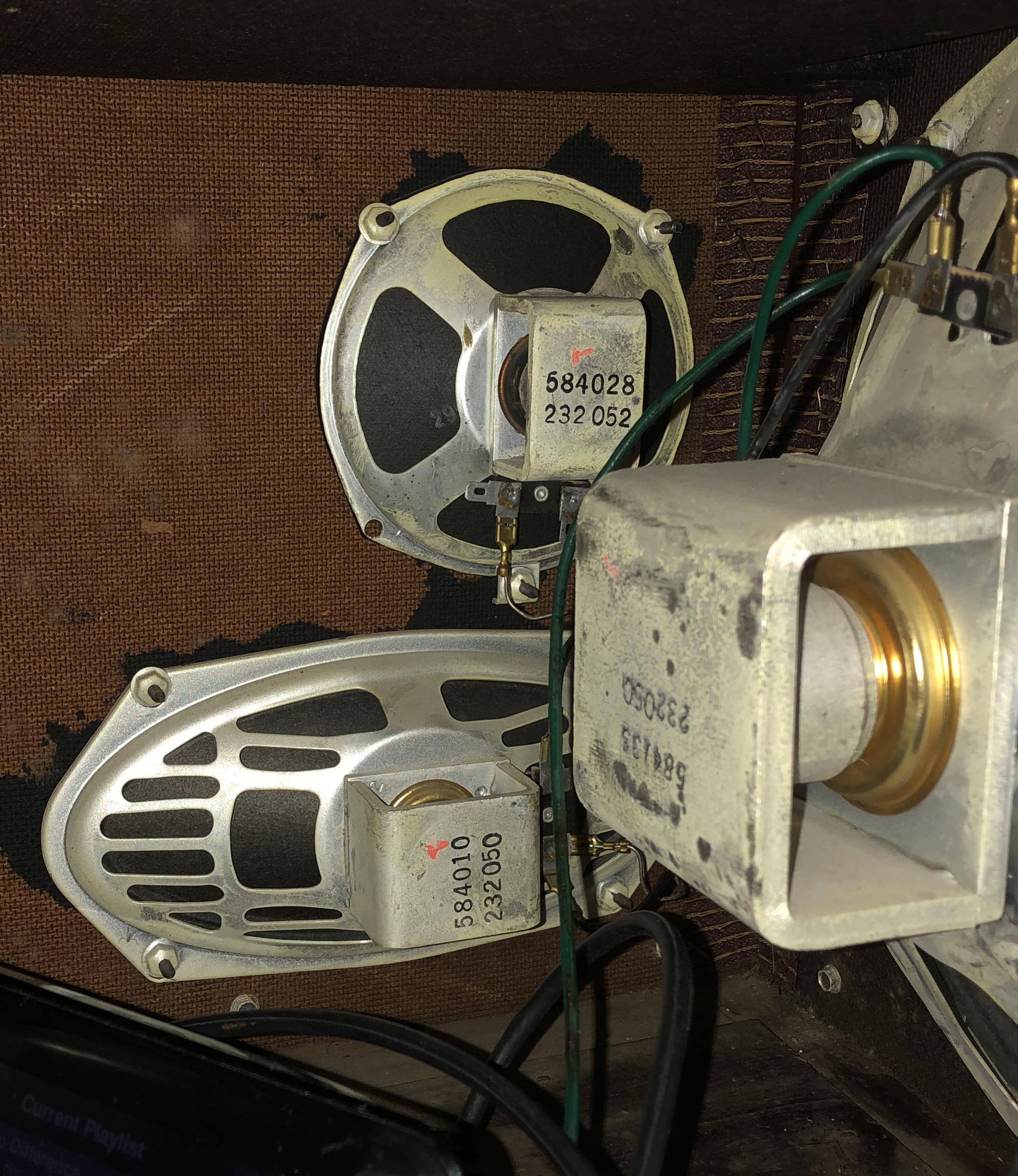

One quick question; on the original mids, which terminals are which? They are not marked on mine so though I should be sure they are wired correctly.
Does yours have a wiring diagram pasted inside? Mine portrays all speakers in the orientation as they are installed, and the colors match the diagram exactly.
Caps seem to be on the colored leads, so I assume they are positive.

I had one mid wired one way and the other the opposite for some reason - it’s been that way all along and I hadn’t noticed. They rotated the two drivers 90 degrees from each other but then wired them the same way (I.e., positive on bottom). I just presumed that the positive is to the left of the number and changed one accordingly.
I also have two 4 ohms small full range drivers from an old set of Harmon Kardon desktop speakers and put them in tonight in place of the Vifas and BIG difference in terms of top end presence. They don’t sound all that great as they’re just cheap drivers and full range to boot (so the upper mids are too much) but this gives me a sense of how important impedance matching seems to be with this setup. I’m going to also order the cap to do the highs boost tomorrow.
