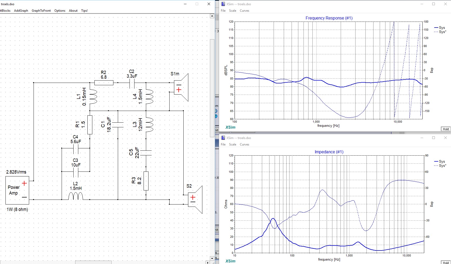

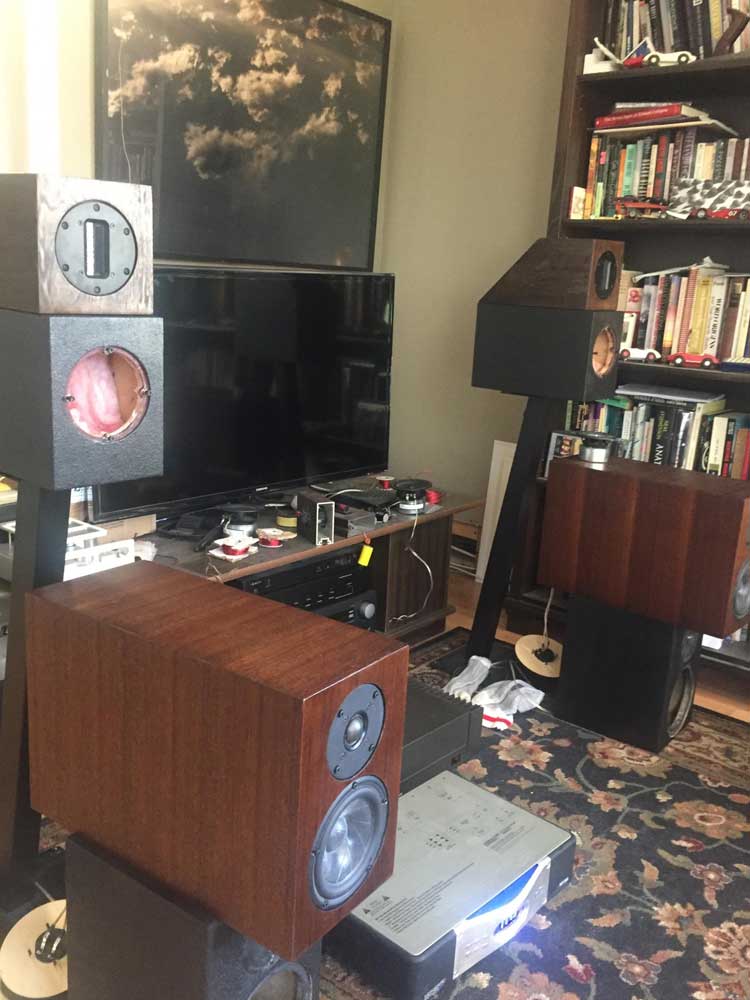

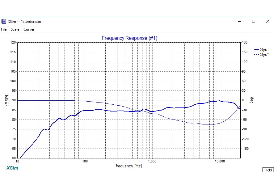

Finished my speakers but took a short cut. First order crossover instead of the monster super complicated Series crossover Troells designed for me. Thanks sir.

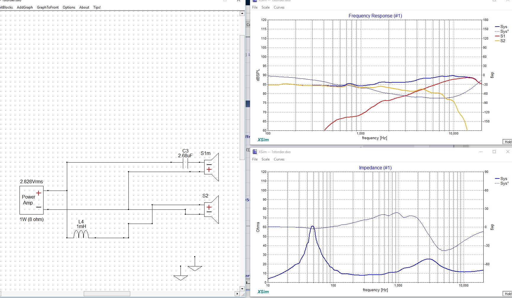

In x-sim this first order crossover simply tames some of the peaks that his steeper crossover requires notch filters for. So I felt justified and I just wanted to hear these ScanSpeak drivers.
Most amazing sound my house has ever witnessed.
Middle reddish boxes sitting on top of black boxes intended for SDx7 2-ways

8530-k00 midwoofers and 2905-9500 tweeters.
Troels had a small 10 litre design (Ellam98) for a similar pairing but different tweeter ... the 9400. I wrote and asked him if I could use the same crossover and he generously designed a new crossover for me. This was over ten years ago. The crossover seemed to daunting and expensive and I had never done any DIY. A friend who gave up on society gave me these drivers. My father made the baffles for me before I had any tools. He put the tweeter directly above the woofer despite my instructions to offset each tweeter opening the opposite way as in the Elam 98 design.
So I got into DIY and used cheaper stuff and learned a lot over the years always meaning to return to these ScanSpeak drivers. I just never did. Plus the crossover bill of materials was going to cost over $500...
So I eventually bought all the parts and still haven't built his crossovers. I just got sick of having this incomplete and wanted to hear these drivers. His earlier crossovers were said to be 'overly polite' so who knows if I'll actually like them. I like more forward mids. I will build his design eventually I'm sure. Despite my changes these are the best speakers I've heard in my house.

Cabinet has the back 1/3 for the crossover and I'm still having a hard time fitting everything for Troels's complex crossover in there. Port passes through that rear compartment approximately 6" to the very back of the cabinet.
More on first order crossover later. Basically 1.0mh on woofer and 3-ish(can't remember too late here) on tweeter. Inverted polarity on tweeter.
Port is 2" diameter 6-7" long flared.
Cabinet is 19mm mdf veneered with scraps from work. Danish oil.

As said above, 1.0mh on woofer and 3-ish(2.68) on tweeter. Inverted polarity on tweeter.

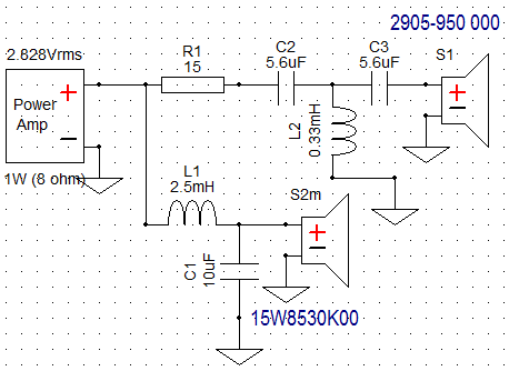

Attached are my first order quickie crossover and Troels' Series crossover.
10.5 litres. The rear 6 liters is for the massive Series crossover I will implement next.
As I said above: Scan 8530-k00 midwoofers and 2905-9500 tweeters.
The front is an A4 size based on a sheet of A4 paper in an early Troels design. About 18" deep.

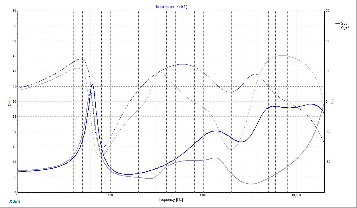

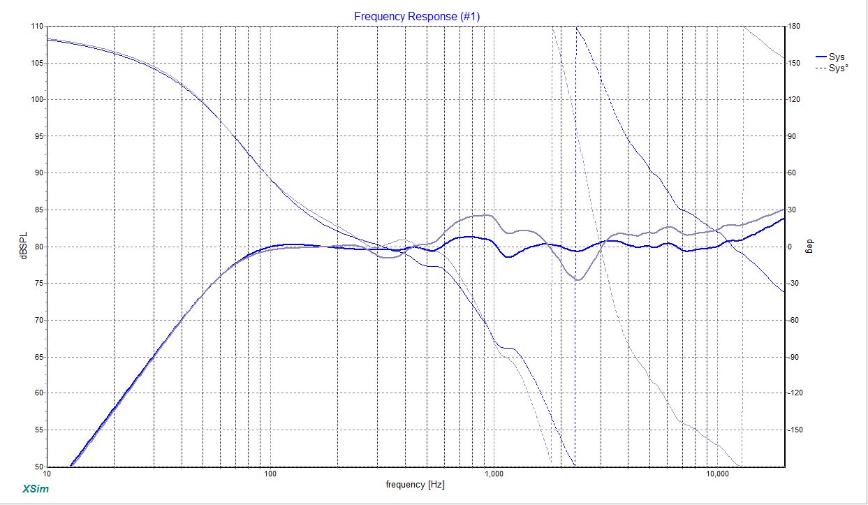

FR curve didn't go low enough. Here is the FR curve to 10 Hz.

Is the rising treble hard on the ears? Maybe a simple L-pad to cut down the treble a bit?

Do you plan to adjust the tweeter padding at all? Seems it might be slightly loud compared to the woofer.

I have resistors waiting to build a voltage divider for each speaker's tweeter when I get home from work.
Hello Gringo, I find Troels' series filter version, at least in this hypothetical situation, too complicated in comparison to mine (parallel), which is comprised of half as many parts. The blue line graphs are mine.
I traced the ScanSpeak curves to create FR and Z curves for my X-Sim. Where did you get curves for these drivers?
