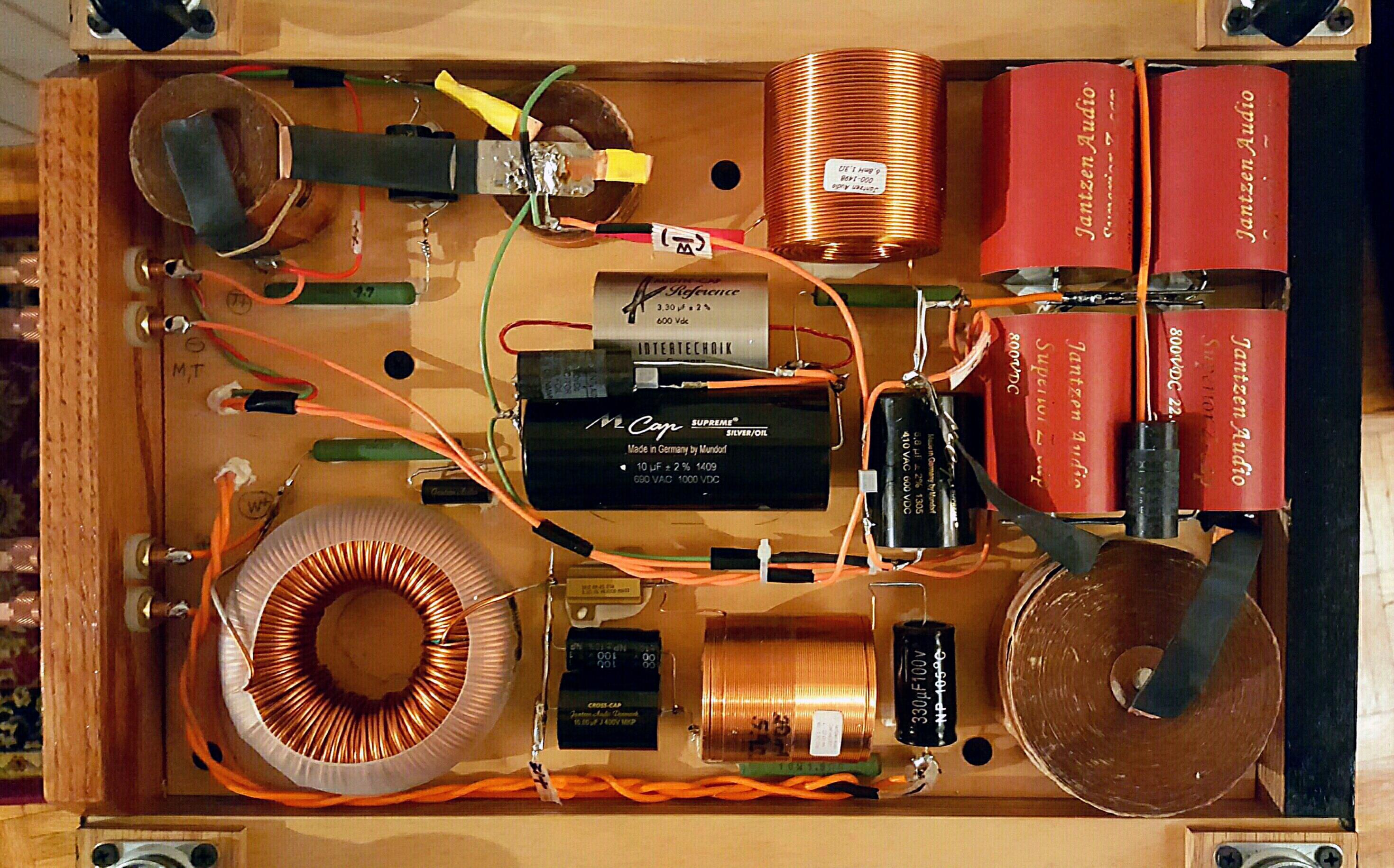

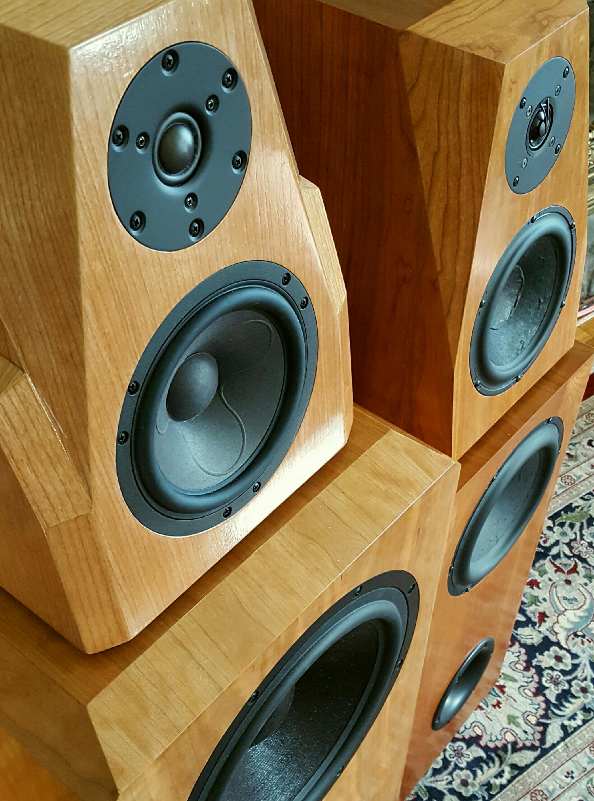

Here's a photo of my Scan-Speak "1371." Very similar to your project, it's a 3-way using a Visaton TIW-300 and 18WU mid and 66000 tweeter and it has become my reference speaker. I used a Visiton, simply because I had it, and it's very punchy. Crossover points are 170Hz/2.1kHz, passive, 2nd-order series-fed mid tweeter, and 2nd order parallel woofer. Large mid cap is Superior Z-Cap, and the tweeter caps are Mundorf Silver Oil + Audyn Reference, with Duelund 0.01uF Ag and Vishay MKP1837 Bypass caps.
Also in the photo is also my Scan-Speak Classic "871" 2.5-way using 21W/8555, 18W/8545, and 98000 drivers. It has a series-fed crossover as well, using Mundorf Supremes Caps with Vishay MKP1837 Bypass Caps.
