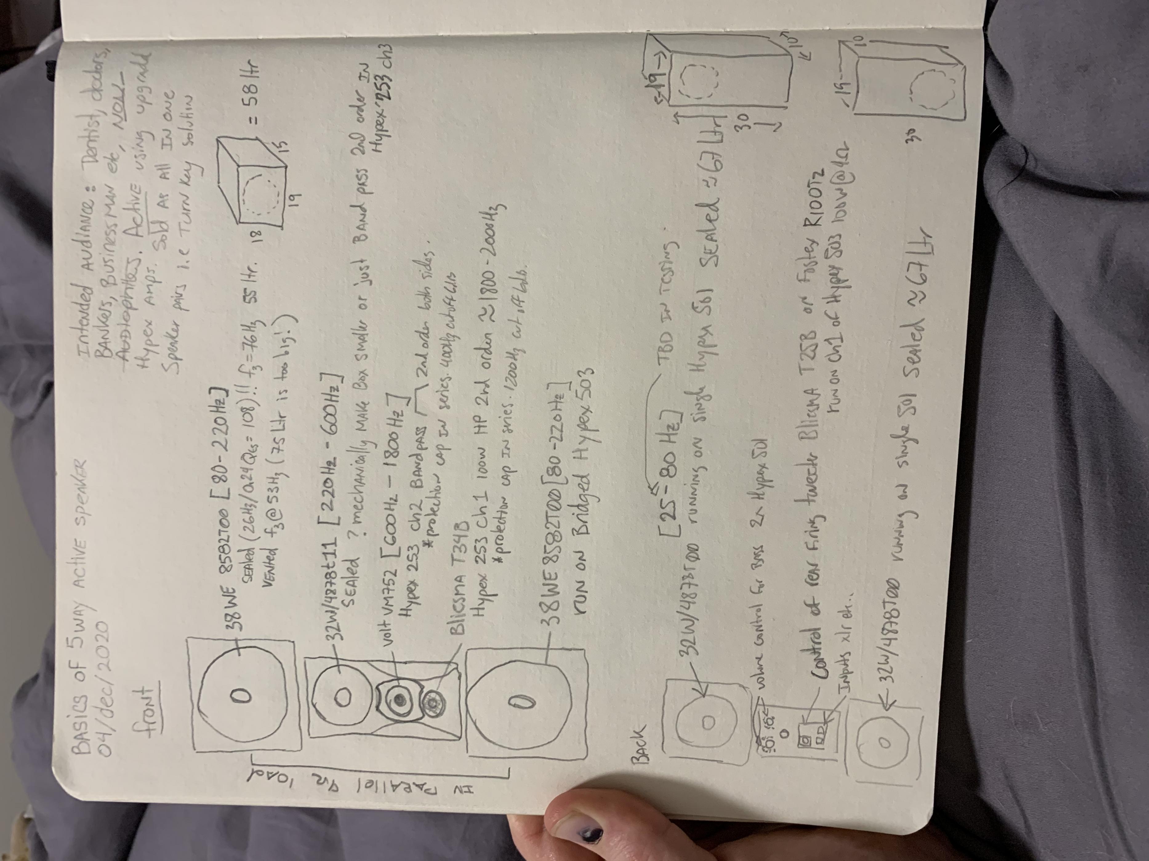

Long time reader, first time posting
Looking for constructive-ish criticism here. I am well aware these drivers are rather expensive. Part of my selection criteria is aesthetics..., my intent is not so much Diy home audio though I started diy speaker building in college and now have my own company that is dedicated to loudspeakers, which is a very NON-lucrative Loudspeaker company with only me as employe who does all the work, so in a sense I am do it yourself.. Please dont kick me off your website, I need help where ever I can get it.
So I purchased 4 of the 38WE/8582T00 woofers and plan to use them in a 5 way production active speaker. The 38WE would be used from 70-80 Hz or so to 200-250 Hz. They would be wired in parallel and run on a single 1000w rms amp rated at 4 ohms. The main questions I have for you guys is should I make the cabinet housing these drivers sealed (Fs/qts 26/0.24 = >100....so kinda answered my question but im sure they are nuances I am unaware of..or maybe not) or go the Bass reflex route with a shorter port tuning to achieve the around 75-80 Hz? [my motivation for going sealed route is to avoid the two large impedance spikes that come with the port design for a single spike] the Fs is 26hz...so yep thats where Im at currently debating with myself... I am sure I am forgetting something anyway any help would go a long way.. thanks
* The lowest octaves are handled by two 32W-4878T00 (on mounted on back of each tower) these I am pretty set on running in sealed enclosure and each run on own Hypex 501 amps and using the dsp to push it to work lower possibly/ideally getting the f3 around 25Hz and adding 5-6 dB gain in hypex setting to match level of rest of system.
Background: I started a speaker company almost 2 years ago and have only done custom work as of now, mostly for restaurants and bars. All my designs up to this point have been done in collaboration/with the oversight of Christian of Solen(I live/work 20 mins away from their warehouse so it makes things easy to test/ return and such) I am planing on offering up my first design production speaker this year for sale, It's a 5 way active speaker, currently starting off the r&d. Hoping to have a couple pairs made for 2022 audio show circuit. Would appreciate any help/feedback I can get. I added a picture of my design as I did not want to write it all down here (picture worth 1000 words..and such) Please let me know what you think

I hope you do not intend to make money with this business. Even the best speaker designers are not guaranteed to find financial success, and from the way you describe things, I think you are biting off more than you can chew.Long time reader, first time posting

why low Qms is bad ? can you explain please, i have NAIM DBL with ATC 15" woofer with Qms 1.59 , they sound great.I have seen distortion measurements of other Elipticor drivers and I was underwhelmed. Furthermore, the Qms is very low. This is bad.
None of the above 15" drivers has the acceleration of the new Ellipticor, the closest rival is BMS with 15% less acceleration
why low Q would be bad thing, a perfect woofer would have no resonance, i.e. flat impedance and flat spl and flat line means Q=0, or i miss something ? Isn't Q a measure of the steepness of the resonance i.e. the Fs devided by the bandwidth at -3dB? so flat response infinite bandwidth and zero Q ?Sorry to burst bubbles, Altec did this years, like decades ago. This low Q 15 is a mid bass pro aplication driver at best. Yes it will play loud, but not in the lower octaves one would expect from a 15" in a hi-fi application. As a hi-fi woofer it is an expensive and near useless driver. Too bad.
There are two sources of damping at the resonance frequency (Fs); the electrical damping measured by Qes and the mechanical damping measured by Qms. It is best if most of the damping is electrical because it is more stable and reliable than the mechanical damping. This means that Qes should be low, and close in value to Qts, while Qms is much higher. An example would be a Qts = 0.375, Qes = 0.400, Qms=6.0. In this case, almost all the damping comes from the motor.why low Qms is bad ? can you explain please,
1/Qts = 1/Qes + 1/Qms
A low Qms means high mechanical resistance, which means more heat is absorbed by the voice coil, which is not desirable because a dynamic driver has very low efficiency and a high mechanical resistance reduces it even more.
interesting, i though Cms is the mechanical resistance (or so called compliance, also measured mm/N. Qms is a ratio of steepness of the mechanical resonance ...
The compliance (Cms) is a different thing than the mechanical resistance (Rms).
But according to the factory datasheet or the Audioxpress measurement, the Qms of the 15" Ellipticor is around 3, which is not I would call low.
