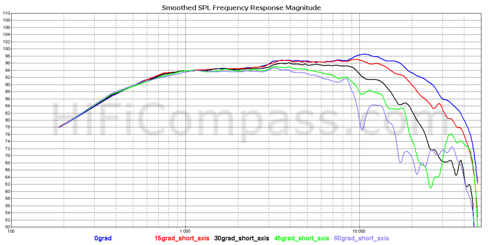

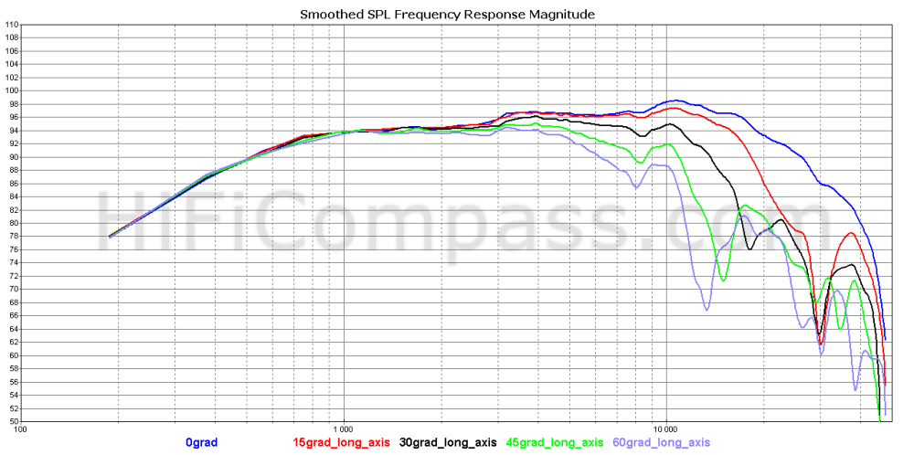

I second that as well the driver due to it's asymmetric diaphragm design ought to be rotated 90º into the position the designer intended them to be used primarily, although it's up to each ones freedom how to use them, the frequency dispersion response differs whether the D3404 is measured along the short or long plane.
Looking at Scanspeak D3404 datasheet one discovers they have provided measurements only for one plane, the short plane / horizontal axis, which is somewhat baffling and disappointing considering that it's a premium line product, thankfully HiFiCompass (D3404 article) have measured the driver in both planes, maybe that reflects your listening observations, it may be worth trying out rotating the driver to begin with.

long plane / vertical axis

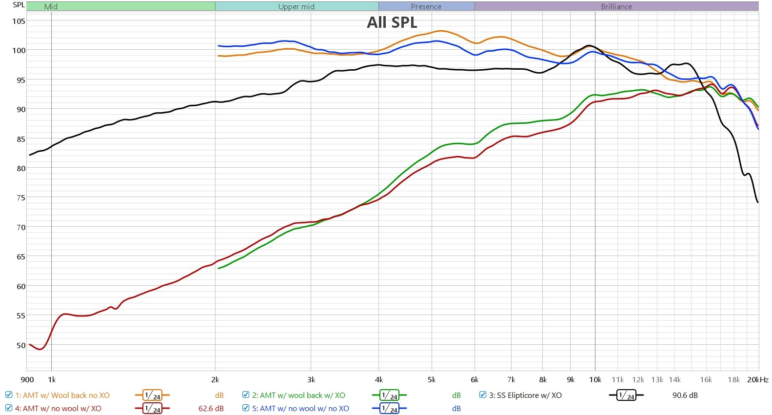

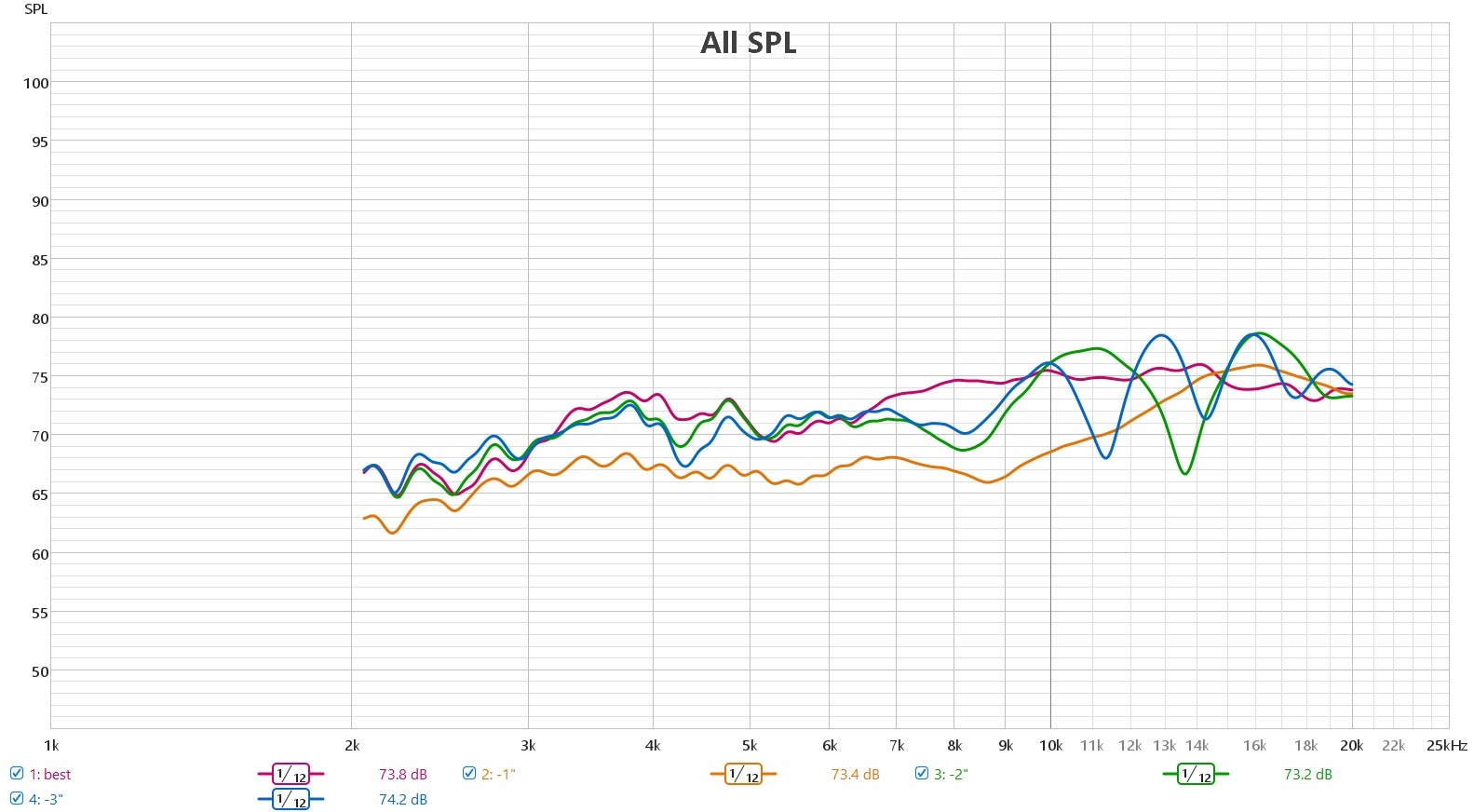

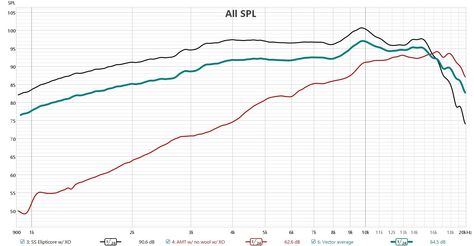

So this was eye opening. The tweeter test 1 graph shows the SS tweeter in black and the others are with the AMT. all individually close mic’d with a crossover and without and the wool backing on vs off. (Crossover by the way was second order 1.8 uf cap and a .05 mH inductor )The next graph shows the average vector of both in the impossible best case scenario. The third graph is together at 1m as a super tweeter configuration. With the “best” being right next to and somewhat overlapping. All the others are moving the AMT 1” back and away. The comb filtering was no surprise. It was what I was missing in the highs.
I currently have a 4 ohm r on the SS tweeter and a 3 ohm on the 4” mid and no pad on the AMT and that amt has a sensitivity of 95 and as you can see is not loud enough in that frequency. But I did do some listening with it added on the right speaker in the “best” location. At first I really didn’t hear anything until I listened to a track with an acoustic drum kit. The jangle interaction of high hats and shimmer off of symbol was immediately noticeable. I turned them on and off during a song and it was better on.
The eye opening part is I can’t go back to my SS tweeters and I can’t combine them into my speakers gracefully. I see a lot of Mundorf amts are 93 db sens which makes me wonder if that will work… I’m not there yet… but I am definitely changing this tweeter to something else. I like what it does do but I can’t live without real drums.
