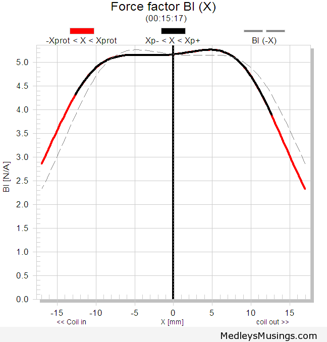

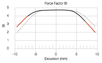

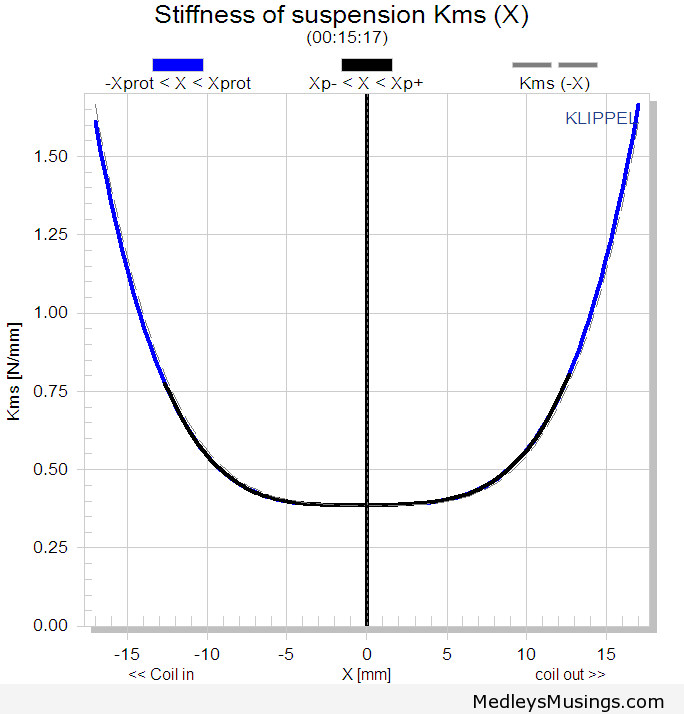

The 18WU is often called a midbass in the Car Audio world and excels as a 2-way mid. The reason why I linked it is because of the nice explanation from Geoff about driver designs that have a nice Bl plateau designed in their motor and also in the suspension. Both Illuminators share that type of design.
12MU:
Source: B&O Tech: Why select one driver over another? (Part 1) earfluff and eyecandy
18WU:
Bl curve
Suspension curve
Source: http://medleysmusings.com/ss18wu4741/
The reason for that is explained in the article I linked. It also explains the dedication of a firm like Scan Speak to put real meaning into terms like X-max!
I'm sure the Klippel site has even more background on that for those interested.

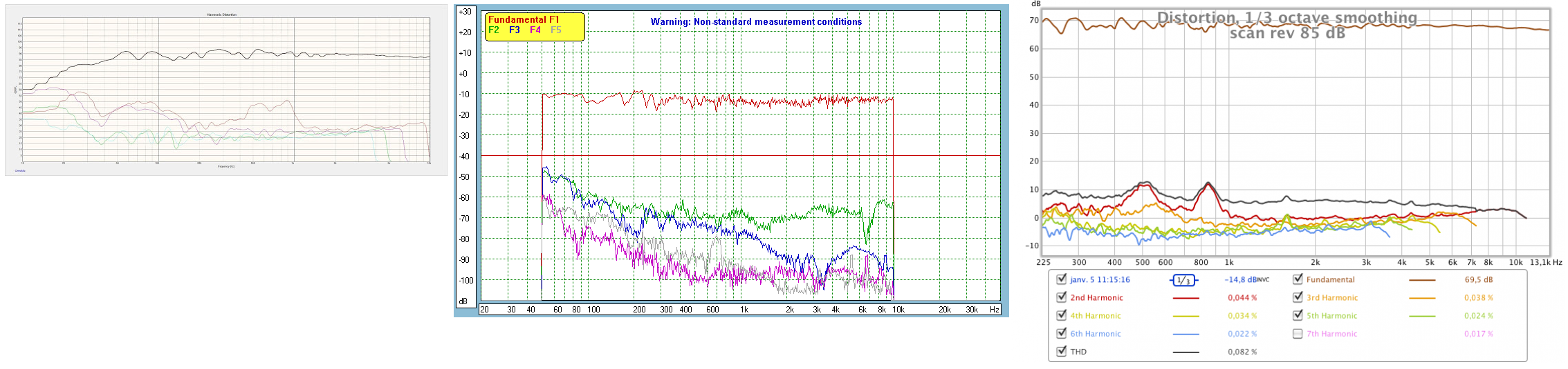

Hi Everyone,
When choosing between the 6.5" ScanSpeak Illuminator and Revelator I went with the Revelator in large part due to the comments Zaph made about the Revelator having lower distortion than the Illuminator.
Even though I wasn't really focused on measuring the Revelator, I did measure distortion recently, while doing more extensive measurements on a tweeter. One thing that came up was some distortion pops up in the upper end of the Revelators I wasn't expecting here, between 500Hz and 1kHz (ignore DB values!):
The same distortion shows up without a crossover by the way. Since Zaph clearly has a lot more experience I was tempted to discount my measurements until I saw the same distortion pop up in another measurement set. Thanks to a review by SoundStage Network and the National Research Council of Canada's measurements of a Wilson Sophia which includes the same driver:
Addmitedly, Zaph mentions not to use his measurements without duplicating his methods, but his old charts are perfectly flat distortion wise. I'm wondering if the Revelator has changed, or if Zaph's measurements somehow missed this, or if maybe he accidentally reversed the data for the Illuminator and Revelator?

Here are few links that have solid measurements of 18W/4531 and 18W/8531:
http://www.audiocomponents.nl/download/scan-speak/18W-4531G00 - Hobby HiFi 2003-3.pdf
http://www.audiocomponents.nl/download/scan-speak/18W-8531G00 - Hobby HiFi 2002-3.pdf
First thing i must say is that you have good measuring equipment 🙂
Second thing - i don't think that guys in Scan Speak worry that much about 2nd order HD. It is not yet proven that it is detectable and what levels of it are detectable while listening. Who determined 1% od total THD as the treshold of hearing it ? Floyd Toole mentiones more like 4% THD and that is highly dependant of which order of HD contributes the most to THD. Mainly it is considered that 3rd and 5th HD contributes the most to the unpleasant sound of the loudspeakers, and from what i can see from lots of measurements, they are exceptionally low in Revelator series. 2nd and 4th HD are marked like pleasant or undetectable by ear (at least at levels that they contribute to the overall sound that we find in modern loudspeakers).
Same goes for 15W/8530. Zaph too often states the importance of THD but then builds the loudspeaker ZD5 and comments it as:
"This is without a doubt the best sounding 5" 2-way I've designed. I won't be so bold and arrogant to say this is the best 5" 2-way in the world, but I will say that I've seen enough overpriced speakers that just don't sound as good as their price might suggest mainly due to under performing drivers and poor design decisions..... If you're after high performance music reproduction that is very uncolored and true to the original recording... and you have a few extra bucks to spend, you might consider this design."
These are the measurements of 15W:
http://www.audiocomponents.nl/download/scan-speak/15W-8530K00 - Hobby HiFi 2003-4.pdf
So, from all this i would conclude that you shouldn't worry much about THD as long the biggest component of it is 2nd HD and your 2nd HD being 1.5% and if your music sounds right 🙂
