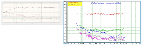

Hi Everyone,
When choosing between the 6.5" ScanSpeak Illuminator and Revelator I went with the Revelator in large part due to the comments Zaph made about the Revelator having lower distortion than the Illuminator.

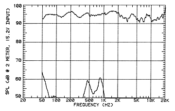

Even though I wasn't really focused on measuring the Revelator, I did measure distortion recently, while doing more extensive measurements on a tweeter. One thing that came up was some distortion pops up in the upper end of the Revelators I wasn't expecting here, between 500Hz and 1kHz (ignore DB values!):
The same distortion shows up without a crossover by the way. Since Zaph clearly has a lot more experience I was tempted to discount my measurements until I saw the same distortion pop up in another measurement set. Thanks to a review by SoundStage Network and the National Research Council of Canada's measurements of a Wilson Sophia which includes the same driver:
Addmitedly, Zaph mentions not to use his measurements without duplicating his methods, but his old charts are perfectly flat distortion wise. I'm wondering if the Revelator has changed, or if Zaph's measurements somehow missed this, or if maybe he accidentally reversed the data for the Illuminator and Revelator?
Has anyone had a chance to measured the ScanSpeak 6.5 Illuminator and/or Revelators for distortion recently?

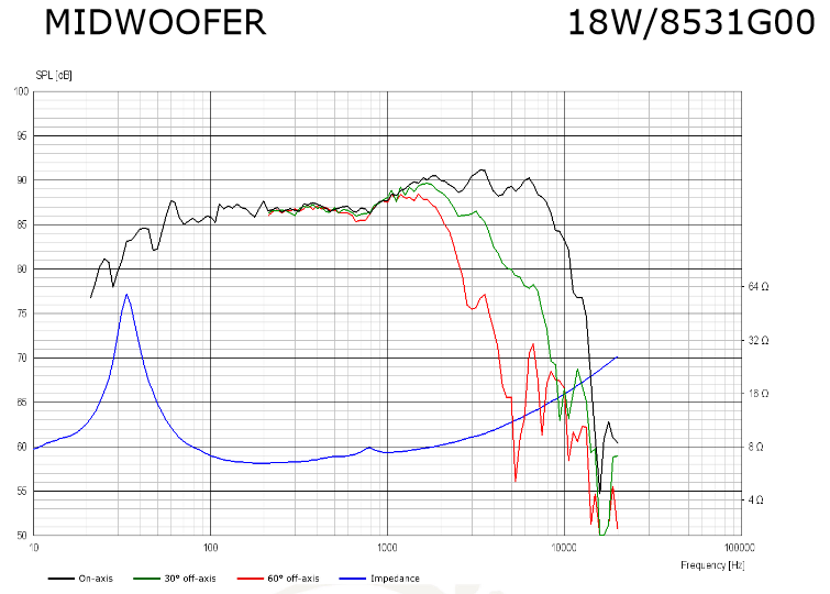

I'm not sure where the problem is? That 500-1000Hz issue is doubtless the rubber surround edge reflection. Quite characteristic of ALL woofers. You can even see it in the impedance. Broadly speaking you can have foam surrounds, lossy rubber and corrugated paper all with different nodes and antinodes at the edge. The edge resonance is where the response usually bends and dips. Changing the surround material can alter the lossiness.
And then the 4-5kHz peak cone characteristic of all 6" drivers, being a half-wavelength thing, which shows in phase and Frequency Response.
http://www.scan-speak.dk/datasheet/pdf/18w-8531g00.pdf
Klippel publish some great datasheets. It's a complex business balancing all the damping, mass and rigidity trade-offs. Even weird stuff like rocking modes crop up.

Thanks Steve!!
The only problem is that it's not in Zaph's measurements, and I was hoping to get a better handle on the $100 more expensive ScanSpeak Illuminator 18WU/8741T-00 in terms of distortion or power output. I mean, the Dane's are not stupid, I can't believe it's $100 just for having a prettier motor structure.
I think part of what brought this up too was that RAAL was commenting on it appearing to be unusually high.
Maybe this is in fact exactly how a Revelator should look like, and the Illuminator is worse, I just cant' see it. 🙂

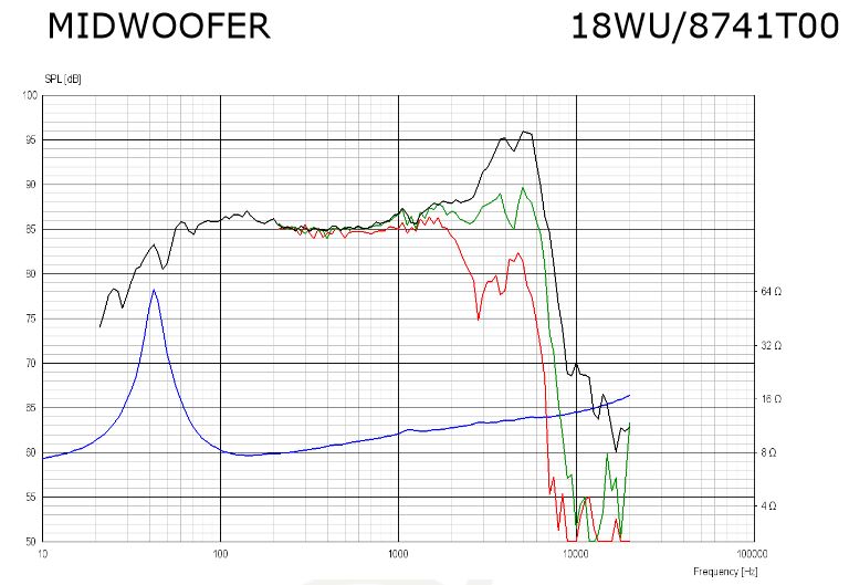

Such different animals! Here's the pricier Illuminator.
http://www.scan-speak.dk/datasheet/pdf/18wu-8741t00.pdf
Don't fancy that one at all. Even if it's made of unobtanium. 😕

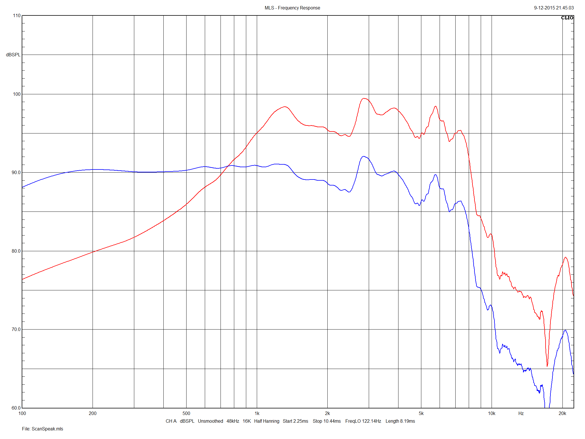

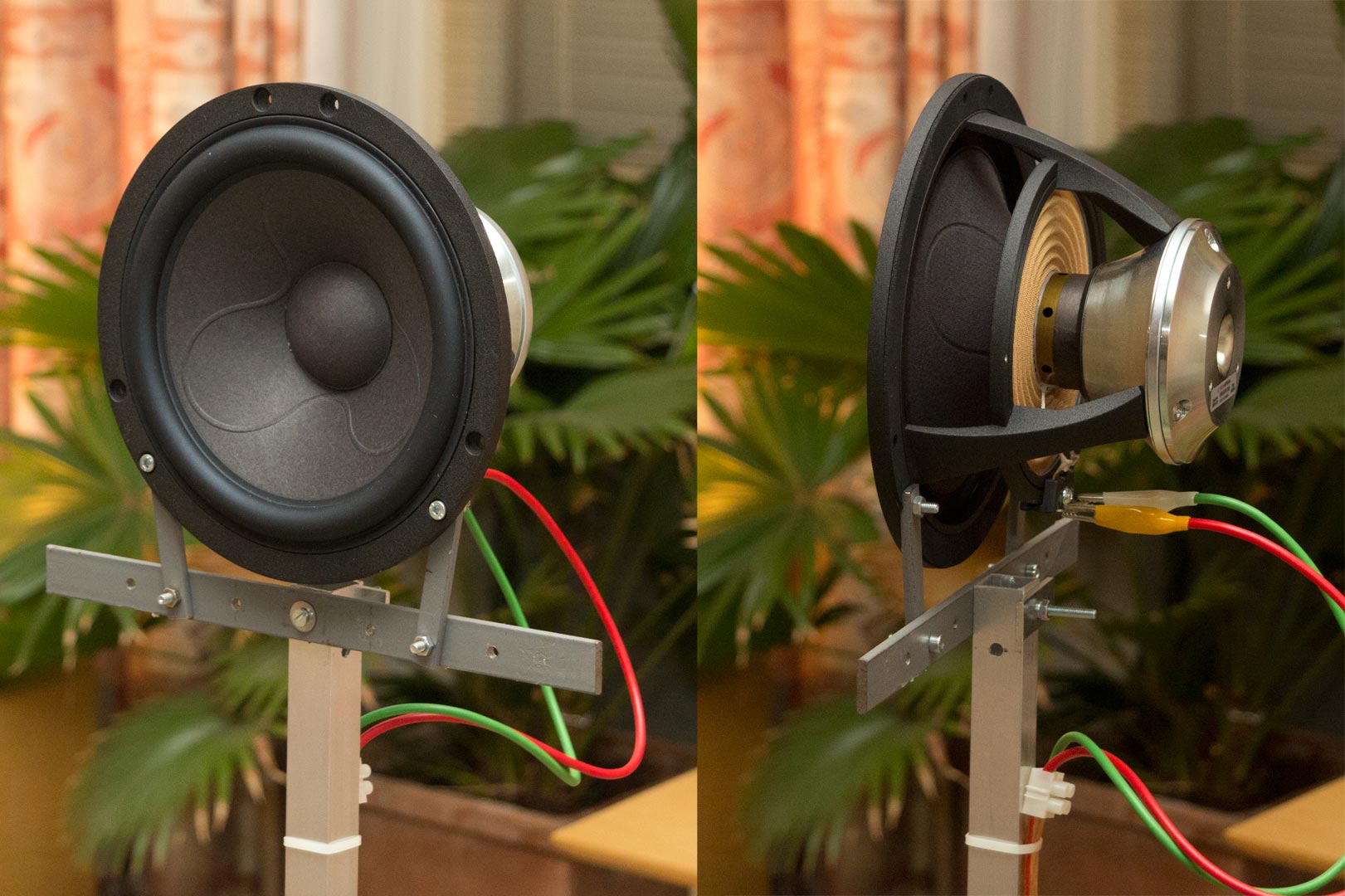

Here're some measurements of the Illuminator as a dipole:
The response @50cm (red) compared to the response with some DSP applied (blue)
The response @50cm with some more DSP effort:

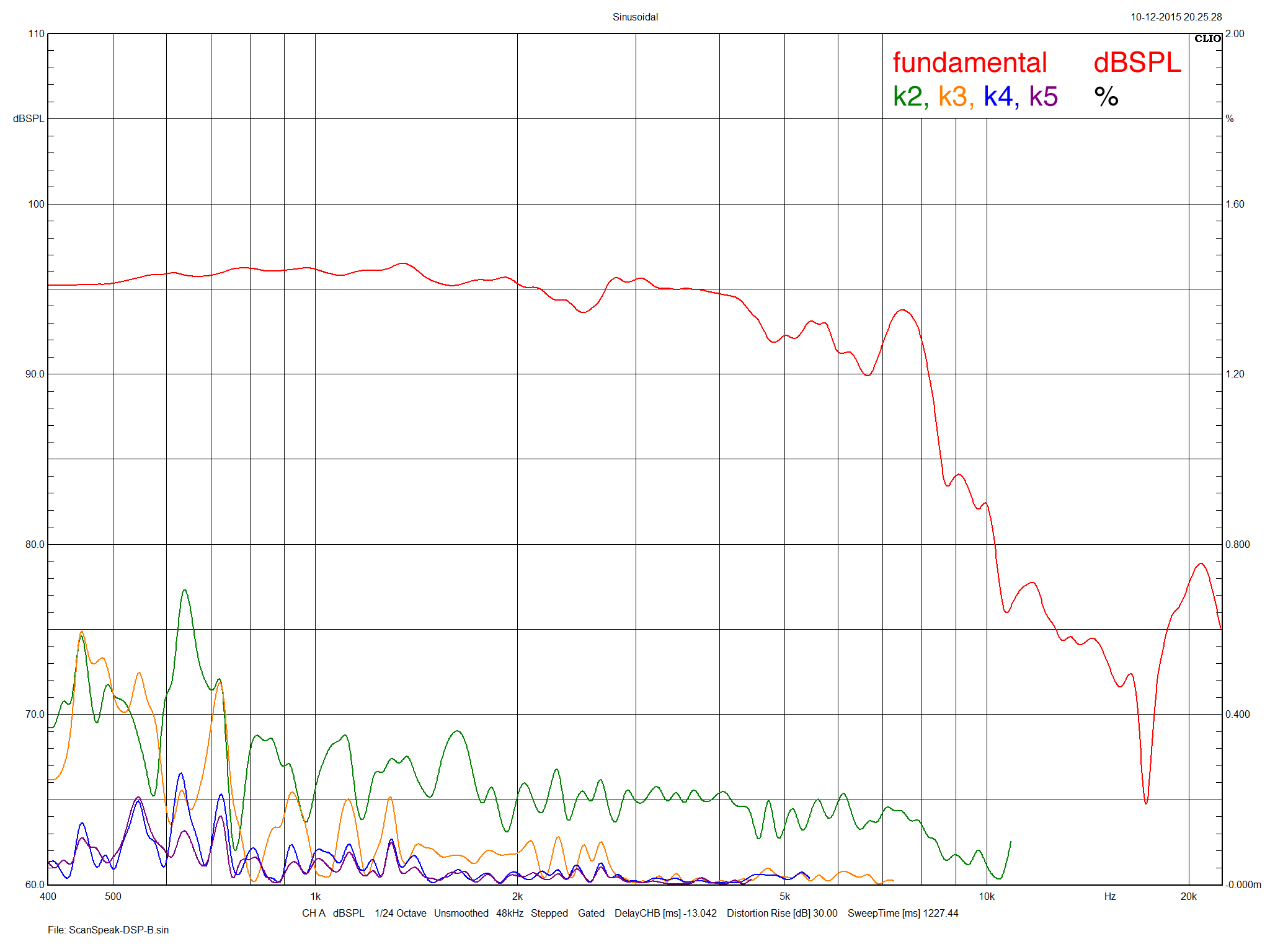

Harmonic distortion @50cm (95dBSPL):
Remember that significant dipole correction has been applied.

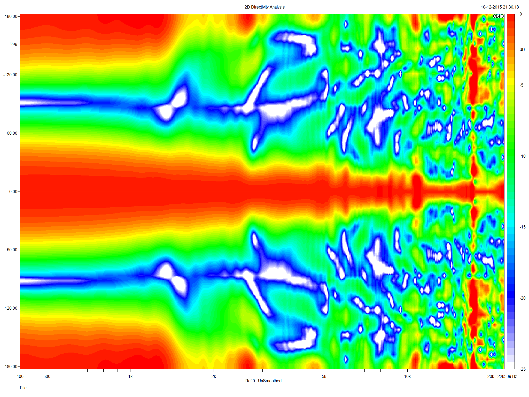

Normalised directivity @50cm:
Directivity was measured from 0 to 180 degrees in 5 degree steps and then mirrored for a 360 degree view.

OK so I'm not measuring now. These are old traces so sorry for relatively low SPL. This one was done on axis with a crappy (above 12kHz) Behringer mic at 2 ft from the Illuminator. Signal is via my active crossover (ESP P09s without baffle step comp. filter added at that stage) with tweeter and bass amps switched off, so it's showing the LR24 roll-offs (-6dB points are 150Hz and 2.2kHz), cursor at 1kHz. Power amp is ESP P101:
Speaker:
32mm MDF, tapered (triangular x-section) internal midrange enclosure stuffed with long fibre wool about 12 or 13 litres from memory (anyway whatever WinISD said to use for .707 max flat amplitude response).
Speaker:
