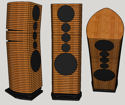

Designing a passive crossover seemed a bit too daunting so I decided to go with an active crossover and make use of a miniDSP 10x4 HD.
Sketchup design
Google Photos
What's the curve for? Aesthetics?
EDIT: The last one looked great by the way, I'm certainly not knocking your aesthetic decisions!
The only acoustic reason I can think of for including the curve is that you may have simulated the pattern of the lobes you'll get, and seen that the pattern will be improved by the banana shape.
Given that you plan to use a DSP, you could probably simplify your build by removing the curve / tilt (unless it is there for aesthetics). Some builds use tilted / stepped / odd baffles for time alignment, but you can handle that digitally.

Yes, I thought it breaks it up a bit, otherwise it is a very large singular box. I have designed it so that from my seat each 12MU is exactly the same distance from my ear. I like the look of the Focals which have a similar shape (e.g. the Grand Utopia) so based on that concept.What's the curve for? Aesthetics?

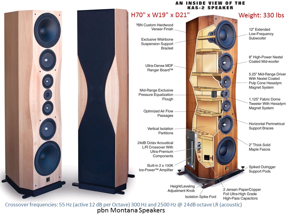

I often wonder where his designs would be today given where technology and DSP are at now. Mike.
The engineers at pbn Montana Speakers and Rockport Speakers have advanced the Dunlavy philosophy and tech.
-improved construction materials
-reduced cabinet diffraction
-improved polar response from shorter C-to-C distances
-physical and crossover changes to improve time alignment and phase
-room equalization for bass
-lower distortion
-higher max + transient SPL

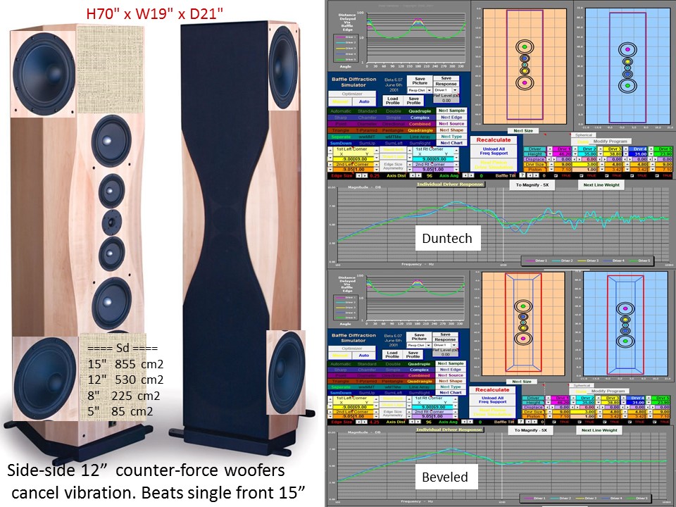

Over this weekend I (almost) finished a side-side counter-force woofer cabinet with front-rear ports using two AES TD15S woofers, and was amazed at how little vibration remained.They are a great set of articles by John. Very sadly missed. I often wonder where his designs would be today given where technology and DSP are at now. Mike.
If you dream about building a BIG Duntech WMTMW topology speaker, give some consideration toward two 12" side-side counter-force woofers instead of one front facing 15. Baffle simulations continue to support using deep shaped edge bevels like the pbn Montana.
