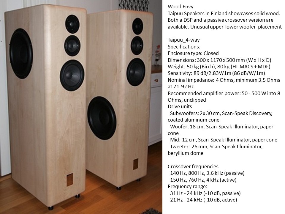

Wood EnvyI’m curious to see how the 12mu and tweeter work. I’m thinking of using those same drivers but only one 4”. I like the design.
You might get ideas from: Taipuu Speakers in Finland builds a ScanSpeak 4-way design which showcases solid wood. Both a DSP and a passive crossover version are available. Unusual upper-lower placement of side-side 30 cm Scan-Speak woofers. Measurements at:
Taipuu Speakers
Taipuu_4-way
Specifications:
Enclosure type: Closed
Dimensions: 300 x 1170 x 500 mm (W x H x D)
Weight: 50 kg (Birch), 80 kg (HI-MACS + MDF)
Sensitivity: 89 dB/2.83V/1m (86 dB/W/1m)
Nominal impedance: 4 Ohms, minimum 3.5 Ohms at 71-92 Hz
Recommended amplifier power: 50 - 500 W into 8 Ohms, unclipped
Drive units
Subwoofers: 2x 30 cm, Scan-Speak Discovery, coated aluminum cone
Woofer: 18 cm, Scan-Speak Illuminator, paper cone
Mid: 12 cm, Scan-Speak Illuminator, paper cone
Tweeter: 26 mm, Scan-Speak Illuminator, beryllium dome
Crossover frequencies
140 Hz, 800 Hz, 3.6 kHz (passive)
150 Hz, 760 Hz, 4 kHz (active)
Frequency range:
31 Hz - 24 kHz (-10 dB, passive)
21 Hz - 24 kHz (-10 dB, active)
I agonised over that decision for ages, and decided to play it safe and stick with Scanspeaks.
They have been ordered now, and are on there way around the world from Europe, so decision made.
From what I have read on the D2904 Be dome it is an excellent tweeter, so can't imagine I will be disappointed, but then there is always that feeling of 'what if...' . That is part of what keeps you coming back for more I guess...
Yeah, as I said a dome tweeter might have more meat to it in upper midrange. Just don't use one as a midrange down to 1600 Hz, like in the Arendahl 1723 THX, that a friend bought.. It pairs a large dome tweeter with two 8" with strong midbass and the midrange is either strained or scooped and the top end has a bit of distortion.
Nothing is preventing you from getting a smaller Raal as a super tweeter later on.
Wow they cross the 12MU very high. Very nice looking speakers
