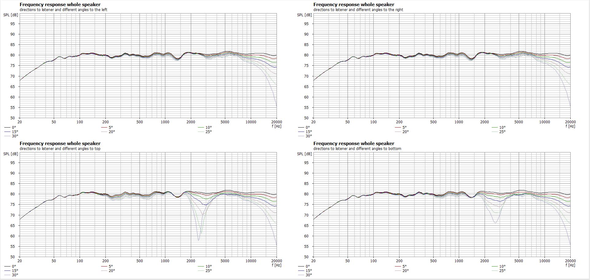

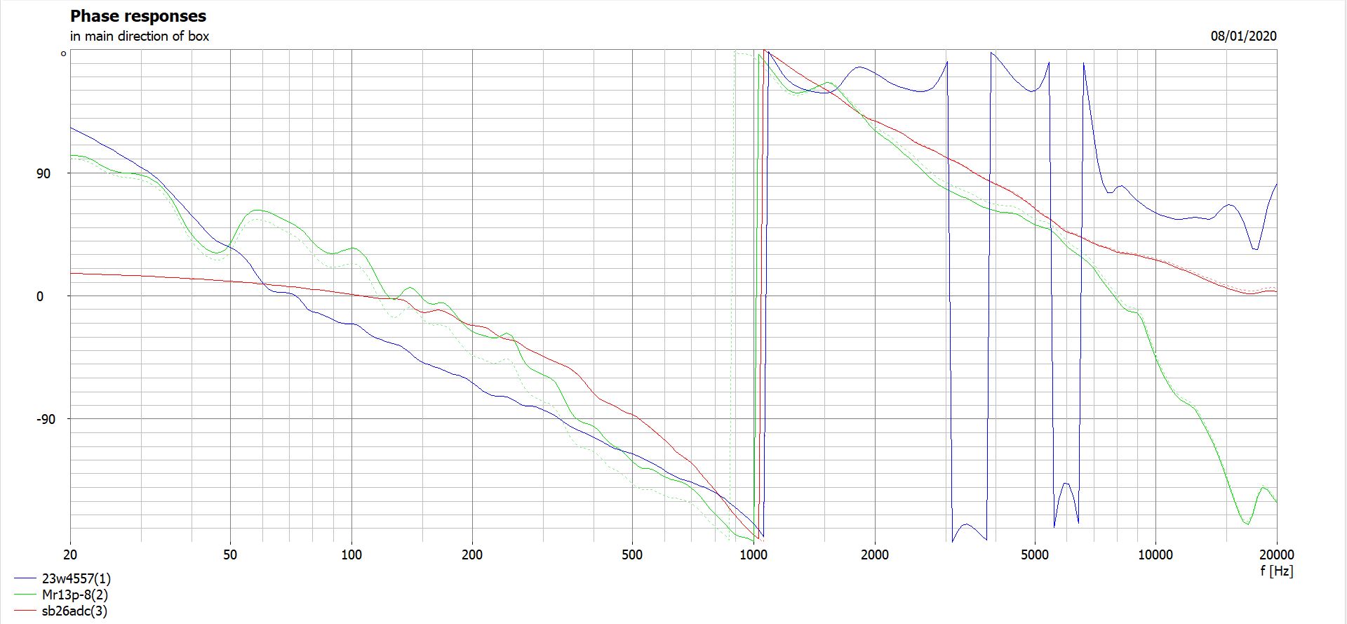

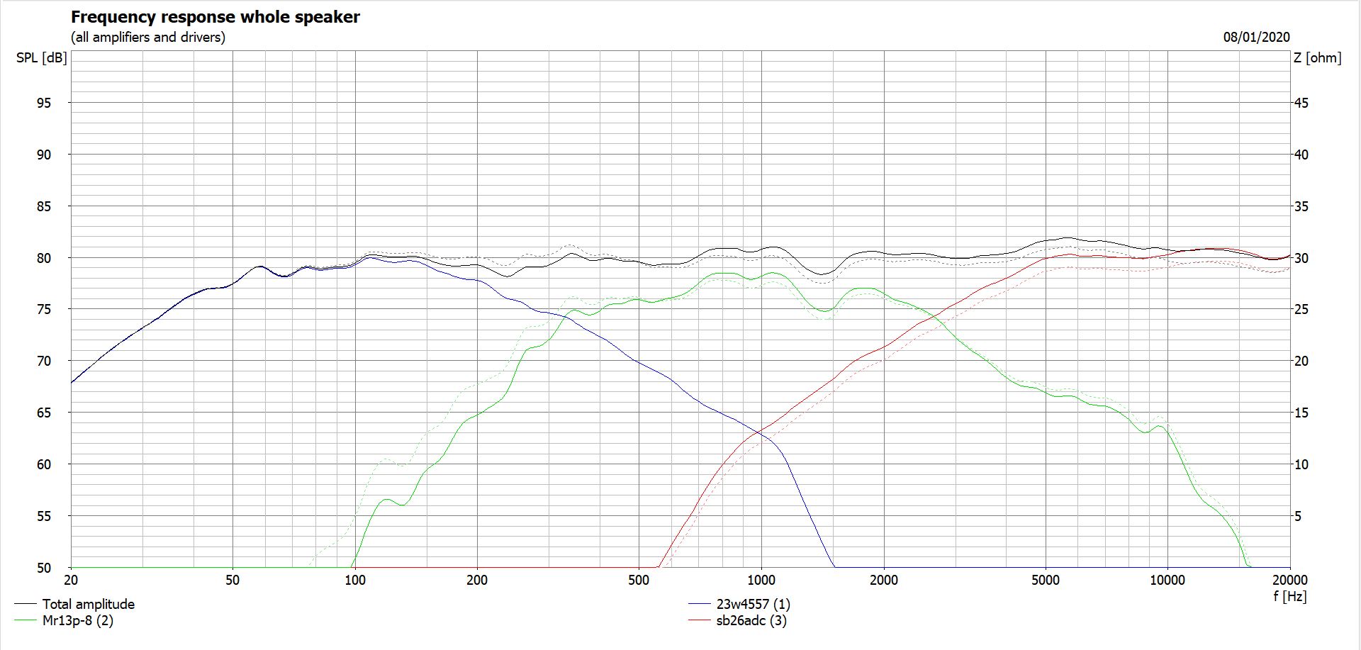

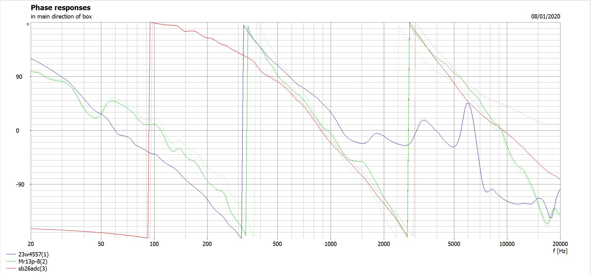

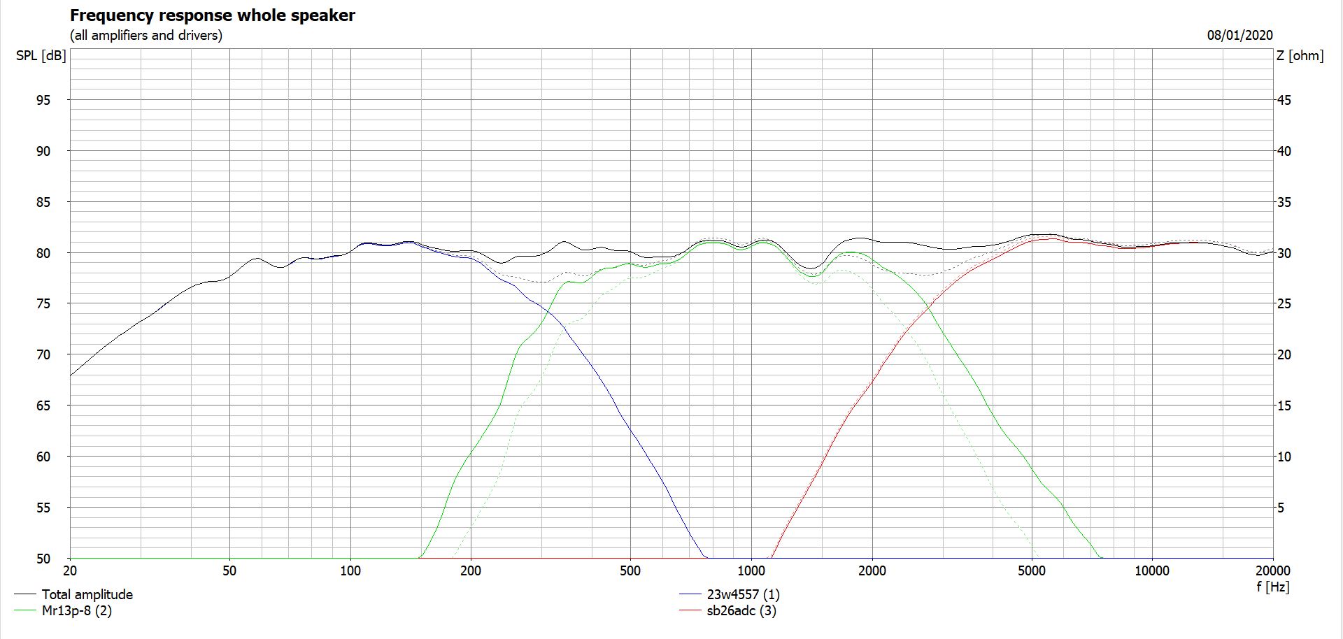

So here's a few sims, thoughts please.
1) WINISD comparison of 23W Closed in 28l Qtc = .76 9 (Blue) vs 22W BR in 42l tuned to 28hz (Green) - 23W Closed looks very good and needs no low roll of at 60W (power of my amp, too small but Ok for a start), 22W needs a 2nd order highpass at 25hz to keep it under xmax plus a 3inch port to keep velocity below 20m/s.
2) Boxsim 2.0 active sims for 23W closed LR2 and LR4 for comparison with SB MR13P-8 and SB 26ADC.
Baffle 95x30cm - 23W @ 53cm, 13P @ 73cm, 26ADC @ 86cm all on centreline i.e. small floor stander that may have a divider half way up to produce 28L bass cavity.
23W - 28L moderate stuffing, simmed with 2xFs upwards (hence smooth bass roll off), xover at 300hz
13P - 3lL moderate stuffing, xover set using optimiser - LR2 = 425/1900, LR4 = 330/2440hz
26ADC - 2700hz crossover
(All data from datasheets using Vituix cad trace)
Only other controls are delays set on 13P and 26ADC with optimiser, no smoothing using parametric filters i.e. 13P surround 1500hz wiggle is still there.
Graphs show individual frequency response/crossover, off axis spread 0-30 degs, phase.
All comments/observations welcome.
Edit - just noticed that in the WinISD plot I have incorrectly labeled (22W4557) the 23W4457, just to confirm the Blue line is the 23W4557 in a 28L sealed box, the green line 22W BR is the 22W8857 in a 42l Vented box.

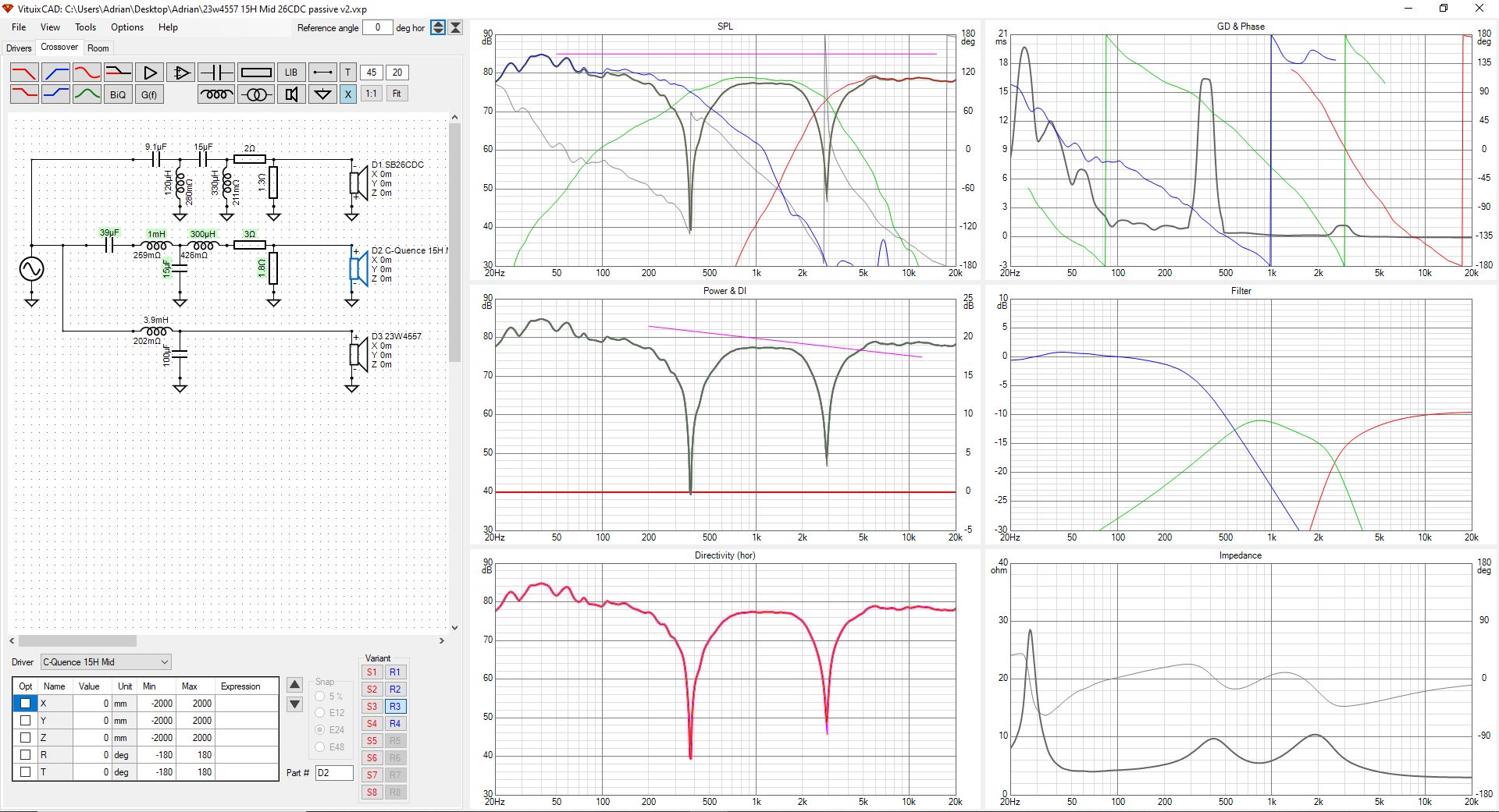

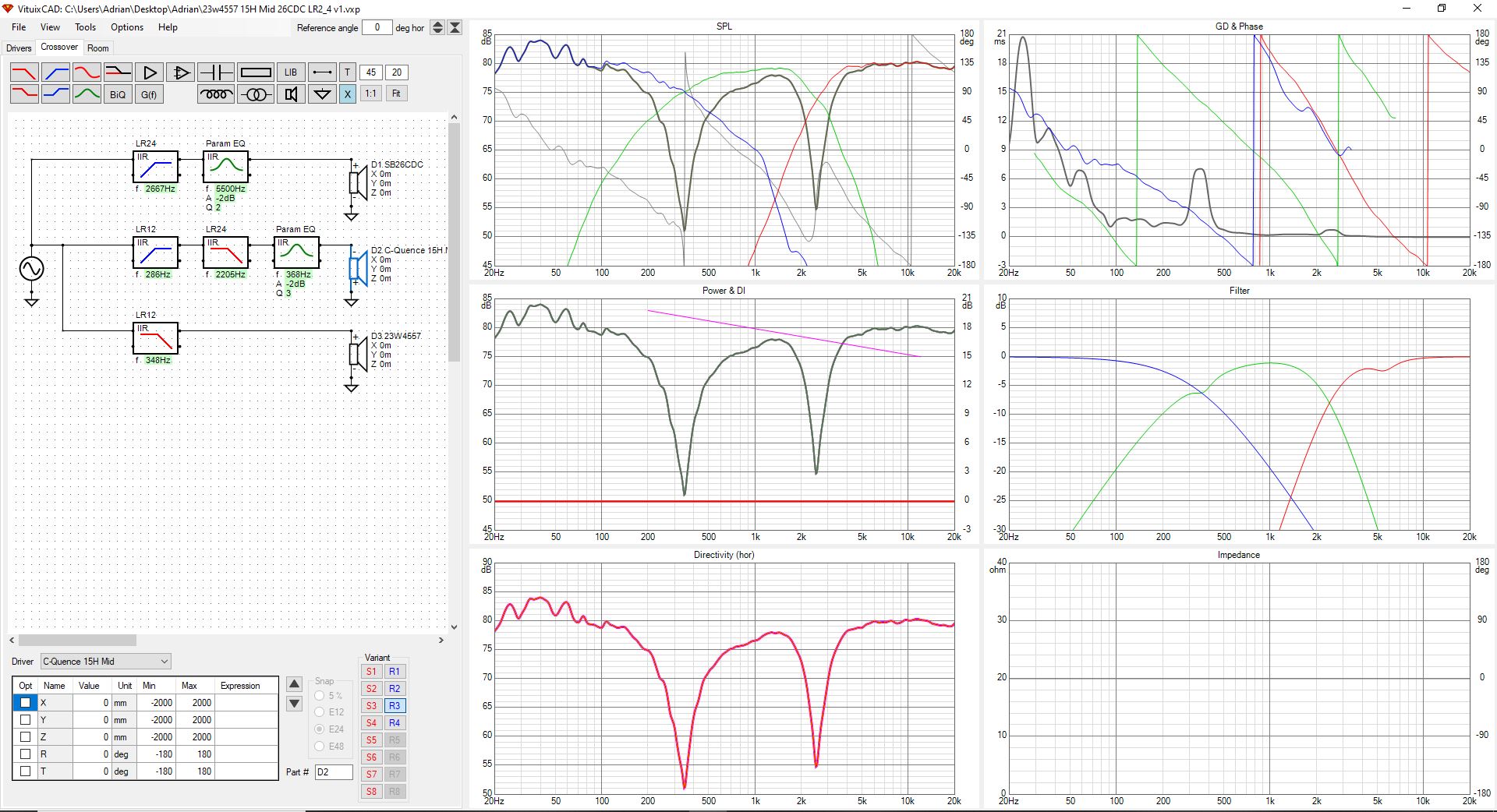

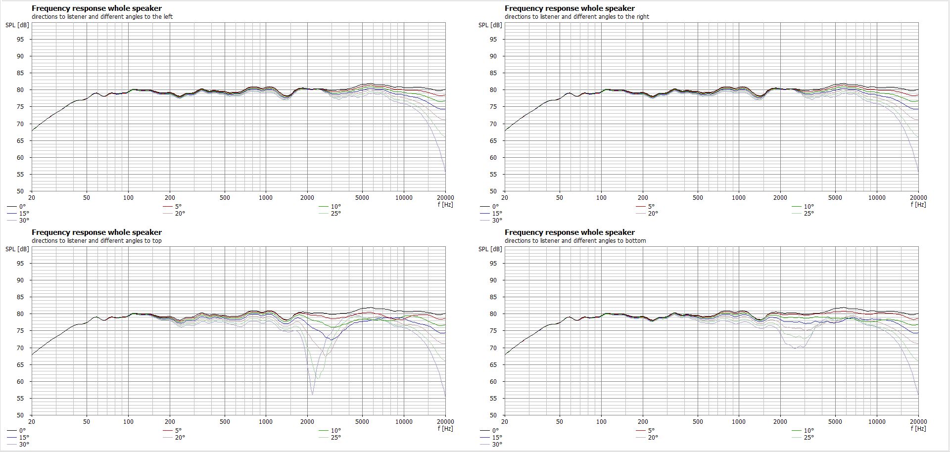

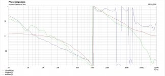

Quick update -

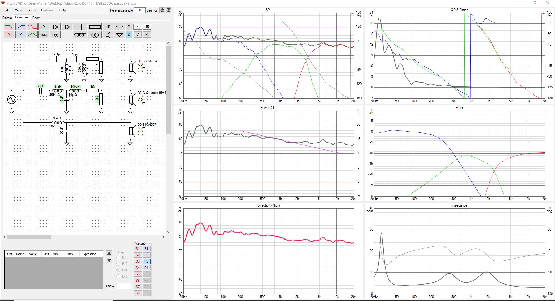

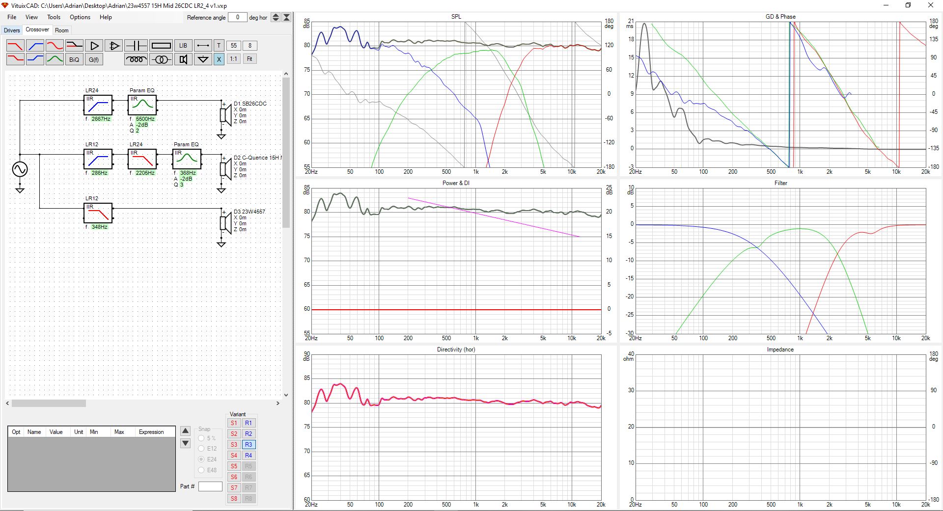

Over the past few days I have been trying to learn VituixCad, find a better mid driver and learn the basics of what to optimise in a crossover.
I think I have got to grips with the passive and active model in VituixCad and can replicate results in Boxsim 2.0 which give some confidence that the two modelling systems are doing their stuff correctly.
The search for better mids turned up the Audio technology 15H Midrange driver (C-Quenze 15 H 52 12 06 SDKM) which, although expensive seems to be very easy to work with. In terms of modelling (taking into account I am using traced curves from OEM datasheets) the process I used was -
I have added plots below for both passive and active, normal and inverted mid using approximately the same crossover points/ note to get the phase to work on the active I added delays to the drivers, passive version this is all done in the crososover.
Anyway, from the plots it looks like the 23W4457, C-Quence 15H Mid and SB26CDC play very nicely together with pretty simple LR2 (W/M) and LR4 (M/T) crossovers with LPads to get the sensitivities down to the woofer (admittedly low). Ok, these drivers come at a price but looks like they could make a pretty good system.
One final questions, does box shape matter (within reason) for a sealed woofer.
i.e. fro an internal volume of 35l using 20mm birchply (excluding driver, mid cavity and bracing for this illustration) will there be a difference between -
Thanks in advance of further comments, much appreciated.
- Produced initial crossovers that provided a fairly flat frequency plot,
- Inverted Mid,
- Moved crossover point until I had two healthy nulls (-30dB),
- Then optimised the crossovers so that on the phase plot, around the frequency that the woofer/mid and mid/tweeter crossed over, the graphs were coincident.

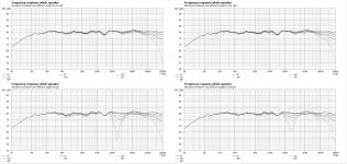

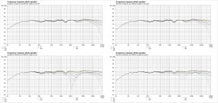

- Stand mount 29cm baffle, 60cm high by 29cm deep,
- Floor stander 29cm baffle, 100cm high and 18.5cm deep ?
Don't forget directivity! 🙂
At around 500 Hz this driver becomes directional, as evidenced by the off-axis FR.
So, yeah, 300-500Hz is probably a good "sweet spot" to stop at.
@eriksquires. Many thanks for the comment, and I agree with the breakup and tried to keep it at about half the frequency of the 3dB 30deg point (around 1.1khz).
However, my only worry is the big difference in sensitivity between the woofer (82dB) and the mid (91dB) which pulls the overall sensitivity down to around 80dB. I understand that low sensitivity speakers can sound dull at low levels, this may be misinformation, but most of my listening will be at low to mid levels (very rarely crank it up loud) so would not want to fall fowl of this.
If this is the case then I may be better reverting to the SS 22W8857 or SB WO24P bass reflex which would, push this up around 85-87 dB.
Anyone deny/confirm the sensitivity worries.

Yes, go active with this driver. You could do a passive mid-tweeter, those are great drivers.
