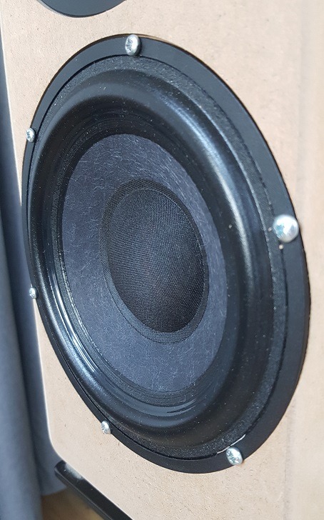

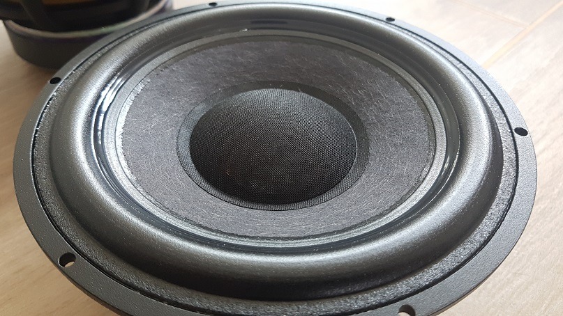

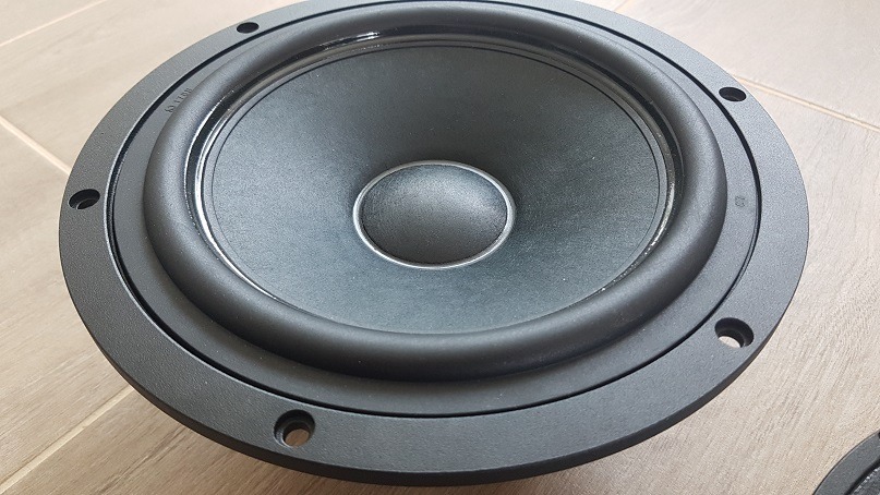

I will start with Punktkilde, this 8" driver models well in 30-40 BR alignment. All looked good in the datasheet, low Le suggested this driver got good features, and the price was ok. I was surprised holding the drivers in my hands and seeing cone edge treatment, this was not visible in product photos. Basket looks identical to WF223BD, surround material is foamed rubber, similar to Seas or Dayton RS midwoofers. Cone material and the collor reminds me WF182BD09. Overall the build quality is great and I like neutral look of this driver so it easy to combine it with other drivers, in my case 12MU.
18W/8542-10 looks great as well, cone edge treatment is clearly visible, and all measurements I have seen (not much info is generally available for this driver) looked perfect. Whole rear side of the cone is treated with partially sticky lacquer. All of this promise excellent midrange qualities.

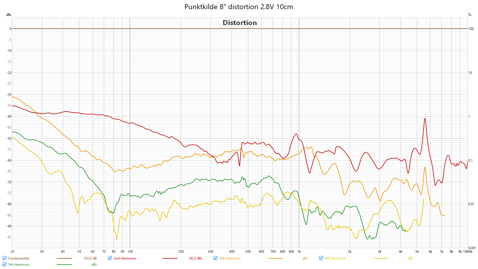

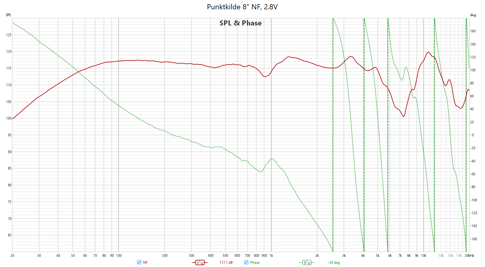

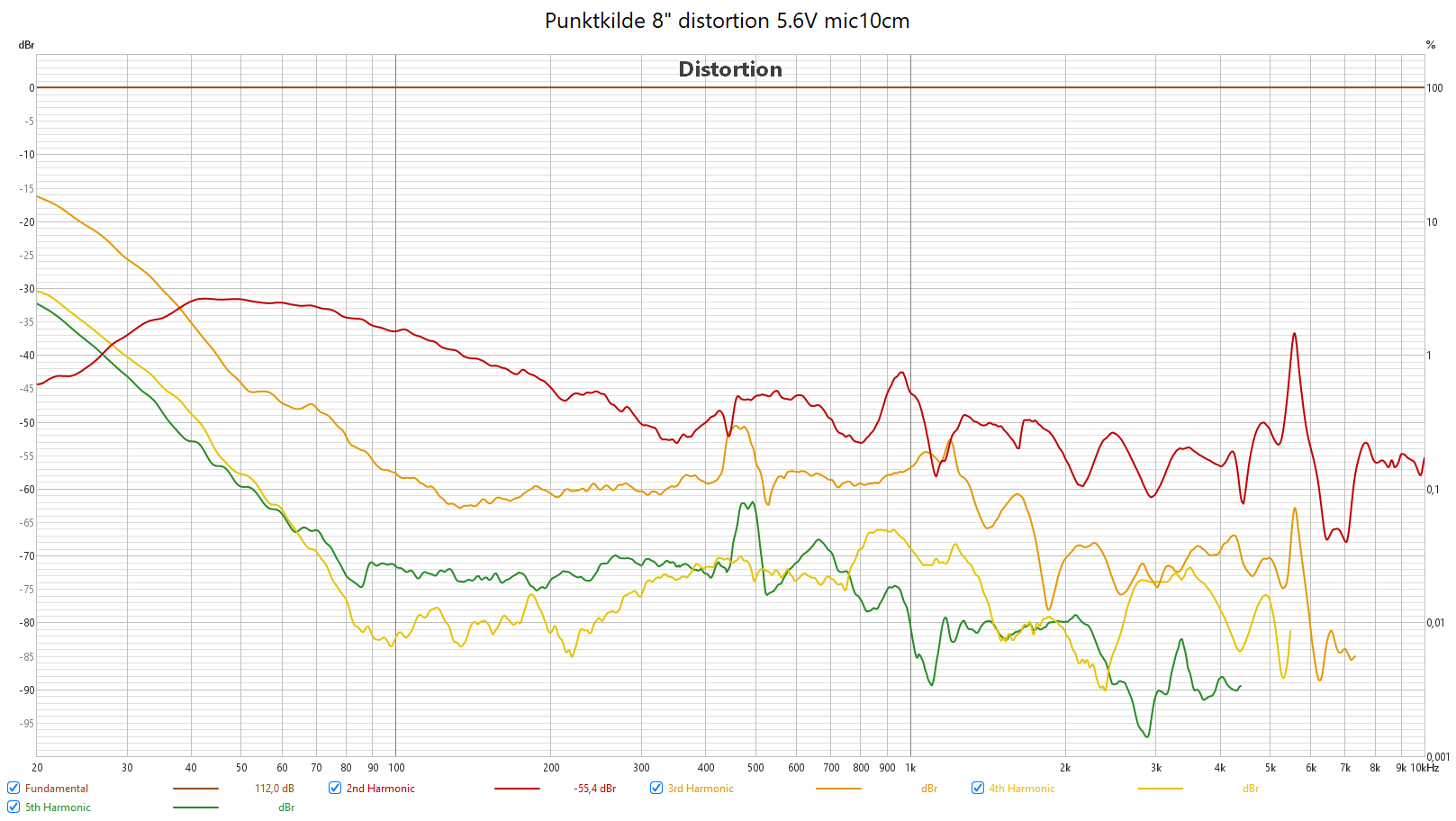

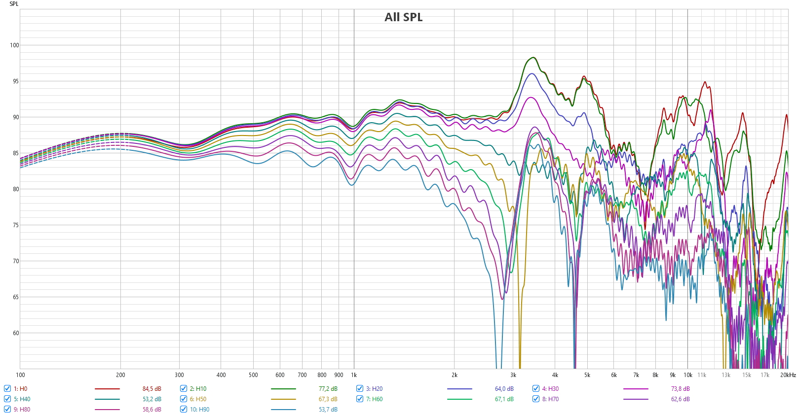

So I did FR and distortion measurements for Puktkilde:
  • SPL calibrated
  • FR 0-90deg horizontals,
  • distortion 2.8V and 5.6V
  • NF 1cm

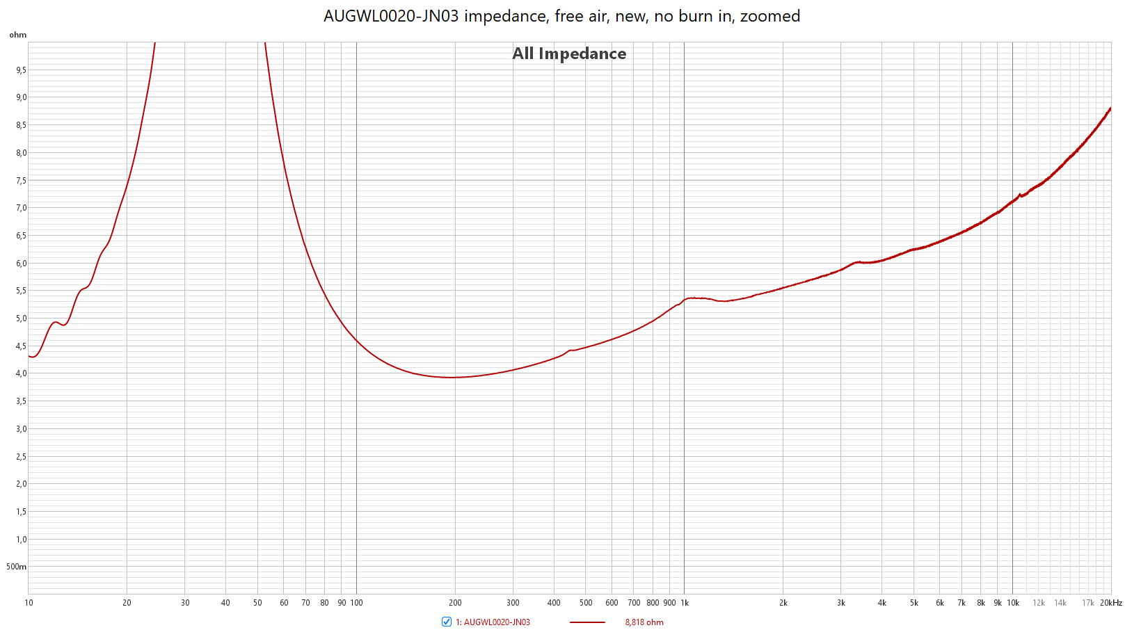

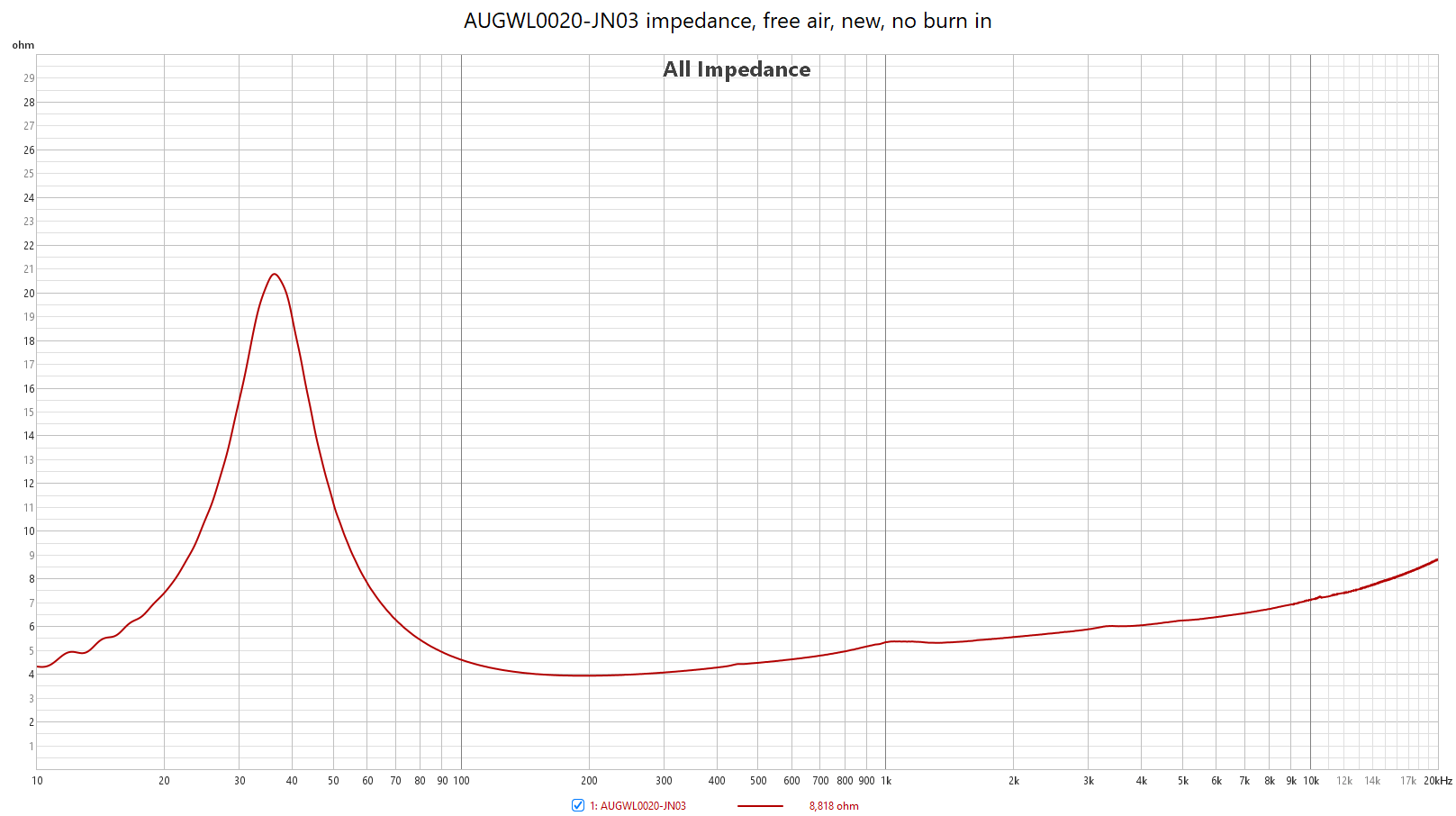

And impedance measurements, free air, no burn in.
To offer also another view on measured FR, I attached ungated measurements, just 1/12 smoothing.

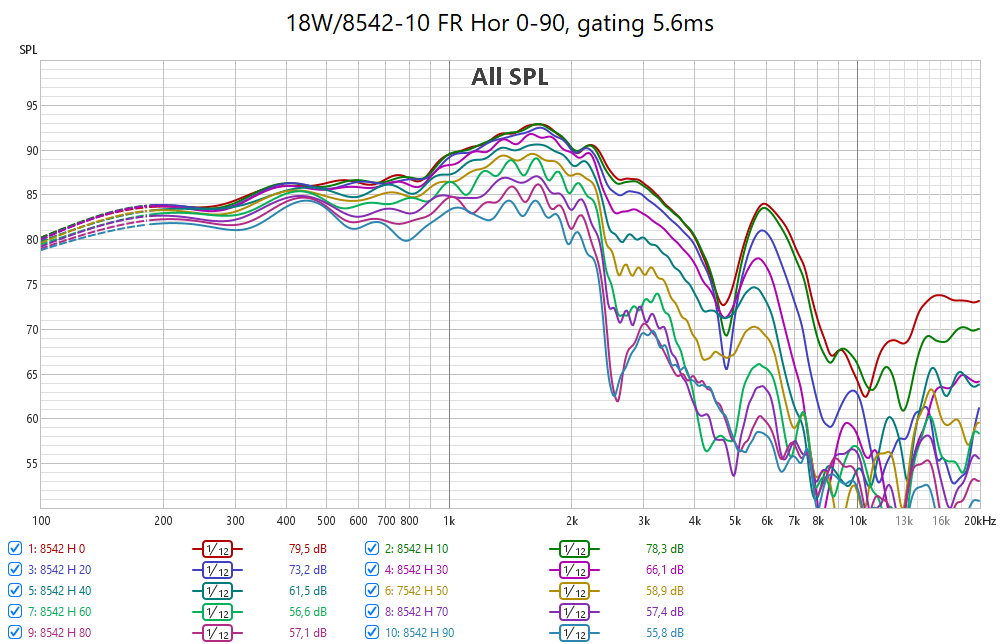

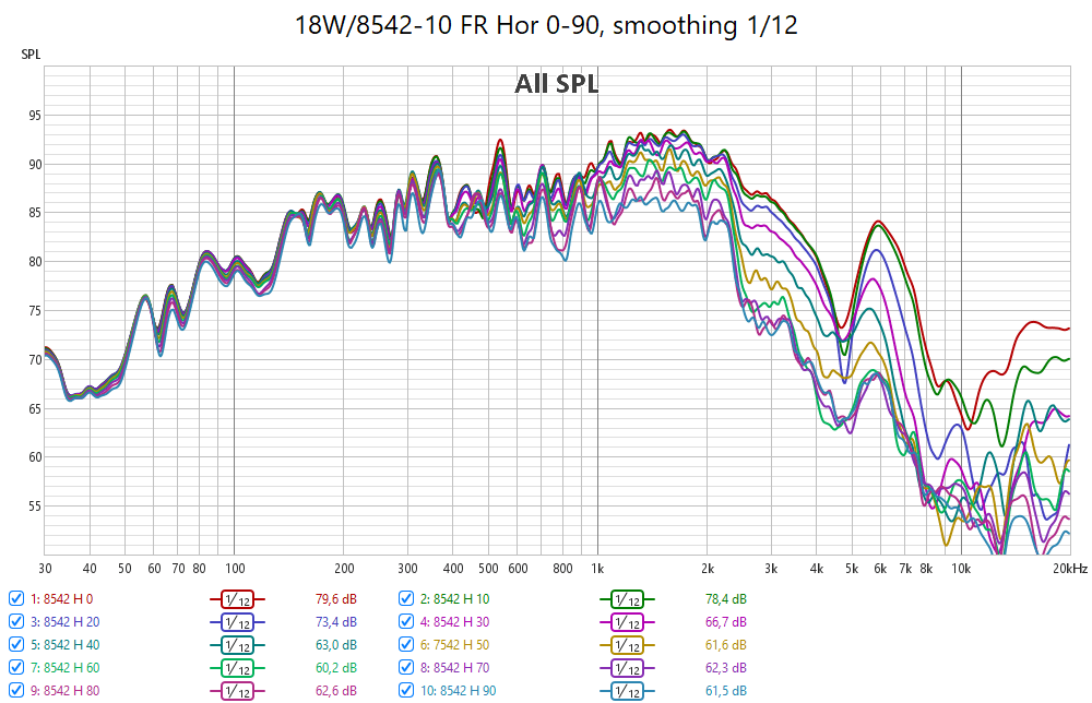

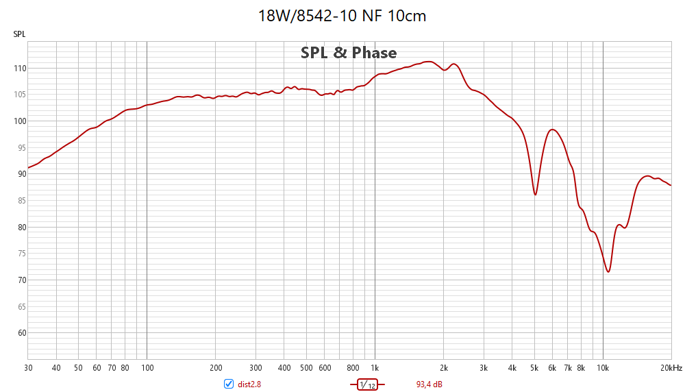

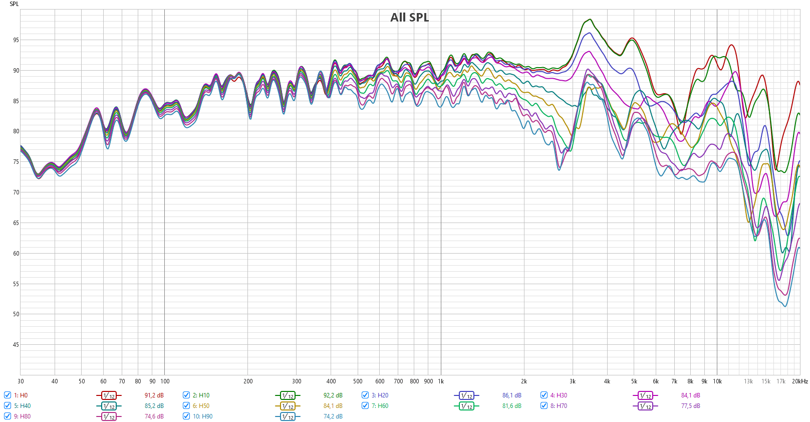

18W/8542-10 measurements (SPL cal, referenced to 1m, 2.83V):
NF - this is very nice, no signs of any issues in the passband up to ~3k
FR 0-90deg - very consistent off axis responses, low directivity. The shape of the response is given by very narrow cabinet which shifts the bafflestep closer to 1k.

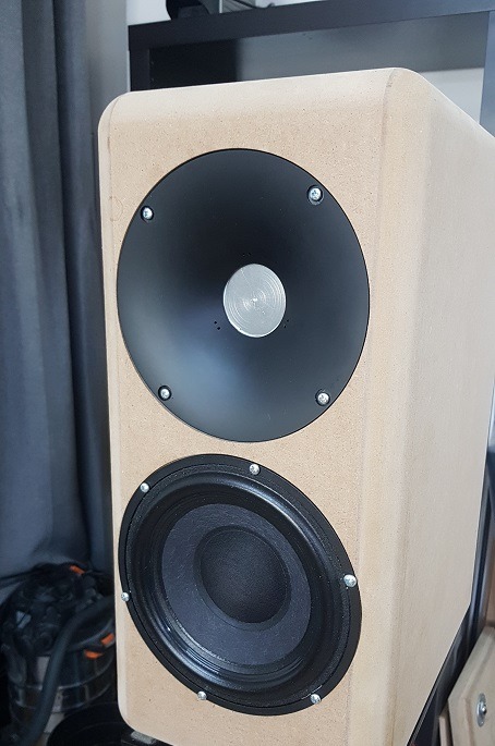

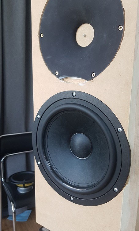

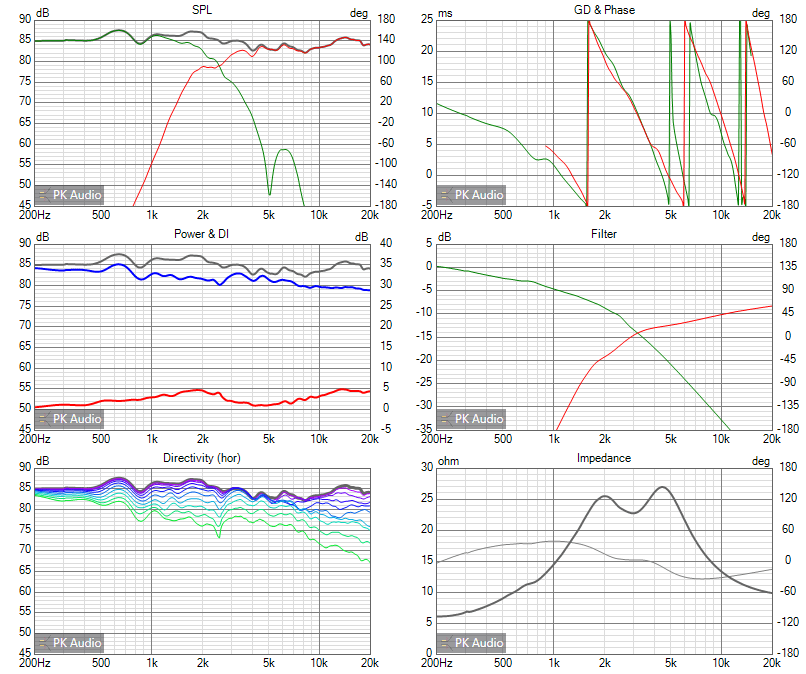

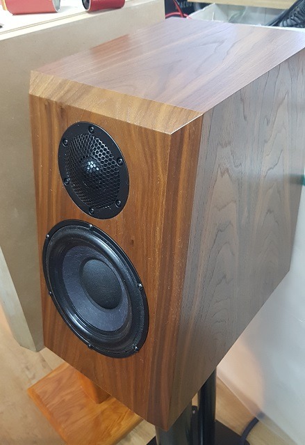

Ok so finally some listening experience with 8542-10. This weekend I measured, modelled and wired the crossover and give it the listening.
As I had cabinets around, with 104mm opening for the tweeter, I decided to try T34A, based on the experience with 9800 which I liked a lot.
As always it took first hour for drivers to burn in, though basic character was already obvious. Initially I started with whole area >3kHz lower by 1dB compared to v5 sixpack, but this sounded little dark and bass heavy. So I lifted the area by 1dB. This already started to sound very good.
Initially wide directivity of T34A was a concern with regard to baffle edges and diffractions. It is clear T34A would deserve better optimized baffle, but it is not terrible either.
