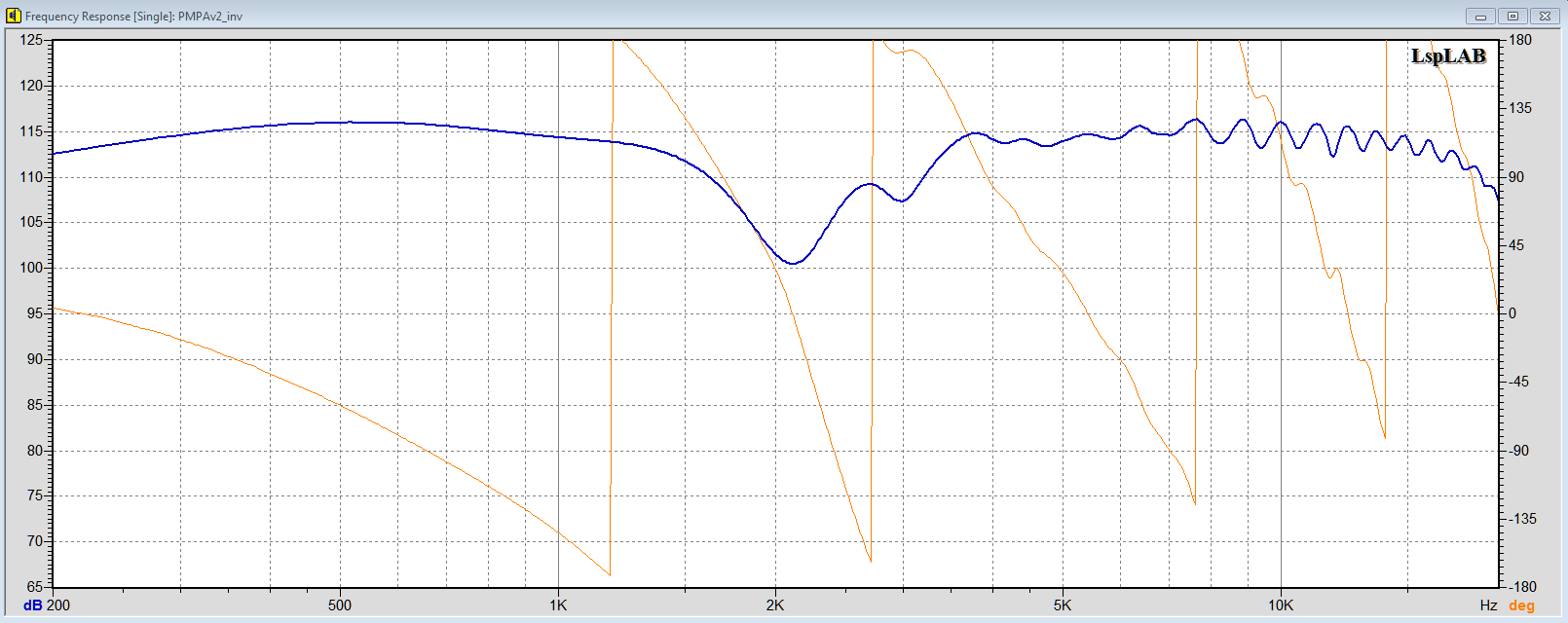

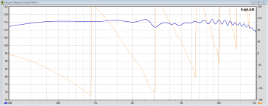

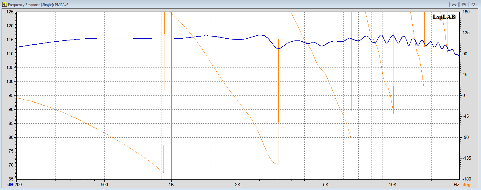

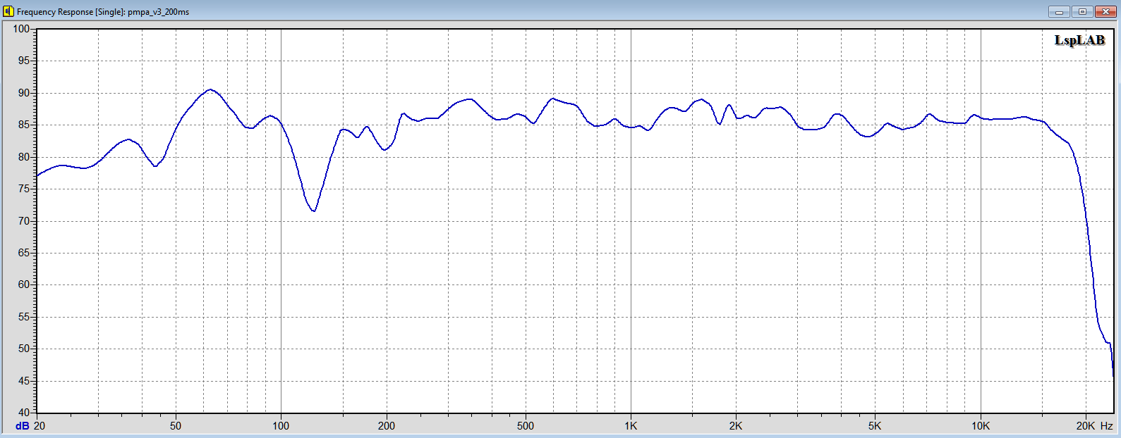

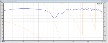

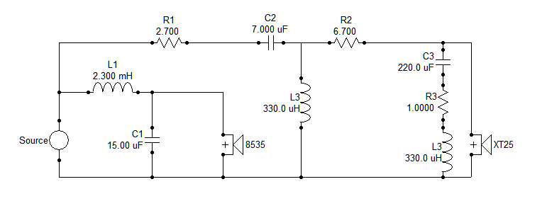

pmchoong said: Hi Ursus82, do you mind sharing the XO design? Click to expand... This XO is not final, but very plesant to ears. It is needed to vary R3 for best phase coincidance.
