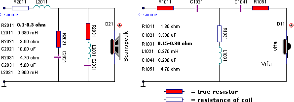

Attached is the Xover taken from Troel's website (I hope he don't mind). Which part of the scanspeak xover do you think I should change? I will keep the XT25's xover section.

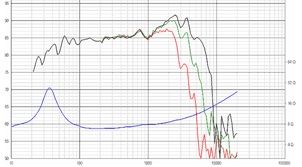

No way. Look at the 8535 response chart below. The woofer demands very low crossover point. Only expensive tweeters can go low enough to match with the woofer.
The PL14+XT has very high crossover point. XT25 doesn't sound good at low frequency crossover so you're in trouble.
Show us your previous 2.5 clone crossover. Sibilance comes from tweeter's crossover mistake, most probably directly from notch filter. Who knows somebody familiar with the tweeter know how to fix it (by not using textbook notch filter).
If you don't know about crossover, my recommendation is to use active crossover. You don't need the complex skill of passive speaker building.
With active you can cross at very steep slope (so crossover frequency can be chosen lower than passive) and you can even equalize any peak easily.
The 8535 seems to have strength at low frequency response so deserve a keep if the limitation is understood. Three-way passive is my choice in such situation, but you don't know about crossover so the active approach is my suggestion.

I think your picture shows the Scanspeak 18W/8535-00 frequency output, a driver that was considered one of the best in the world in the form of the ProAc Response 2.5 and shame that you could not use it in a passive crossover. The Vifa XT25TG30-04 tweeter crossed at high 3K/3K5 with a third order/fourth acoustic will have no sibilance from my point of view, but I understand is not (work) for newbie. If that happen (I know I read about the subject) was that poor design/options was helping that and you always turn to active as a way to run from more time/trouble when you don't know what you're doing. Consider that your last option. I system that doesn't run in passive you can never make it work as an active. Passive systems are superior in the sense that you are dealing with the essence and balance of the nature of the drivers not artificiality (EQ) and amp. power. I'm saying that the design with no RLC notch is better option also, not to be confused by you bringing it again to the subject. Many design choices are a tool of the person and better acoustic solutions can be achieved if not used as a lot of us know. Sometimes, and that was the case of the ProAc 2.5, peaks and roughness where a sonic advantage of the identity of the ProAc sound, against the flatness of Troels new 9500 tweeter crossover design, not a bad thing.
Do yo mean the clone? I believe the original ProAc woofer has different characteristics, especially to remove the breakup at roll-off frequency. If the cone is not made from carbon fibre, I believe the ENABLE approach can solve a little by adding extra weight to the cone edge.

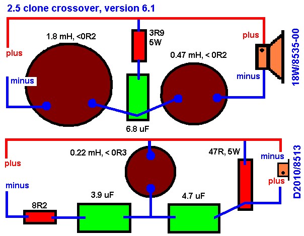

My xover for the 2.5 clone is as attached, which is the one from Troels' paper and the modification to the tweeter as well....removing the fluid and damp the center pole. The xover is clued under the cabinet. Maybe I'll remove them and use them for the 18/8535 and XT25TG combo. I'll take a photo once I removed them.

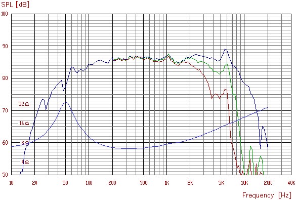

The 18w/8535 looks similar to the Vifa PL14WJ...see graph and compare to Jay's 18/8535 in post #9.

This crossover is designed for the 2010/8513 which is a 8ohm tweeter and the 47R would drop it to about 6.9ohm. The XT25 is 4ohm that would be even under 4ohm in the 2-4Khz range. Also, the single 47R shunt resistor will be very far away of taming the peak at Fs. You`re going for a high order topology, which is good in this case, but you`ll achieve an acoustic LR4 at around 1.5Khz and below, I think that the peak might become audible. When you have your crossover in place, play a sweep 200Hz-5Khz and listen, if you hear the tweeter hissing ( I bet you will ), then you need an L-pad or a parallel RLC attached to it. I have tested both, L-pad won`t tame the resonance that much ( it could but shuntvalue will be less than 3.3ohm ). For the RLC - I have done many experiments, with the version I have values are R = 3.9, L = 1.0mH, C = 82uF. You can use a bipolar electrolytic cap and a 0.6mm wire coil with R = 0.5-0.6 and a 3.3ohm resistor to save on cash. This will flatten the peak and will make the XT25 a pretty good tweeter. I think that you could use the XT25 with a LR2 from 2.8-2.9Khz and LR4 from 2.2-2.3Khz.
