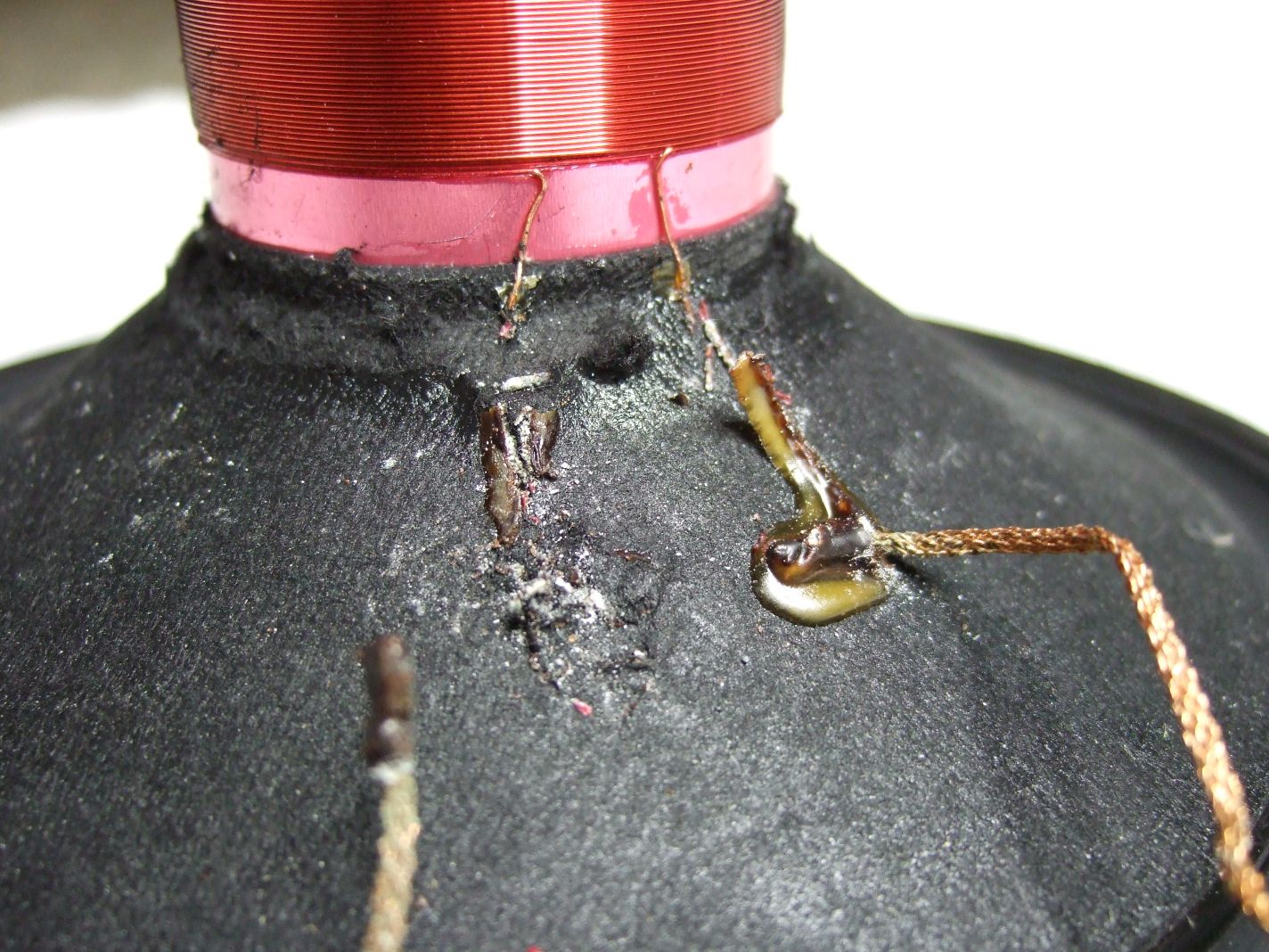

Picked up a pair of 18W/8545 (approx ten years old), which suddenly died.
Connection between litze wire and voice coil wire, covered in glue, was detetrioated and gone. Fixing the connection, and the drivers are working again.
This type of manufacturing fault appears quite common with some batches of Scan-Speak drivers.
Only yesterday I had an 18W-8545-00 which exhibited an open circuit voice coil. I dismantled it and found exactly the same fault as you had. In my case it appears that the glue used was a rubber based contact cement. This is a no-no in electronics - it is corrosive to copper and aluminium. In my case the coil wires attached to the rear of the cone had completely turned to a grey-white oxide track. I have fed this info back to Scan-Speak but I don't expect a positive response. One would have thought that a company with the reputation of being a proud Scandinavian speaker manufacturer of note would know that only neutral cure adhesives should be used to attach copper wires to the rear of the cones. See pics attached.
I have another story equally horrendous with four Scan-Speak 18W-8542-00 drivers. After around 20 years the magnets and pole-pieces had started to slide - evidenced by the unequal edge showing around the edge of the rear pole piece plate and the magnet periphery. In one case the pole-piece had slammed hard to one side and trapped the voice coil damaging it irreparably. It was a simple matter to separate the magnets and pole-piece plates by inserting a knife and gradually increasing the thickness of plastic shims until I could easily pull the pole-piece plate off completely.
It seems that Scan-Speak had used Cyanoacrylate (superglue) to stick the parts together and this is a totally useless adhesive to use for such an application. With the effect of moisture and temperature over time the superglue loses adhesion and lets go thus allowing the polepiece to move and trap the voice coil. New replacements for these drivers is around AUD320 ea plus freight so I decided to repair them - they needed refoaming anyway. I had to fabricate semi-circular plastic spacers to set the voice coil gap and I used super strength Araldite epoxy to stick everything together.

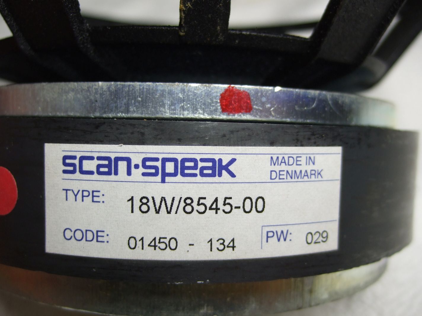

Over the years Scan-Speak have used different format of productions codes, in this case PW stands for Production Week and shall be read as week 02 of a year ending with 9 and as I know we changed logo to red/black in 2007 it must be from 1999 or it could also be 1989, but I doubt it is that old."
Since my 18W-8545 is labelled PW 029 it was made in week 2 of 1999. Note also that the babel was blue and black lettering. If Scan Speak is correct the label colour changed to red and black lettering in 2007 so using the above information you should get a good idea of when your drivers were made. In passing, one would think it a far better idea to use 2 digits to indicate the year in the PW code so that the date could be pinned to a specific decade.

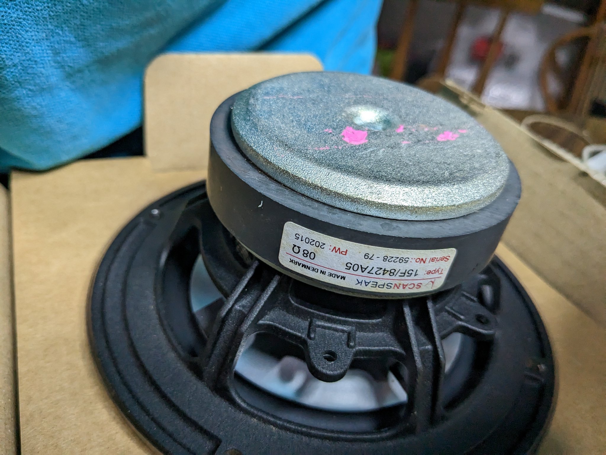

the Eikona bought in 2015. If they knew about the problem , why does the problem arises in my speaker manufactured in 2015

having a speaker with a date code of 2015 fail is not something any of us would expect! Who knows, I may regret buying mine somewhere in the near future. I hope not.
Indeed it isn't. I suppose the reply to rherber1 did say that "The changes (remedies) were made over a relatively long period of time so there is not only one specific date". So, there hasn't AFAIK been a 'resolved by' date identified, that we can be confident of across all models of their drivers.
Maybe some models went on unchanged until after 2015? Seems a bit unlikely, but then the whole thing is rather unexpected and (it appears) wasn't exactly dealt with overnight.
