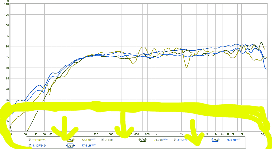

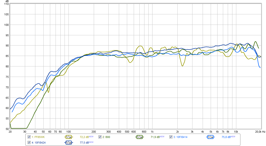

Think LS50 is serious speaker as reference point so that you lean towards 10F/8424 direction guided by XRK971 comparison threads think sounds bit logic based own participation into those comparison threads and the data shared over there. Own a pair 10F/8424 myself and except bit high cost have only good experience that driver and its quality, that be if you benchmark it real world with own measurements it won't disappoint and show excellent data including sound performance seems follow up, although subjective sound performance can be different from person to person so take that with a grant of salt. So based data agree you lean for 10F/8424 or 10/8414 that has a bit lower bass extension, other than that there is B80 and the two Dayton's RS100P-4 or RS100-4 that did not sound bad in comparison threads and they have even lower bass extension than 10F's and B80. Alpairs seems have lowest bass extension in class but haven't seen any being especially smooth when measured as to compare a LS50, and that's probably why you didn't like it even it was top model.
Below is into REW traced response from manufactures data sheet overlay for FF85WK, B80, 10F/8424, 10F/8414 and beside is Dayton plot's for paper and alu version, all should have about same X Y scaled axis.

Brytt,
You keep posted those graphes as if they prove something -- a rookie mistake. This is where the difference between good & great happens. The big difference between the drivers mentioned in my post just above are in the highlighted area where the graphs show nothing.
This is also below the level of information captured by X's tests.
dave
dave
Brytt,
dave
Right i do because you keep claim superior sound performance pointing to nothing real prove but what seems your salesman personal subjective tests every time your preferred drivers is run over by other real world better data.
1. How smart is it push your preferred drivers in this thread when ChuckT tell you he have LS50 reference, he also tell FF85 is not good enough and even after extended burning in time he have sold top model A7 MAOP, will that give future satisfied customer.
2. Rookie mistake WOW - How can you be so many years in sector not understand speakers is minimum phase devices and response deviations from pure flat especially the high Q ones have so big influence on amplitude and timing distortion that output from so unsmooth family of drivers can never be true to their input. Peaks gives too hot perceived amplitude and advance timing compared input signal, dips gives too weak perceived amplitude and timing lag compared input signal, the higher Q is for peak and dips the worse and because timing is distorted compared original input signal waterfall will look a awfully mess and so will sound performance reflect that waterfall mess.
3. You point to audio tracks dynamic range material far down low level should be parameter your preferred family of drivers perform better, well have you looked a VU meter upstream how less it often swings in reality and what we actually first hear is what happens right at top and that means for your preferred family of drivers is distorted output verse input stream, so get that right first before any talk of low level correctness can be discussed.
4. FF85wKen, Alpair 7.3eN, A7 MOAP, A5.2eN, A6PeN are probably very good diy full rangers but think you very wrong begin claim they can compete with LS50 class of compromises into be true to input signal. Can tell you personal did think A10.2 and A7.3 sounded interesting and pleasing but at same must say they sound far from most other speakers performance no matter level of cost and precision and think that is strange.

Dave,
In my opinion, you are the one that should learn a thing or two about the graphs. As long as you stop at putting speakers in a box and hope for the best you will never learn what that difference between good and great really is.
The graphs could tell you, you just haven't learned to look past the standard representations yet. Stop calling someone a rookie because he follows a different path. And stop bashing speakers if you don't know how to use them in the right way.
The most important thing we hear is the frequency response. It's smoothness is important and allows it to sound good with all genres of music. Ripples in the response or in the case of the FF85WK lead to transient effects in the time domain like ringing. I have argued that drivers with sharp peaks in the HF allow the selective amplification of what we perceive as detail. The problem is, this detail is enhanced and not present in the source material. But for some people who have a love for extra "detail" in their music, it sounds like it has the ability to play "low level detail".
