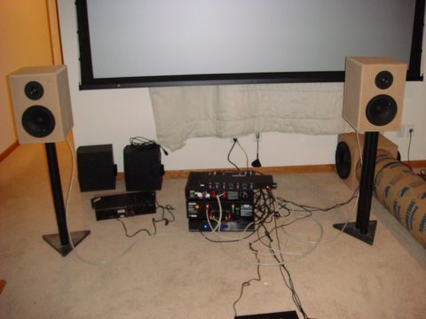

One of my installers is an enthusiastic DIY speaker builder,so he built the 2 cabinets
The drivers are the 7" Revelator mid woofer 18w-8531g and a the 2905/9700 Revelator tweeter.
I bought a 3 way crossover the SAC23 Rane. It could have been a 2 way,but I thought I might experiment with stereo woofers at some point.
The cabinet dimensions are around 2 liter as I recall.Brady made some sturdy sealed cabinets to around that size.
I had some old Adcom 535s to use as amps and a GTP 400 Adcom preamp to go along with them. I have a sonotube compound (2 Shivas)transmission line woofer from a previous experiment so I hooked it to the Summed woofer output of the Rane.

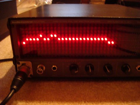

Long story short I used 1800hz for the crossover between the 2 Scan Speak drivers, the sound was very detailed. I used my old Audio Control RTA to check the response and it looked pretty flat,with a small dip at the crossover point.
I started to notice things in very familiars recordings for the first time using these revealing Revelators. The bass integration with the sub out was excellent as well.
I kept reading more about crossovers and noticed that "Zaph" in general liked to use the lowest tweeter crossover possible within the parameters of the components.
OK,the specs show the tweeter pretty flat to 500hz,so very carefully I lowered the crossover setting to 1000hz on the Rane. It has 24db per octave filters so it shouldn't allow much lower frequencies to get to the tweeter. Wow! the midrange got alot better! Even at high levels the sound is really clear and detailed. I found the blend between the drivers seemed better with a lower tweeter setting in relationship to the mid woofer. It sounds very neutral. Even old "Animals" and Beatles recordings are listenable.
Classical music is "Off the Hook" Violins have a "in the room' quality.
I am pretty darn naive on crossover design,but I must in the ballpark? The sound is too good to be way off. the tweeter seems to be tolerating the frequency range it is covering too.
I am thinking of ordering a Marchand kit and seeing if I can enhance the transparency with a audiophile style crossover? 1000hz seems to work pretty well.
Any recommendations or concerns from anyone before I continue on with the fun experiment? Thanks

I have been measuring the response with my RTA. It looks pretty darn flat. If I just play the tweeter it is really flat from 1000hz on up. Bringing in the woofer below 1000hz is not nearly as flat,but the room is playing a role I am sure. The overall sound quality is unbelievable!!
I could live with them as my own reference system. As mentioned any material oldies,classical jazz sound really good. Differences in recording quality is very obvious.
The only question is whether the tweeter will tolerate the lower crossover setting? It seems to handling it without any obvious strain or distortion.

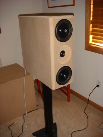

Since this thread was started, I have been trying a few different combinations. One of these, an MTM with SS 8531 midwoofers and 9900 SS tweeter. Madisound made a "leap" based passive crossover.
Great results, although certainly not as good as a more sophisticated crossover would produce. I have had good results using Audyssey Eq with any of these DIY speakers. Eliminates alot of small and larger frequency response issues
I recently saw and heard a loudspeaker at the CES show called YG. They use 2 SS 8530s and the SS6600 tweeter.
I thought it might be fun to "mimic" this design. They use a shallow waveguide on the tweeter. This puts the tweeter voice coil at the same distance and the woofer for improved phase alignment.
I ordered another "leap" design from Madisound and spent some time listening. It seems the waveguide increases the output of the tweeter in the main part of it's frequency response .The highest frequencys tend to roll off with the waveguide as well,but not too detrimental to the sound IMHO.
I (outboard) equalized the design with great success.Highly detailed with great imaging. I then found a YG review in Stereophile. Noting their crossover was 24db per octave at 1750 hz. I thought I could replicate that with the Rane Electronic crossover and the amps I used on my first design.
So I removed the Madisound crossover and hooked up the Electronic crossover and amps. Crossover set for 1750hz and 24db per octave
Wow! This is going to work out. Much more detail and dynamic sound,than with the passive crossover! I used my Audio Control RTA and a couple of Audio Control 1/3 octave equalizers (old school eq in this case, my Audyssey set up is on loan ) to flatten the sound. Most of the correction was room oriented, in the bass.
Still messing around,but this may be a keeper
Picture attached

Now things are starting to work out. I bought a Marchand XM 9 crossover set for 1750hz. Same as the YG Anat. 24db per octave. This sounds WAY better than the Rane crossover (at the same crossover point and rolloff)I had been using. Much More detail and lower noise.
Having the tweeter recessed is definitely helping maintain phase alignment between the drivers as well
It sounds like a really really expensive speaker now.
