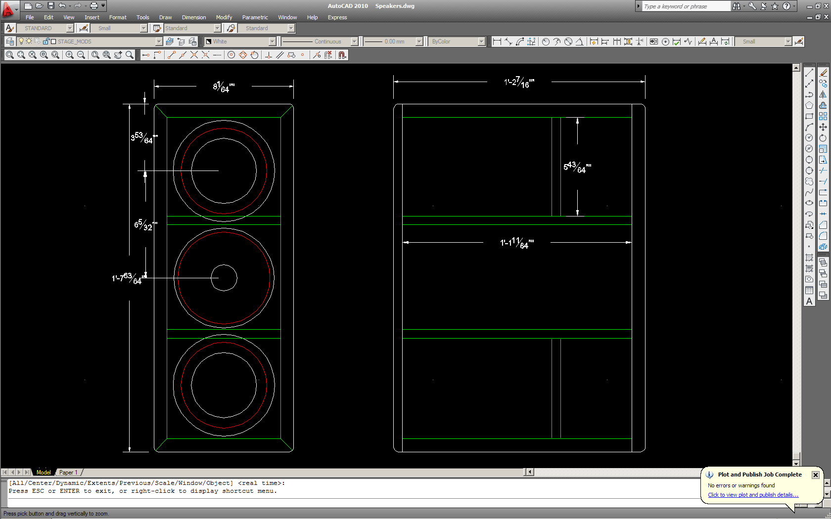

My drivers, crossover and tweeter acoustic lens assm all came from a set of YG Acoustics Anat Reference 2's which i upgraded for a client and I got to keep the old stuff. The crossovers are quite nice. I am replicating the YG Design. Well I am making mini-monitors from the top section.
YG ACOUSTICS - PRODUCTS - ANAT REFERENCE ||
My general cabinet design ideas so far. I am making it so I can move a block forward and back in the cavity for each mid-bass to tune it.
http://www.xymox1.com/Junk/Speakers.gif
I would have to reverse engineer the xover to figure that out, is that nessary to work out the cabinet volume ?

I have used this same driver with much success in 15L (1/2 cu.ft.) box. F3 in a closed box will be around 60 hz. With a vented alighment, closer to 40. hz.
