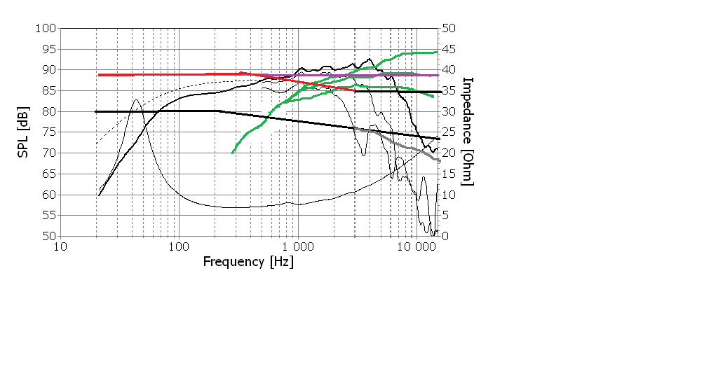

1º Find a similar tweeter partner, might be an SS Elipsoid, but most Audax like TW034 will do: Green curves.
2º Forget about axial response, and choose apropriate axial design for flat overlapping drivers responses: Purple curve.
3º Need to fine tune a shelving response for your xover transfer function for BSC and room curve control: red curve.
4º Target room curve is black one: you need to boost >5khz to get this curve. With a flat tweeter, you will need to use Dirac, DRC-fir, Acourate or whatever to achieve that elevator bliss, or your highs will fade to grey...😀
