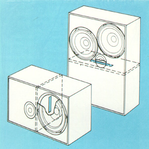

I've seen this in the PE catalog and was wondering what they are used for?
Would these "help" a driver that "works best in a vented enclosure" if used in a sealed box?

That's basically what they're used for. They can often allow you to use a "sealed" design in a smaller than optimal enclosure. They can also be found under a few other names, such as the "Variovent". Personally I haven't used them, although I've heard of people using them successfully.
I have been thinking about an enclosure that is divided by an internal wall. There are two chambers: The small chamber is the primary chamber, where the speaker driver is located. Between these two chambers is an otherwise airtight wall, but there is a hole and an aperiodic vent installed to it. The bigger chamber is much bigger than the small chamber. Probably the big chamber would be so big that increasing its volume would not practically change anything. The small chamber is very small, just like aperiodic speakers usually are.
Unlike traditional aperiodic speakers, this one does not leak outside. We may consider it as an extremely damped closed box, because that is how it appears from outside: no vents. Also the big chamber may be stuffed with steel wool, angel hair, cotton strips, or any other favorite damping material, to further enhance damping. The smaller chamber may be also stuffed, but probably not using steel wool.

Your idea is similar to figure 1 in this patent US2065751A - Acoustic resistance device
- Google Patents
Although there, the secondary chamber is smaller than the primary chamber.

An internally-vented aperiodic vent, 2 chamber, design, was used successfully in the Dynaco speakers A35, A40XL and A50 speakers.
I have A40XL speakers and the internal vent is a relatively small rectangular slot with dense fabric over the slot.

NAIM also did some speakers like you describe.

As in the internal resistive vent? The basic idea is that the driver 'sees' a small volume at higher frequencies a la an acoustic suspension, but as wavelengths increase the vent becomes increasingly transparent and the whole box volume is used, in some cases with a better damped impedance peak than would typically be the case. It also avoids the ultimate unloading that a regular resistive vent to the room has. Usually the latter isn't an issue, but technically it does happen at some point.
