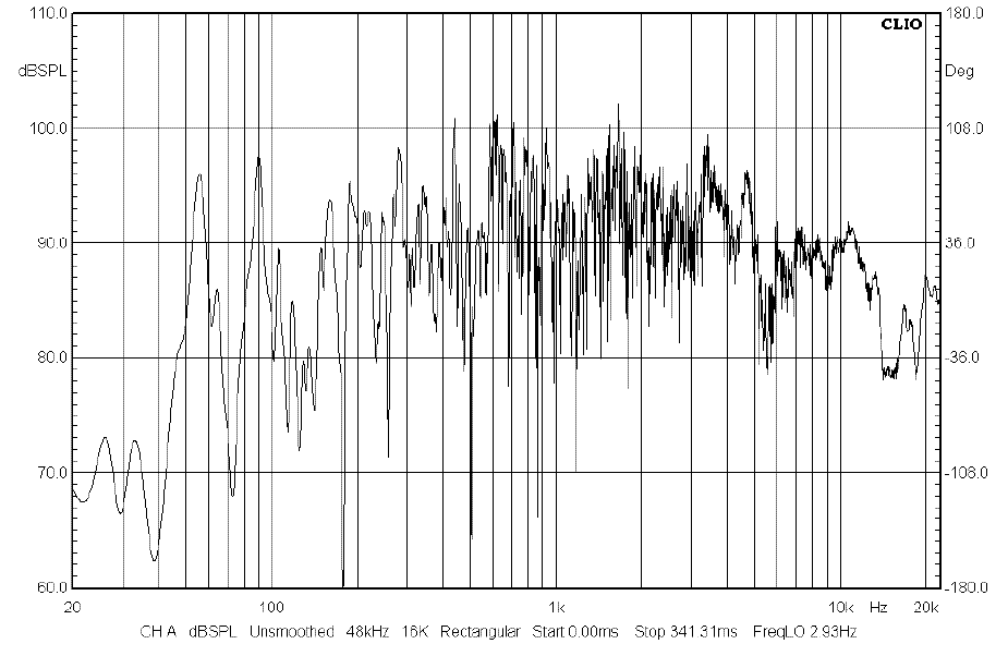

I wouldn't bet on it. This is what raw data looks like:
Most manufacturers are economical with the truth with their published FR plots. Smoothing can be anything from minimal to 1/2 octave or more (and they very rarely tell you how much). Another slightly more subtle favourite, is to expand the dynamic range on the chart to a huge value. Then they can play around with the resolution of the data sheet & size of the image... lots of lovely ways there. Some are better than others, but ROT is don't take them at face value; about all they're good for is assessing general trends.
I will take a smoothed graph over that graph anyday. One isnt able to hear all those tiny peaks and dips anyway. Tonal balance is what matters, at least to me 🙂

Who said anything about 'tiny?' Very little smoothing will cause those to vanish, but larger abberations also get wiped out as well. That's why they do it. And is the point I'm making, i.e. that factory plots are almost always fairly heavily smoothed, which may disguising some less-then-pleasant characteristics, and therefore don't take them at face value.

Done outdoors and closer to the speaker, say 50cm a lot of ripples disappear. What you see is reflexions that spoil the response. You could measure much closer, say 2 to 10cm and see the real behaviour of the membrane. That does not tell you how it sounds at the listening space though because acoustic impedance is not shown in those nearfield measurements.
Is it the same case with drivers measured in an anechoic chamber?
If they are totally anechoic, yes. Usualy they have a low frequency limit, somewhere between 50 and 200Hz dependent on size and construction so i prefer oudoors on ca. 3 to 5m high stands if i want the full measure. Freefield and nearfield can be combined. Don Keele made a paper about that and that is what i usually do. Praxis, the software i am using has a script that allows that. How you tune your speaker in the bass has to do with roomplacement and preferences. When i build a conventional speaker i usually use an oversized reflex cabinet tuned low. For example make Vas = the volume of your bass box and tune the reflex port to Fs. That way you get a smoothly falling response in the bass and the room gain helps out so the combination of room and speaker is more or less flat and you get less distortion then putting a speaker in a small box tuned high. Roomgain at 20Hz in a medium sized room with speakers aproximately 1,2 to 1.5m from room boundaries and corners is ca. +9dB with a slowly rising trend to deeper frequencies of 4 to 6dB/Oct.
