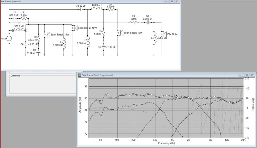

I've been wanting to build the Ekta Grande that Troels Graveson designed. However, the cost, cabinet complexity, and fact that it doesn't match my other speakers had deterred me from this. I was in the process of building a set of towers using some focal drivers I had, but after a Lightening storm took out my speakers, an amplifier, and two tv's, I decided that maybe its time to build that Ekta I wanted to build. Then I saw Zaph's 2.5 way ZRT design, and started thinking more seriously about this. Zaph is using the great Aircirc tweeter with the same two midbass drivers, but no midrange. In fact, in the end, I may just build this nice design as is, and not worry about the more complex 3 or 3.5 way (Which I'm proposing). Troels and a few others who listened to a design somewhat similar to the ZRT, but with a somewhat higher crossover point, felt the 18W drivers didn't give a very accurate midrange, and felt that adding a midrange greatly improved things. I believe Zaph has circumvented this issue with the low 1.6khz crossover point, but then, it has to be at the expense of lower output and higher distortion. The problem I have with the Ekta is that the woofers are simply run in parallel, and I think this will not be best, I think using a baffle step inductor on the second woofer, making for a 3.5 way design is a better idea. My plan is to use externally mounted crossovers, so that I can activly cross these over in the future, or at least play with the idea, but for now I plan on building the crossovers as a passive design, and use a C-core toroirodal inductor for the second woofer, in order to keep the high value with a low enough ESR. I'm wondering what you all think of this modified crossover design. It's quite a bit different from the original Ekta's in values, and its possible that the original values will be better, and that mine are off as a result of not having actual measurements yet, but I can't get the drivers to measure until I straighten some things out first.
I'm also kind of thinking that no inductor on the second woofer simplifies things and might work find, in which case it would remain a normal 3 way, but would have some modifications to the crossover values. As I said, I think I need to actually mesure the drivers before ordering any crossover parts. If anyone has actual measurements of all these drivers, I would appreciate it, give me something to do.

The current drivers I'm thinking and modeling with are the Scan-Speak 18W/8531G00 x2, 12M/4631G00 x1, and the Vifa Xt25BG60-04 (New dual magnet version). I know that tweeter seems a little out of place considering the other drivers, but I think it might be a good option, and the Scan-Speak version is just too expensive.Ekta Grande

I would stick with the proven design using the XT25TG-30-40, which is excellent value compared to the D2904/7000. If you make adjustments, then you are building a different loudspeaker.
I know that Troels has some XO variations for different tweeters on the original Ekta. 95000, or 97000 if I remember correctly.
I suggest that you contact him. He is usually very happy to discuss options.

Yeah, First, let me say I fully understand that changing values will change the design, thats why I said that. First let me say that I realized my own offsets were completely wrong, and I need to change that, er rather, i did change that, and found that very different values were needed. Oops!!! Thats what I get for modeling things quickly.
As for where I got my data, I was able to get actual impedance measurements for the woofers and midrange, but not the tweeter. The FR files are traces, nothing more. I don't usually trust them much, but to be honest, I've been told they are closer than I would give them credit for (Probably depends on how carefully you trace, and how many data points you use). I would much prefer real measurements for the FR files, and some real impedance files for all the speakers, but that means buying the drivers, which I can't do at the moment.
I'm planning on putting them into a smaller sealed box, as the bass will be fine (They will be used with a subwoofer), and I like the sound of those drivers in sealed boxes.
I will talk with Troels, if I can, about the crossover some more. I'm thinking of the Aircirc tweeter as an alternative. However, I feel like his cap size choice in the midrange is too small for good response, and would like to see what he thinks of enlarging that to something in the 30-40uf range.
