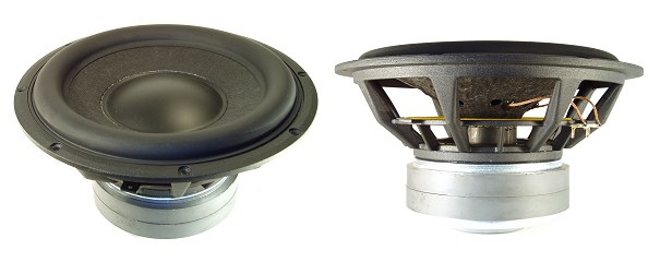

Hi, I have a 21W8553 scanspeak woofer and I would like to build a small sub for my av setup.
I googled but found no results...
Can somebody help me out with box build (TL vs vented vs closed)? or point me some links?
Unfortunately, I don't have much knowledge of loudpseaker building, nor access to a measure equipment 🙁
Will it be hard to build a subwoofer?

The reason you are not finding any hits when you google is probably because that driver is not designed for subwoofer applications. What do you have for mains, and what do you expect the sub to do? The speaker you have is more at home with a double bass viol than it is with an exploding dinasaur.
In a sealed box it won't go nearly low enough without a lot of EQ, which pulls the power handling down. The standard "boost" available in plate amps would not have the right shape anyway. A TL would probably not qualify for "small."
A vented or passive radiator "EBS" alignment would appear to be indicated. "EBS" (extended bass shelf) means that the alignment is over-damped and has a rising frequency response throughout the subwoofer range. "Boost" from the plate amp, "room lift", and the fact that you are crossing over to the mains at a fairly low frequency, all conspire to flatten out the response.
An EBS vented box would have a pretty long vent.
So a passive radiator EBS alignment is what's left. Ideally you would want an amp with boost at your tuning frequency (30Hz?) and a 24 db/octave low pass filter. A sharp filter is desirable to help kill the rising response. Parts Express has a 200 watt plate amp with an (unadvertised) 24db per octave lowpass filter, and I think they can tell you how to swap out a couple of resistors to effect the necessary boost.
What you will wind up with is something similar to a Peerless XLS passive radiator system, except it would not go as low. The XLS driver *is* designed for subwoofer applications. You might just want to sell the ScanSpeak and buy an XLS. They are manufactured by the same company, BTW.

As Dave has pointed out, the SS 8" midbass driver isn't really subwoofer material. It just doesn't move enough air. It's the speaker equivalent of one of those snobby restaurants where you pay a pile of money for a snack sized meal. A hamburger and chips are more likely to satisfy your appetite!
EBS is going to place too much of a demand for excursion on the driver and will take away a bit midbass punch, which will have the overall effect of sounding like it has less output! It will also increase the necessary size.
You could probably get a pair of these to work nicely in a stereo pair of TLs. I do hesitate to recommend this alignment due to the low Qts but I believe it was shown in a previous thread that this is not an impediment. This driver is known for its bass and as its a woofer it can extend into the midrange. It would work well as a woofer in a 3 way speaker and could easily get a useable inroom response down to 25 Hz with decent output with a pair of them in a medium sized room.
I expect it will be more articulate than most subs. A pair will move a similar amount of air to my TLs, which is more than enough to satisfy most people for movies. However, in a sub, the tendency is to crank it up. I just don't think this is the driver for a sub! (Btw, I'm adding subs to my mains)

I thought he was talking about the SS 10" woofer at first, which appears to be a very nice driver.
Dave Jones said:Oops. For some reason I was thinking it was that expensive 12". Well, it ain't no subwoofer then. As predicted, I stand corrected.
Did you mean This one ?
Its only 10" (well 9.4), but its a definate subwoofer and rather Expensive.
Wow, I didn't know there was such a thing as a SS subwoofer :O
It looks quite impressive. Decent excursion (13mm xmax) and low LeVC. I'm a little curious to find out a little more, in particular what the cone material is.
Even this driver, however, only just makes the grade as a sub as far as output is concerned. Curious is the response - probably more honestly presented than most but it's far from smooth.
