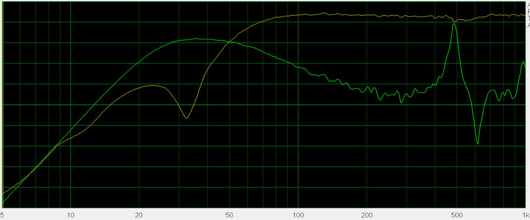

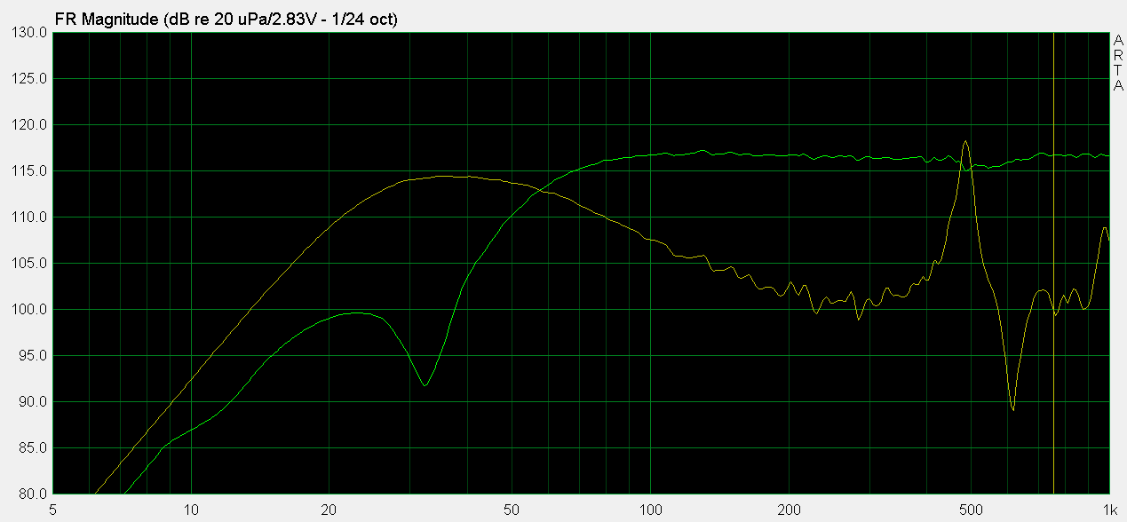

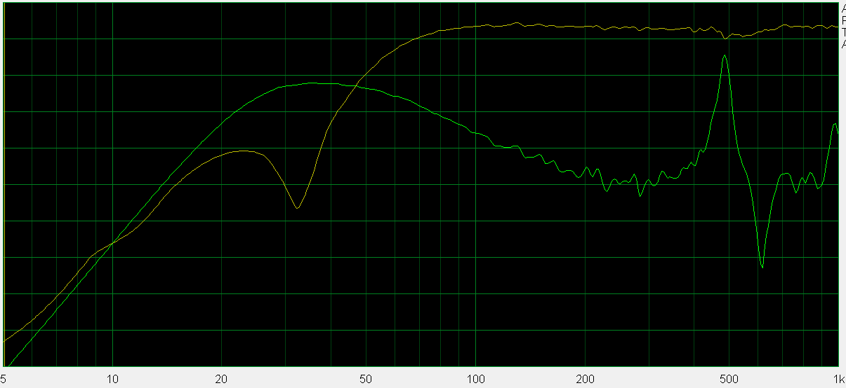

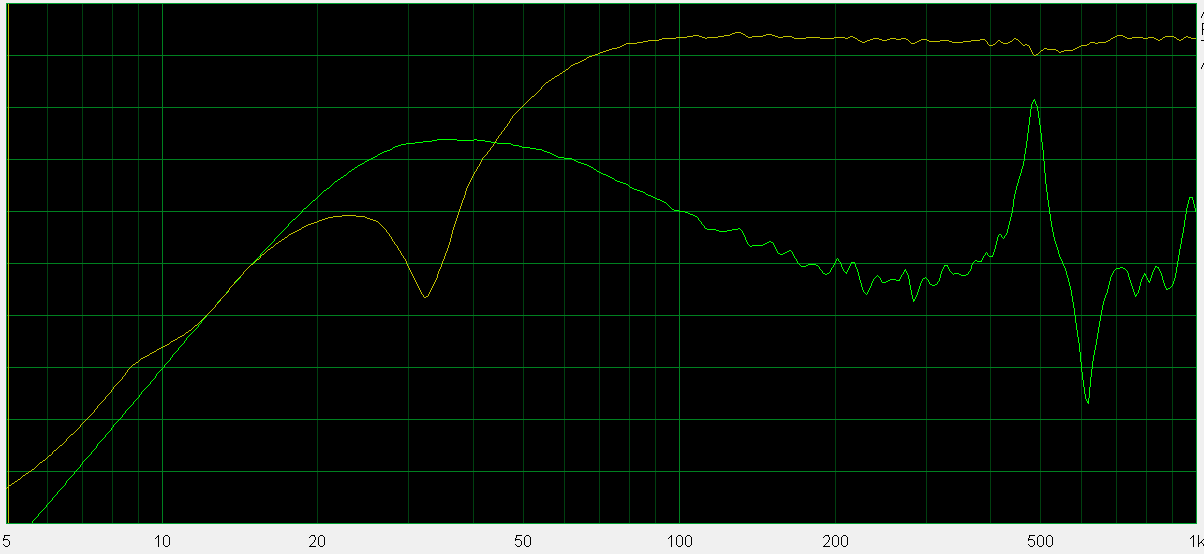

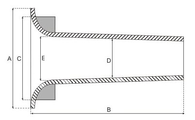

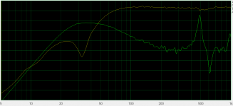

If I have flared port like on the attached picture and need to scale his response to speaker nearfield which dimension should I use in scaling formula? E or D?

I guess your goal is to scale the sound output (SPL) from the port in order to merge it with the woofer output, correct? If so, the scaling depends on the sound emitting surfaces. For the woofer, this is the effective cone (piston) area, Sd. For the port, it's the effective cross-sectional area at the end of the port. With your flared port I'd say you should use E or C, which is the "effective diameter" at the end of the port (not D, which is the diameter somewhere along the inside of the port). But then again it's not so clear what the effective diameter at the end of a flared port really is.
