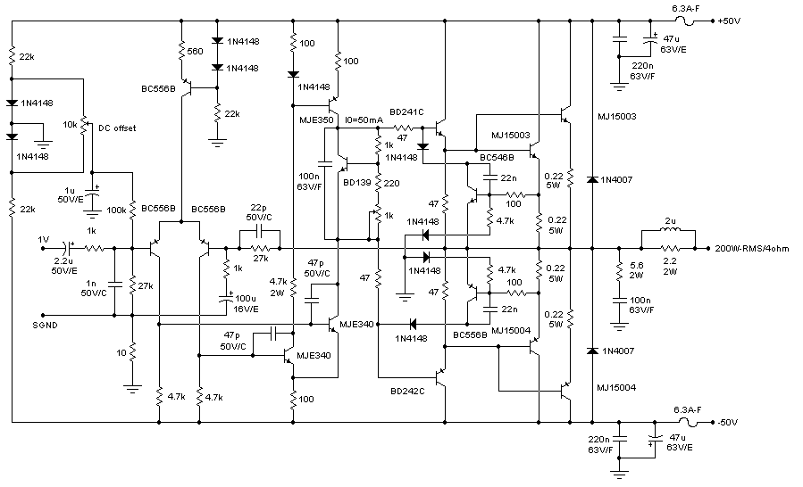

I am a madman of the audio,
Can somebody help me or to say me if this design has good guys proven to be?
Has somebody constructed it?
I need slight knowledge to construct also the power supply, he has a consumption of 5A
Can somebody help me?

Studio 350 - High Power Amplifier Kit
Ref: Silicon Chip Jan/Feb 2004.
This fantastic new amplifier kit will deliver 200WRMS into a 8Ω load, or 350WRMS into a 4Ω load. It is super quiet, with a signal to noise ratio of -125dB(A) at full 8Ω power. Harmonic distortion is a fantastic 0.002%, and frequency response is almost flat between 15Hz and 60kHz. Kit supplied with PCB and all electronic components.
SC = Silicon Chip
If you can get the PCB it would be easy to build.
Notice Q7, Q8 and Q9 is on heatsink.
If you can not find BF469/470 you can replace with MJE340/350.
I think is a good amplifier, and should be safe to build.

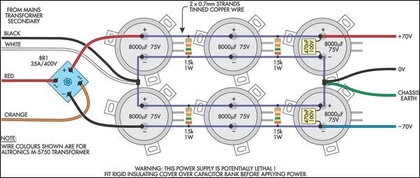

for the power supply
which is +-70 Volt DC
You need 2 transformers: 50V+50V 500VA
Parts list:
Power supply - for one channel
50V+50V 500VA toroidal mains transformer (Altronics Cat. M-5750)
35A 400V chassis-mount bridge rectifier
6 8000uF 75V chassis-mount electrolytic capacitors (Altronics Cat. R-6722)
2 470nF 100V MKT polyester capacitors
4 15kOhm 1W resistors
Parts list:

This design is based on a well proven topology that has been around for 20 years or so. Improvements over time have been the availability of better semiconductors and a better PCB layout (which impacts the sound).
Overall it is an excellent design and should provide great satisfaction. Be aware though of the total project price, if you had to buy everything new I doubt there would be much change out of $1,000 US. It might even cost more depending on your choice of components & case.

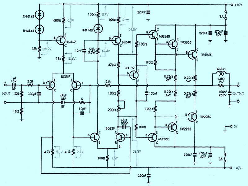

This is a bit off topic, but I would be curious to know anyones comments on this amp schem compared to the Studio 350:

The reason I'm asking is the amp can be purchased in kit form very cheap ($30) with heatsink, and it seems to be similar to the 350 at a glance.

... it seems to be similiar ...
Yes, really.
So many components are identical, that the one making this
has used the Studio 350 schematic and changed a few things.
Or the other way around.
Main difference is this has only 1 output pair and 60V supply = lower power.
This one has a current/power limiter for protection.
A few other small details also are different.
But this is 'same' amplifier.

This schematic is a direct copy from one published by Electronics Australia Magazine in 1989 (or maybe they copied it) with only a couple of minor changes. One change that I would reverse is feedback resistor R12, this was originally 1K. This will set the gain to 27. As it stands the amplifier has too much gain (48) and will perform better with a gain of 27.
The output stage (2SC5200 / 2SA1943) is not strong enough for 50 volt rails, and at high volumes a 4 ohm load would surely blow them. It does have over-current protection, but this seems to be configured for stronger transistors.
But if the kit includes a heatsink, a pcb and all the components, it's a steal. Even if you upgraded the output transistors it is still great value.

about power supply
can i change the 8000uf caps and to put 10000uf 100v?
i not find the 8000 uf value
Re: about power supply
80 or 100 Volt is better margin. 75V is only 5 Volt safety margin to 70 V.
3x8.000uF is 24.000uF to +70V and same to -70
It might be possible to replace those 3 with one 22.000uF/100V.
But better to make it 3x10.000uF = 30.000uF
and same to negative.
It is better in this case to take a bit more than 24.000uF.
And also better to use 100V capacitors.

quasi said:This schematic is a direct copy from one published by Electronics Australia Magazine in 1989 (or maybe they copied it)
Originally posted by lineup
A lot of work has been done to trim and tweak this amp.
Originally posted by quasi
Umm...
what do you call it when you re-produce something really well
.......umm oh that's it ....it's called Copyright.
Most work to trim and tweak was obviously done in 1989.
Silicon Chip two articles was in 2004, published by 2 authors.
As Silicon Chip and Electronics Australia Magazine both are magazines from Australia,
I guess eventual copyright has been cleared.
This one.... different....a little bit different from yours i already constructed.
And despite all efforts i made to make it better, it was dismounted considered not enougth good.
My personal, subjective, individual, point of view...the truth, only asking God personally.
I am telling about ,this one, i am showing you.

Carlos,
should the A1215 in your schematic not be A1216 instead ?
(and not for any amplifier, anyway)
