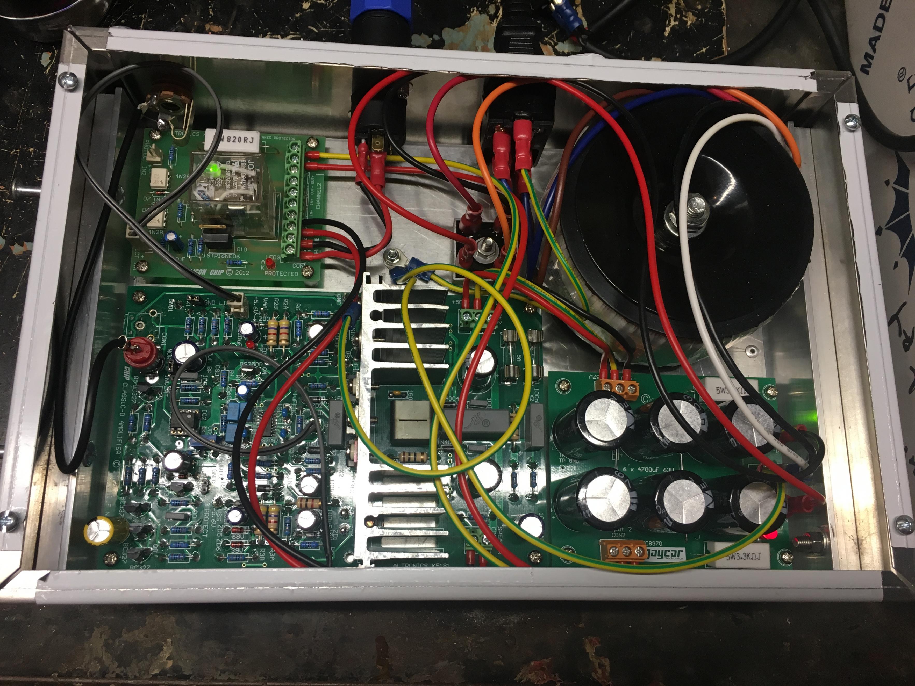

I have constructed the Silicon Chip Nov 2012 Classic D amp.
The amp operates, producing clean sound. But at idle the temperature of the two IRFB5615 MOSFETs climbs steadily, reaching the 70 deg C protection trip.

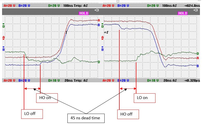

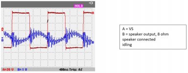

Attached are scope shots which I think illustrate the problem.

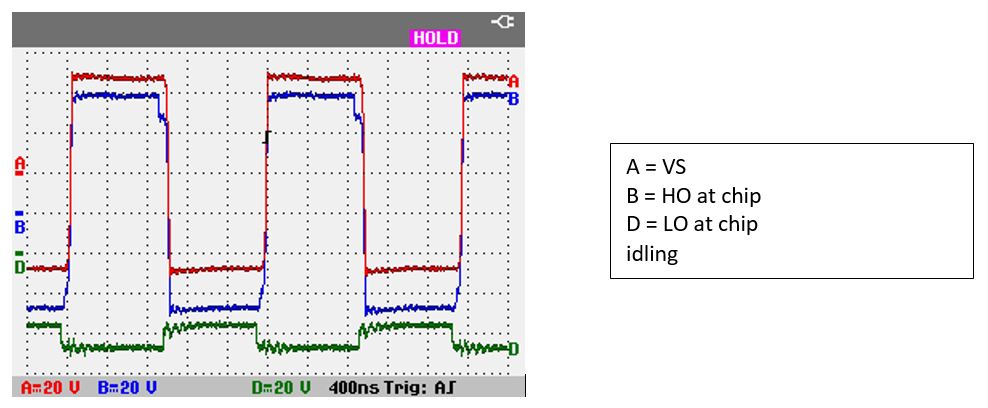

- Shot 1 shows VS/HO/LO at idle.
- Shot 2 zooms in a little, showing the glitches in the HO curve (curve B).

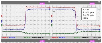

- Shot 3 zooms in further, showing the deadtime and the lag in HO turning off. When HO switches off, it stays high for 30-40 ns longer than the deadtime. For this period both HO and LO are on. There is a similar lag when HO switches on.

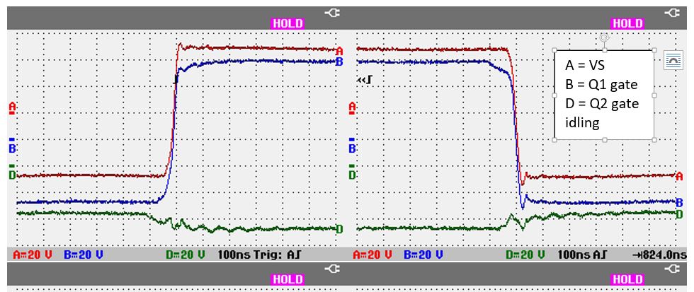

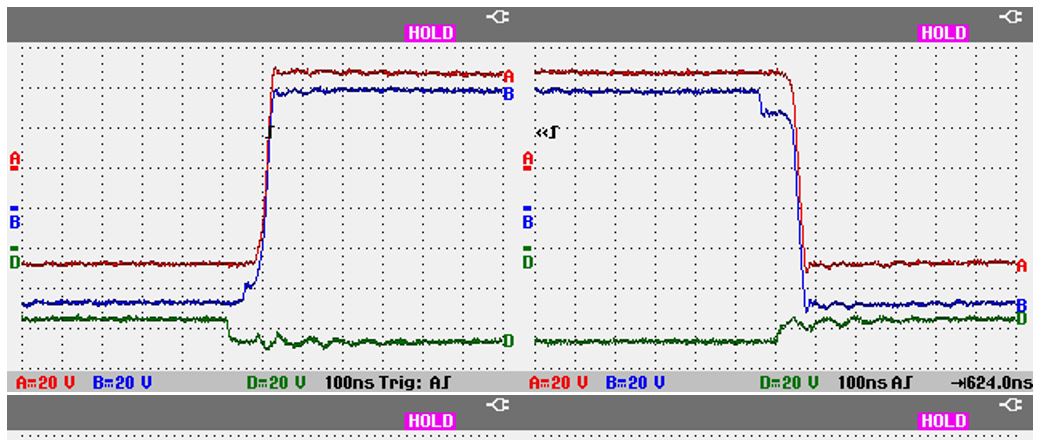

- Shot 4 shows voltages at the gates of the MOSFETs.

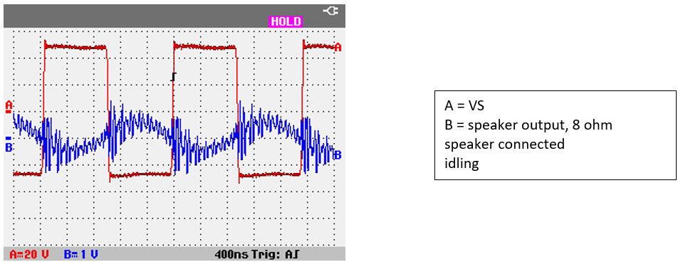

- Shot 5 shows VS and the output at the speaker connection.
So I think the overheating is caused by the brief period when both HO and LO are on. But I cannot see why this is happening.

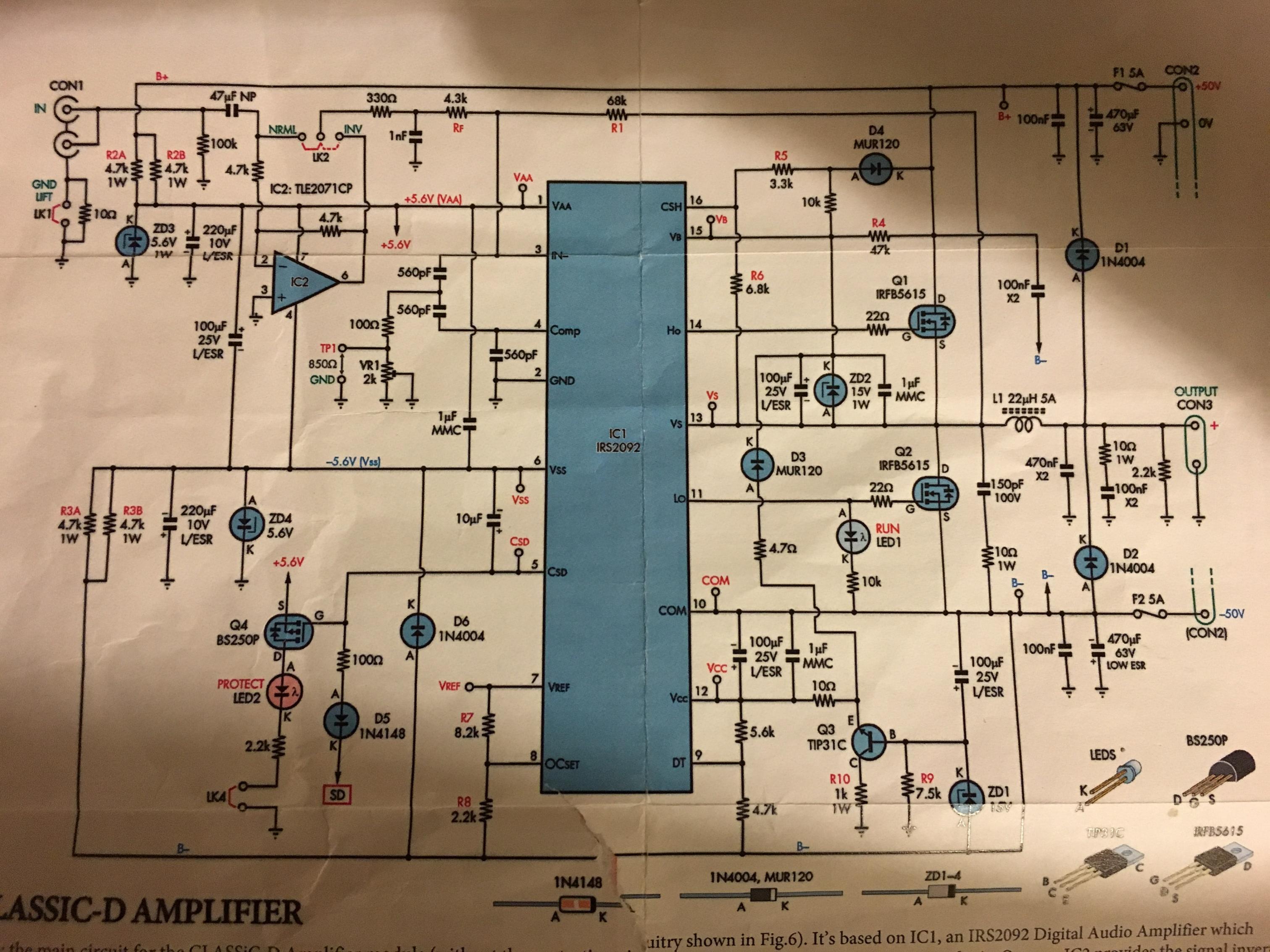

The DT values are wrong.
4k7 should be 8k2 and 5k6 should be 3k3.
That is according to the data sheet and most commercially produced successful amplifiers.
This probably will not help but from one of your pictures, attached, A is VS. B is HO. Notice how B appears to hit a plateau and A only makes the transition sometime after D, LO makes its transition to high. However HO maintains its plateau for some time afterwards.
If you are at idle then your inductor current will/should be triangular. That means it is driven positive when HO is on. If HO turns off properly that net positive current should drive VS down as the inductor tries to maintain the flow and resets to the negative rail.
Based on the above it would appear that your upper Mosfet is not being turned off properly so you are seeing shoot through current. With your 20V/div it looks like the gate is sitting at 5V which is likely above the gate threshold voltage, VGSth.
As to why... ? For the moment I cannot think of a reason but the words seem to make sense. Is the 22R resistor still 22R. Try adding a 1n4148, bar to chip, across it to improve the turn off

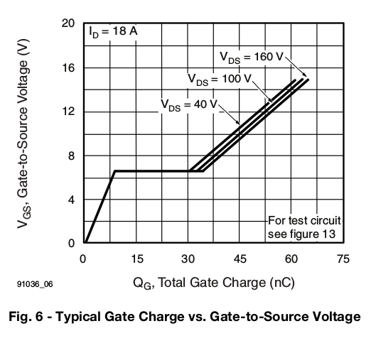

Second picture is indicative of the plateau but that one is or should only be there when the device is making the transition, Miller Effect, due to dVDS/dt.
As an aside I assume the messy waveforms are a result of not using a short ground probe on your scope probe. You might find a springy thing in your bag of bits that goes on the shiny ring or you can solder a BNC to the board.
Just in case. Possible slight correction due to finger waving. Perhaps the upper Mosfet is getting down to 0V VGS but once again if it is being properly switched off the inductor current should be driving the transition. It looks like LO is suffering from similar issues. When either device properly switches off I would expect VS to almost immediately make the transition before the opposite device is turned on.

Thanks Jon. The design write-up says the amp is based on mode DT2, which is 45 ns and requires the 5.6/4.7 arrgt. Nonetheless I will certainly try the 8.2/3.3 setup - it seems clear that the deadtime needs to be longer.

Thanks for your comments MF. I agree that VS needs to be following HO more closely. Just cannot see why its not happening.

I tried the DT suggestions above but it didn't help.. Then I tried an equivalent voltage divider to get around 8.5V at DT , since the datasheet has a 12V supply and i have 14.6V for Vcc.

On my 2092 design I just put 8k2 from DT to B-
This gives max deadtime.
I left out resistor to VCC out altogether.
I would also recommend 10R gate resistors on the mosfet to ensure fast switch on and off.

Coming back to this... I changed the DT resistors from 4k7/5k6 (DT2 setting) to 8k2/3k3 (DT3 setting). That change immediately fixed the problem. Amp works fine.
Without placing any particular blame, I am considering whether or not the IRFB5615 MOSFETs included in a particular "not named retailer's" kits may be fake/counterfeit. I do not believe this would have been intended by the retailer, of course.
The designers at Silicon Chip would have used genuine parts purchased from Mouser/Digikey, and they test these designs considerably before release.
If there was a design problem with the deadtime setting of 45nS it would have been picked up early on.
Given that fake parts are usually another inferior part or die, it is conceivable that if the kit MOSFETS were indeed fake, then the gate charge of ~26nC would likely be larger and hence the turn on and turn off delay times of 8.9nS and 17.2nS as per the datasheet, would be longer, resulting in the shoot through and excessive heating (or even failing). The shoot through can be seen in the OP's scope picture "scope shot 3".
In fact, after replacing my kit with known genuine IRFB5615 MOSFETs and a known genuine IRS2092s, I had no further issues even with the 45nS deadtime.
The fact that extending the deadtime has stopped the shoot through and hence overheating for the OP also explains confirms the suspicions of counterfeit MOSFETs.
