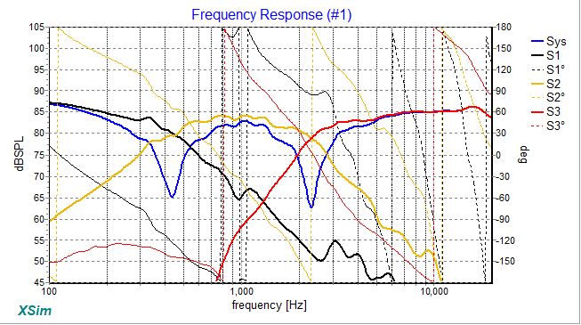

First simulation
Before ordering the drivers, I made some simulations based on published curves, modified based on the intended baffle/enclosure. So the following graphs have baffle step, diffraction, bass performance and relative driver offset already taken into account. I expect some discrepancies with real measures, but not too much unless the drivers measure very differently than specs.
This is what I expect with a non complicated crossover (LR2 slopes between bass and mid, and LR4 slopes between mid and tweeter):

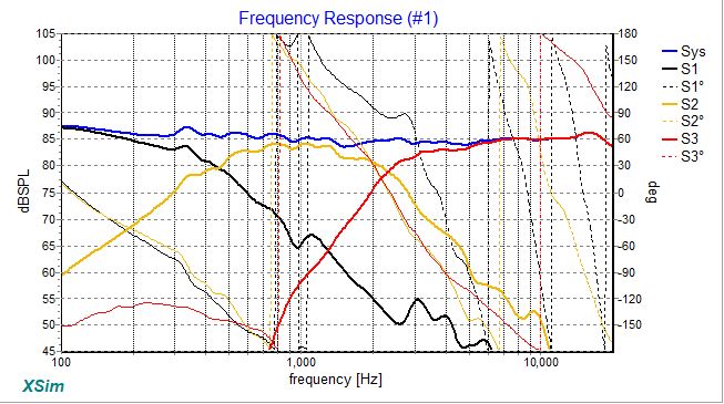

And this is with the reversed mid, showing crossover points:
attachment.php
I have yet to break in the drivers, and then we will see how they measure.

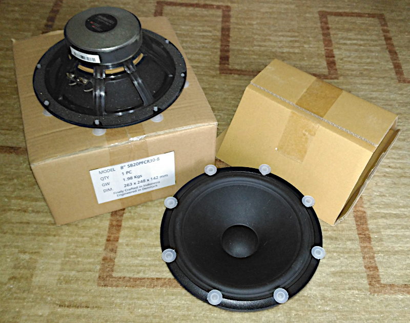

The drivers
I’m very impressed by the build quality of the drivers and also by the packaging. Apart the use of plastic for the frame, the mid and woofer look very well build, and there is nothing that calls for cheap in them. A beautiful natural fiber cone with rubber surround, the terminals appear to be solid, positive clearly marked and bigger than negative, and there is also a gasket. The mid has a hole in the back for venting, while the woofer has not, but it seems that the voice coil is well ventilated under the spider.
The packaging is not what I expected from this price point, both mid and woofer arrived packaged in the classic trapezoidal cardboard, but with lateral wings, which was inside singularly in a cardboard box. The cardboard used is thick and solid, and I feel the drivers are very well protected. I’ve seen more clumsy packaging for higher priced drivers.

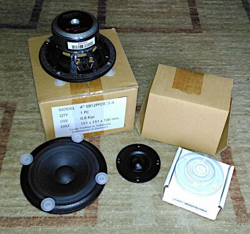

A photo of the woofers:
attachment.php
And a photo of the mids with a tweeter:
attachment.php

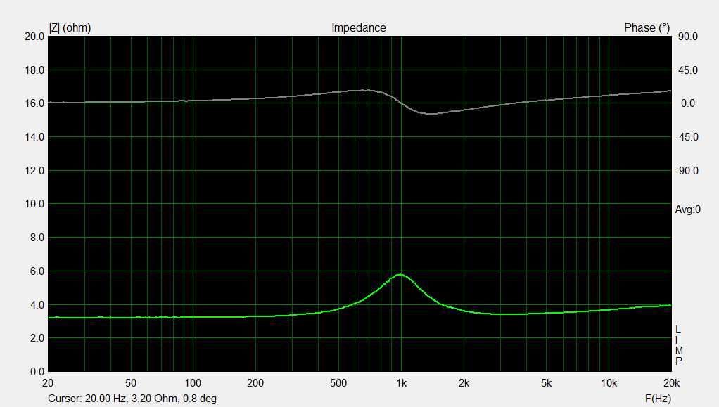

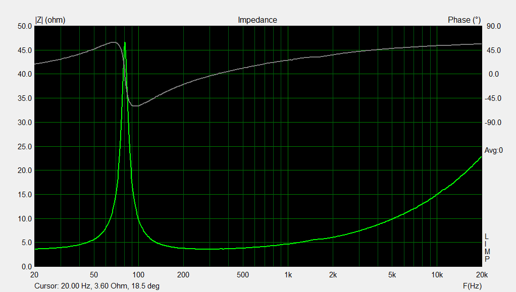

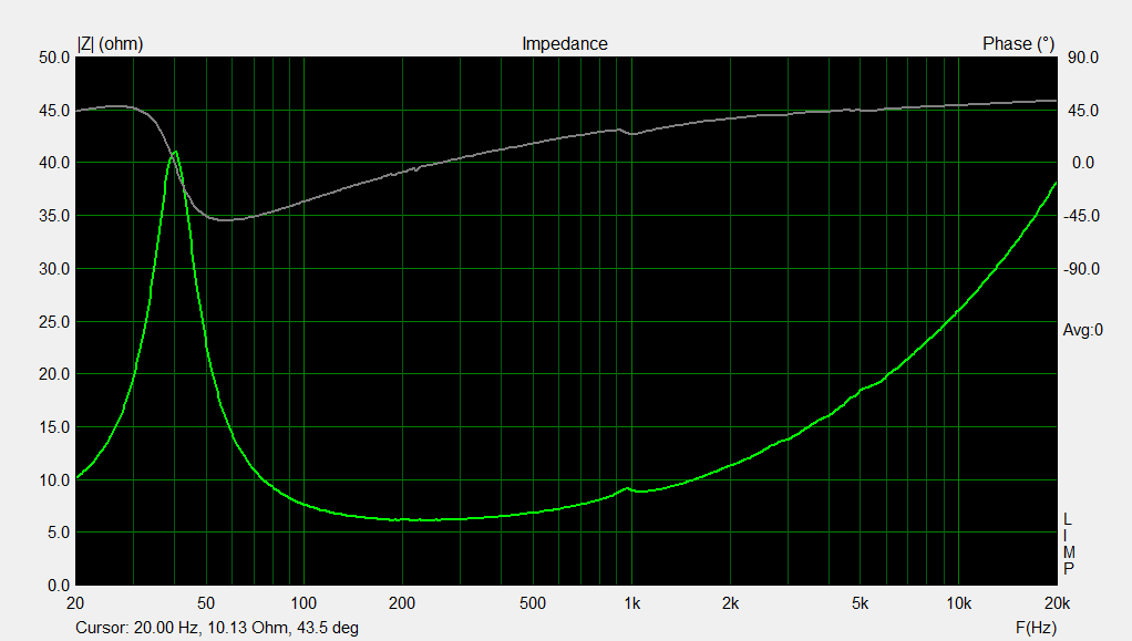

Before measuring the FR of the drivers (I need to build new baffle for my test box), I wanted to share at least the measurement of the impedance. My method for doing this is not the correct one, which is to clamp the drivers in free air. The method I found in the past that gives me a pretty right impedance to use in crossover simulation is to firmly press the back of a driver against the floor with some bluetack in between. In this way the driver doesn’t move when measured. If I see some anomalies, I just clamp the driver with my hands and see if the anomalies go away. If they go away then usually it means that it was a reflection from the floor. No problems however with this set of drivers.
Impedance of the woofer:
attachment.php
Fs is a little bit higher than specs, but otherwise the profile is pretty consistent with specs. However I need to measure T/S parameters to see if the intended cab is still a good choice.
Impedance of the mid:
attachment.php
Here Fs is 20Hz higher than expected, but otherwise the profile is pretty identical with specs.
Impedance of the tweeter:
attachment.php
Here I don’t see any significant difference from the datasheet.
