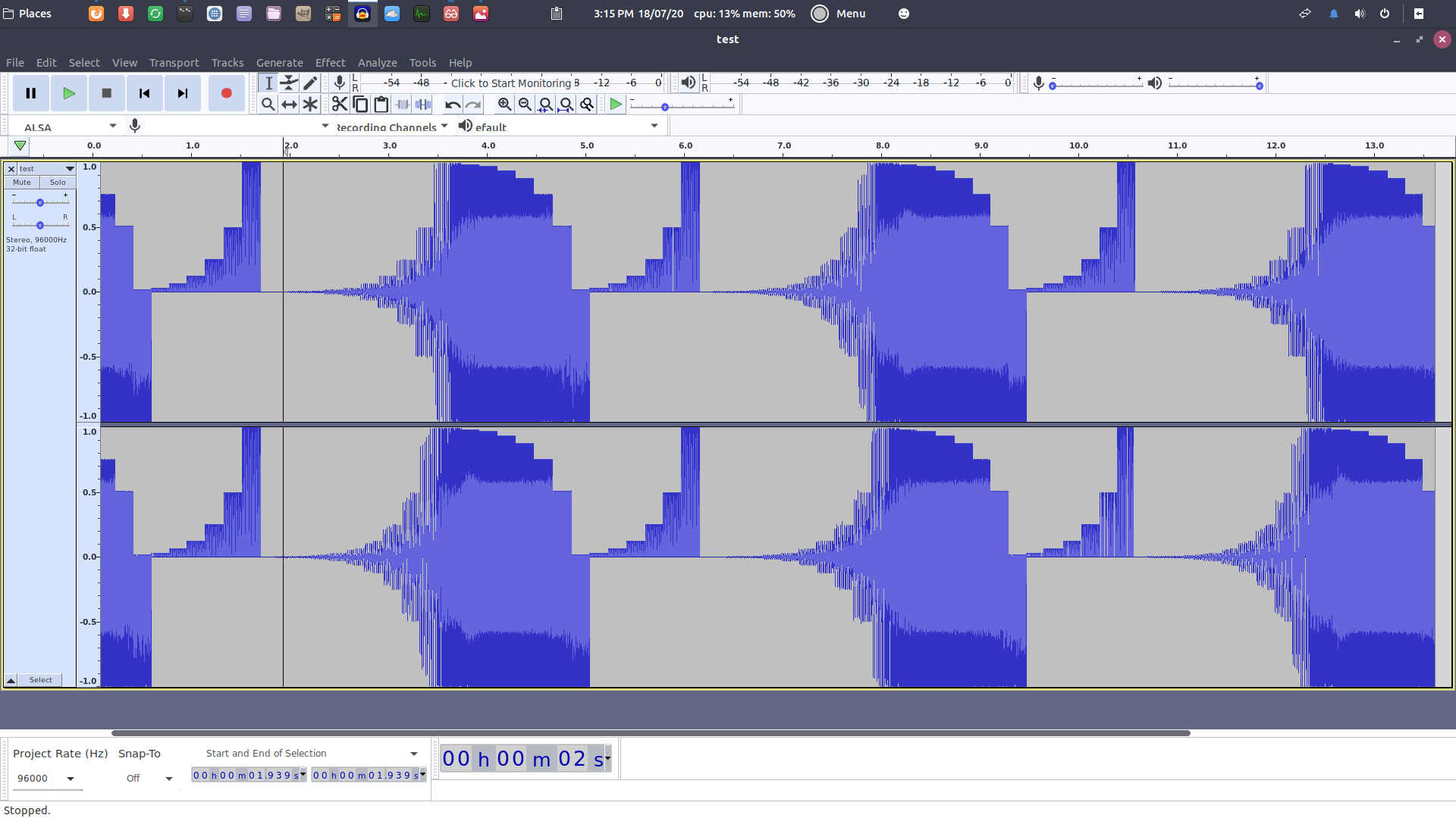

Whilst the HiFiBerry board seems to work with and be supported for Raspberry Pi I can find no documentation for the Audiophonics ADC.
My experiments interfacing it with a Raspberry Pi have so far been unsuccessful. I believe it will work as a front end directly to an i2s DAC but not as an ADC for recording into a PI.
If you have any information that would help with interfacing it to a Pi I would be most interested.

With the audiophonics board connected...and the software installed as per the only instructions I could find for an i2s card...

The card is found correctly-
Code:
pi@raspberrypi:~ $ arecord -l
**** List of CAPTURE Hardware Devices ****
card 0: sndrpii2scard [snd_rpi_i2s_card], device 0: simple-card_codec_link snd-soc-dummy-dai-0 [simple-card_codec_link snd-soc-dummy-dai-0]
  Subdevices: 1/1
  Subdevice #0: subdevice #0
No matter what arecord command I use the result is the same... (with input open, shorted, or connected to a source.. just the endless repeat of below)
Here is the recorded waveform in audacity...
Obviously something very wrong..!!

Things are not so simple. The digital mic is I2S slave, configuring RPi I2S interface to master mode. Configuration is in the mic driver Raspberry-Pi-Installer-Scripts/snd-i2smic-rpi.c at master * adafruit/Raspberry-Pi-Installer-Scripts * GitHub - constant SND_SOC_DAIFMT_CBS_CFS - explanation soc-dai.h - include/sound/soc-dai.h - Linux source code (v5.8-rc4) - Bootlin
IIUC the AK5720 board configures the I2S port of the ADC to master mode, expecting the RPi I2S interface to accept its BCLK and LRCLK clocks - that would be constant SND_SOC_DAIFMT_CBM_CFM soc-dai.h - include/sound/soc-dai.h - Linux source code (v5.8-rc4) - Bootlin

Thank-you phofman !!
Perfectly explained, and after making the indicated changes to snd-i2smic-rpi.c it now works as expected.
Code:
arecord  -c2 -f S32_LE -r 96000 --vumeter=stereo test.wav
This produces the desired output. (Other bit-rates result in single channel only recorded.)

Great to hear that only fixing the I2S mode was enough to make it work. Congrats.
As of the samplerate - look at table 2 on page 16 of the AK5720 datasheet https://www.akm.com/content/dam/doc.../audio-adc/ak5720vt/ak5720vt-en-datasheet.pdf . Value of the settings resistor would have to be changed to change the fs multiple, hence the outgoing samplerate to the slaved RPi (masteclock is fixed).
