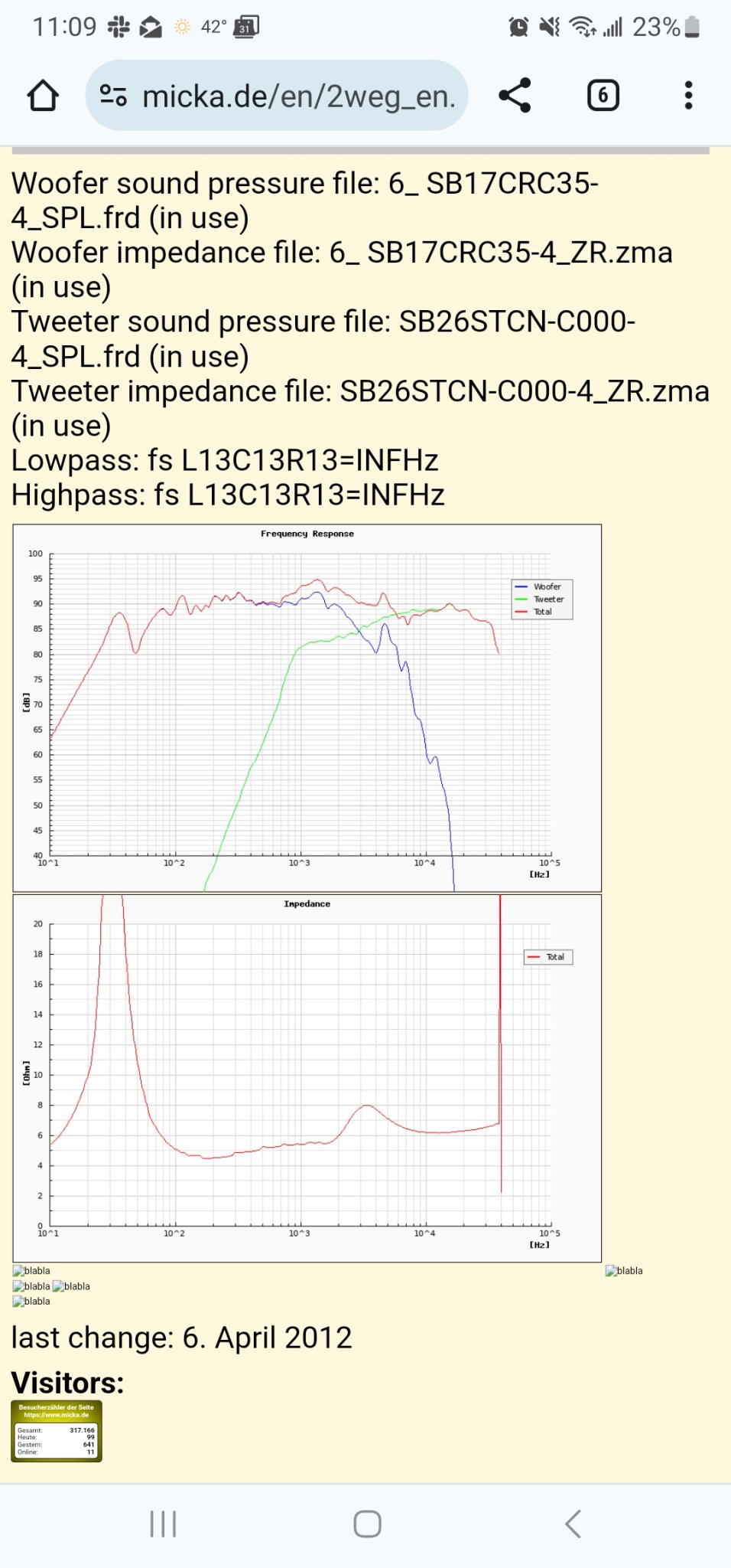

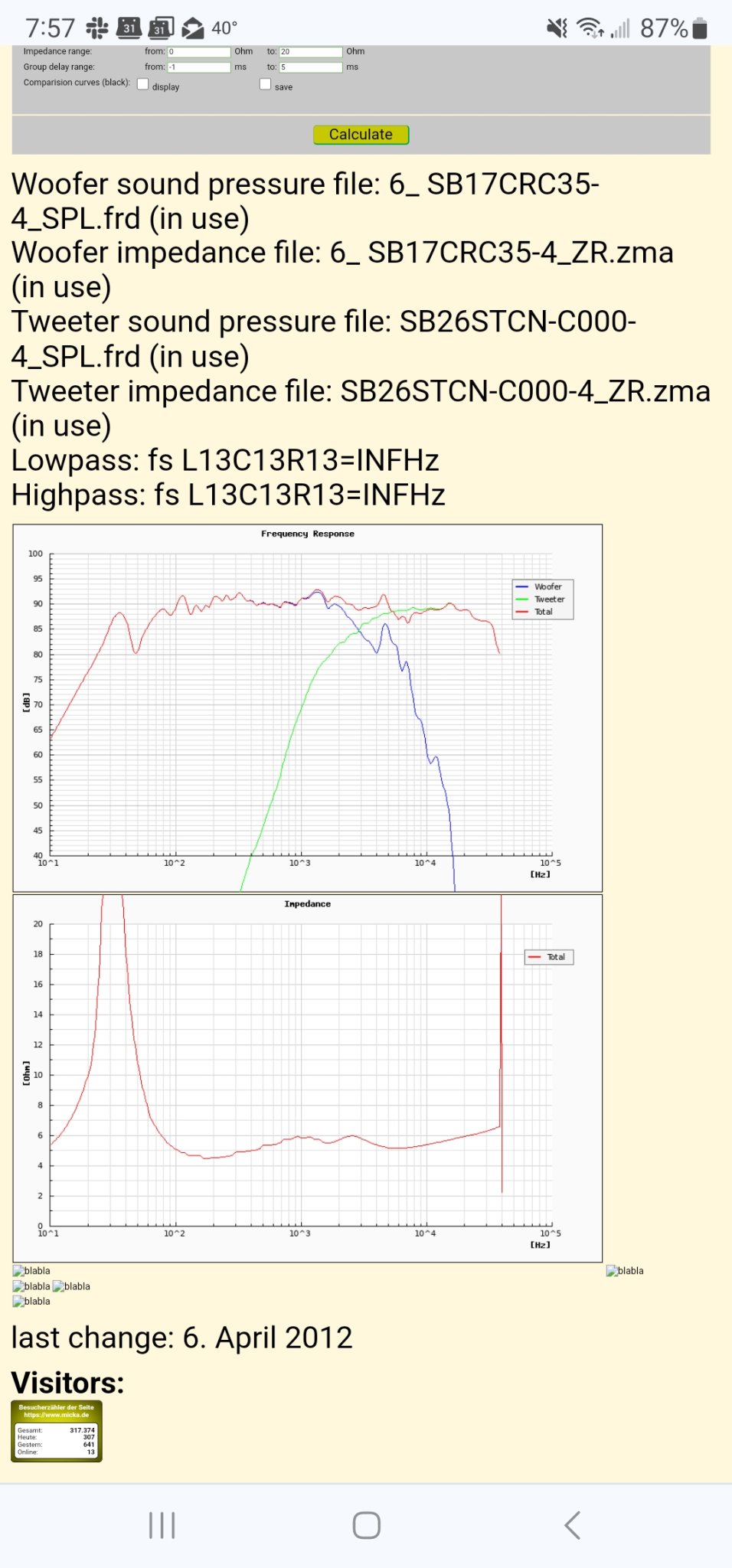

I have the SB26STCN 4ohm tweeter and SB17CRC carbon fiber 8ohm woofer in a small bookshelf setup, sealed box design of about 0.2cuft. I use the reference driver curves (frd/zma files I found online) and modeled a very simple crossover: just a 10uF and 2ohm resistor on the tweeter, and a 0.6mH and 10uF cap on the woofer. Tweeter is wired reverse polarity. No baffle step correction yet. I dont think I need it in my setup close to the wall.

I suspected that would be the case. Only played at low to mid volume so far, so minimal stress on the tweeter. Wanted to see what a first order slope sounded like.... Definitely nice at reasonable SPL.at least 2nd order electrical slope on the tweeter
perhaps not less than 2.5 kHz, maybe better 3k.
Unless I am misunderstanding crossover point, I am crossing in this range.
From the chart it appears that output for SB STC is only -10 dB down @1 kHz due to low slope of the filter. This means the tweeter will be receiving frequencies below it's recommended operating range, sugnificantly increasing distortion, lowering max. output power and inducing changing resistance due to heating of the voice coil(compression). It might become very apparent while playing loud when harmonics become high and sound is no longer clean and accurate.
