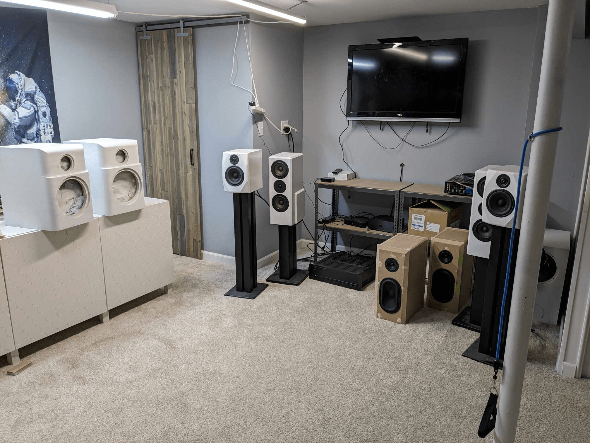

I used it in a WAW with the 10F in a build for a friend. I didn't spend a whole lot of time with the finished build but it had a nice amount of thump even in ~20L sealed. I'm doing another build with the 5x8 as the woofer in a 3way, 41.5L ported this time, but it's still a flat pack.

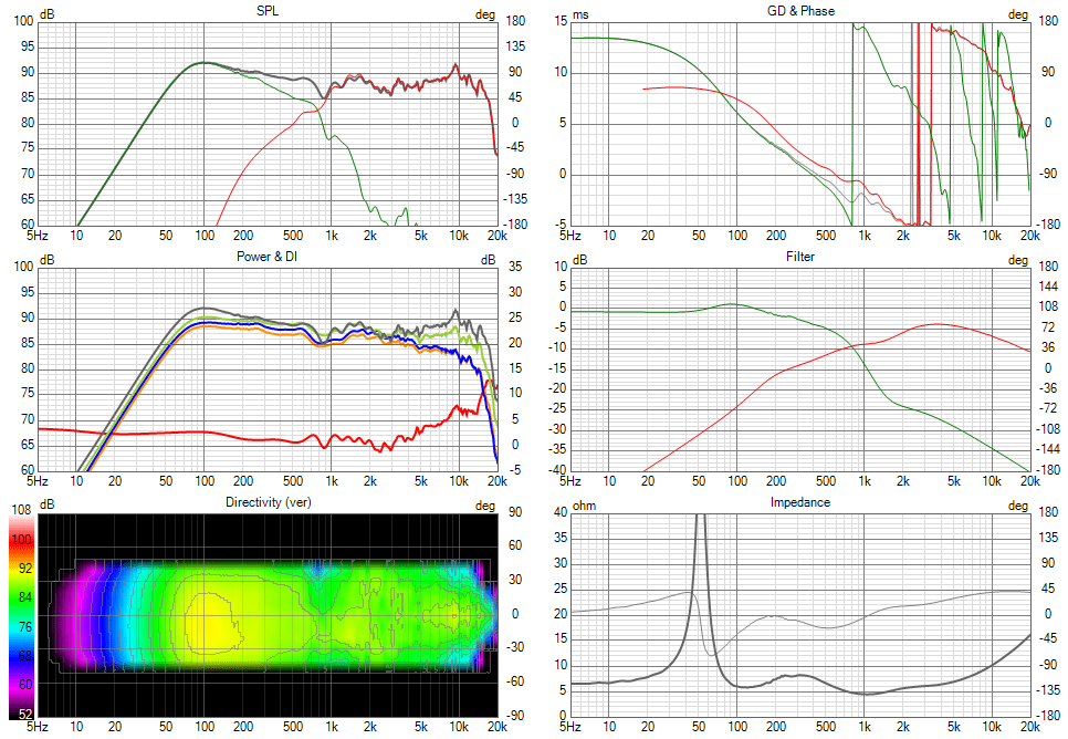

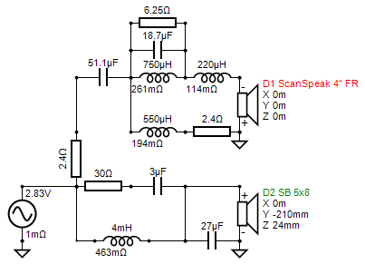

Below is the WAW design. I don't have any good pictures from the build. This is the best I had, long before they were done obviously.

Btw, I am envious of your collection of drivers in that picture to play with and compare. Are those Relevators? How did the 10F+SB5x8 compare in contrast to those other speakers?
Also, that is a very interesting crossover configuration. It will take me some time to mentally process what is going on there. Much more complex than a simple 2nd order Bessel/Butterworth/LR. I am still at the beginners stage for crossover design. What led you down this route, vs a simple 2nd order bessel?
Like I said, I didn't spend a whole lot of time with the finished WAW. I was kind of rushing to get them done before Christmas.
The Revelator line is great and you're not going to get that kind of performance out of the SB PFC line but the PFC drivers are killer for the money imo. By comparison the Revelators pull so much nuance out of source material and can multi-task really well.

The crossover is 2nd order acoustically, it started as LR2 at 600Hz and moved a little as I adjusted everything.
If you're just starting:
1 - When people talk about crossover slopes, they mean acoustic slopes not electrical slopes.
2 - The driver's responses look very different once they're on a baffle. The responses get peaky, especially in the 800-1200Hz range when the baffles are skinny. The crossover needs to deal with this.
3 - Impedance is not constant 4 or 8 ohms
4 - Because of 1-3 the crossover component values are not textbook values.

Thank you for the rest of your comment as well. Those points definitely help me think about my design. I really do need to order a measurement mic.
