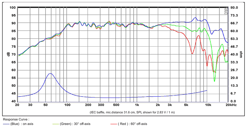

So we have the mid
attachment.php

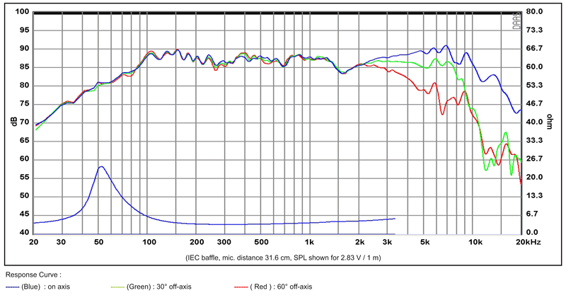

then we have the 4 ohm butyl surround midbass (which is the closest to the mid)
attachment.php

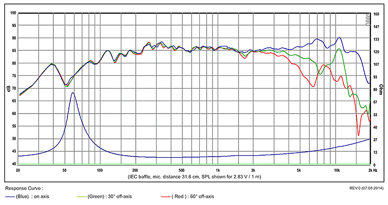

and the 8 ohm butyl surround midbass
attachment.php

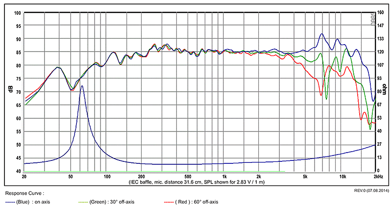

Then we have the 4 ohm foam surround midbass
attachment.php

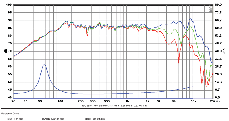

and finally the 8 ohm foam surround midbass
attachment.php
The 8" faom surround is arguably the smoothest in the range 200Hz to 3Khz
What I find interesting is that the four ohm versions seem to be a little more ragged than their 8 ohm equivalents.
SO. The question remains what is it that differentiates all of these options!! from a purly FR plot pov the 8 ohm foam looks the best but I guess this is where the tradeoffs come into play. longevity of foam is not so good. You may need the extra db that a four ohm version gives you.
If you do need the extra sensitivity of the four ohm and want butyl surround, then the MID to my eyes is actually the best choice 😉

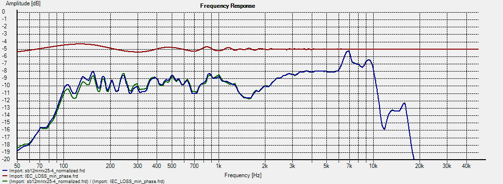

edit: actually one other thing is that these measurements were done on an IEC baffle and that DOES introduce some irregularities into the response compared to an infinite baffle. I think I have the corrected plot for the MID somewhere I'll see if I can find it and post it.
edit2: actually the difference was a lot less than I remembered. comparison below.
attachment.php
