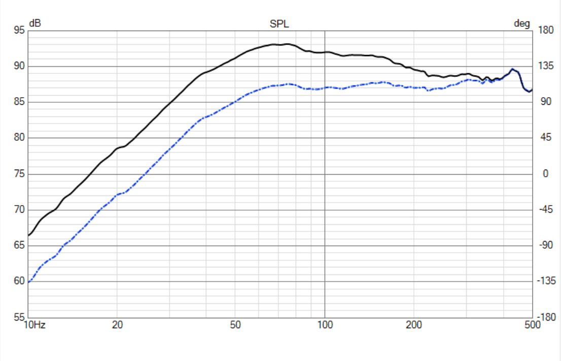

This may be of interest. Here is the near field measurement of an SB34NRX75-6 in a 70 liter sealed box. The solid black line is the un-altered near field, which represents a 2-pi half space response. The dash blue line is modified to represent the 4-pi full space response.
I use this driver as a woofer with a 200 Hz crossover. The NF response peaks at 75 Hz, and is about 5.5 dB higher than the 300 Hz level. This means the driver needs very little (or none) baffle step compensation. In my application, I apply some bass EQ to get a flat response down to 30 Hz.

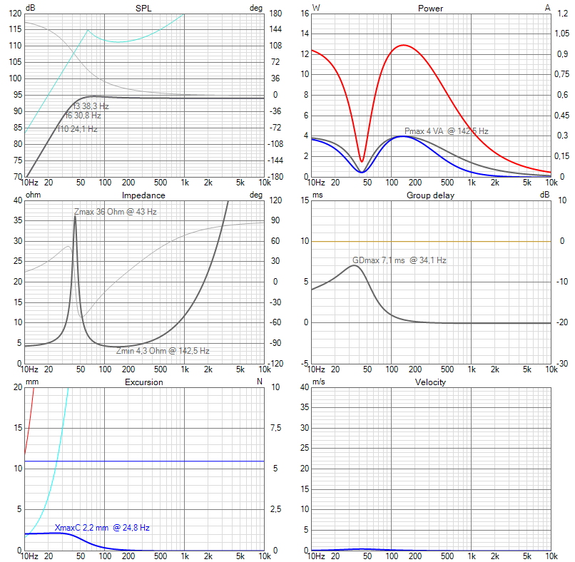

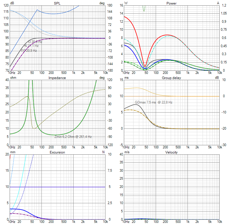

Yes specs/features mentions that, but did you try simulate it in sealed?Unfortunately SB34NRX75L-8 is not designed for sealed but for BR or Transmission line
Here is simple sim in 60 sealed with/without light Linkwitz transform. At 95dB with LT still 10dB headroom.
(If my sim in VCad is right)
The Non L version in same 60 Liter without LT (changed input power a little to show same SPL)

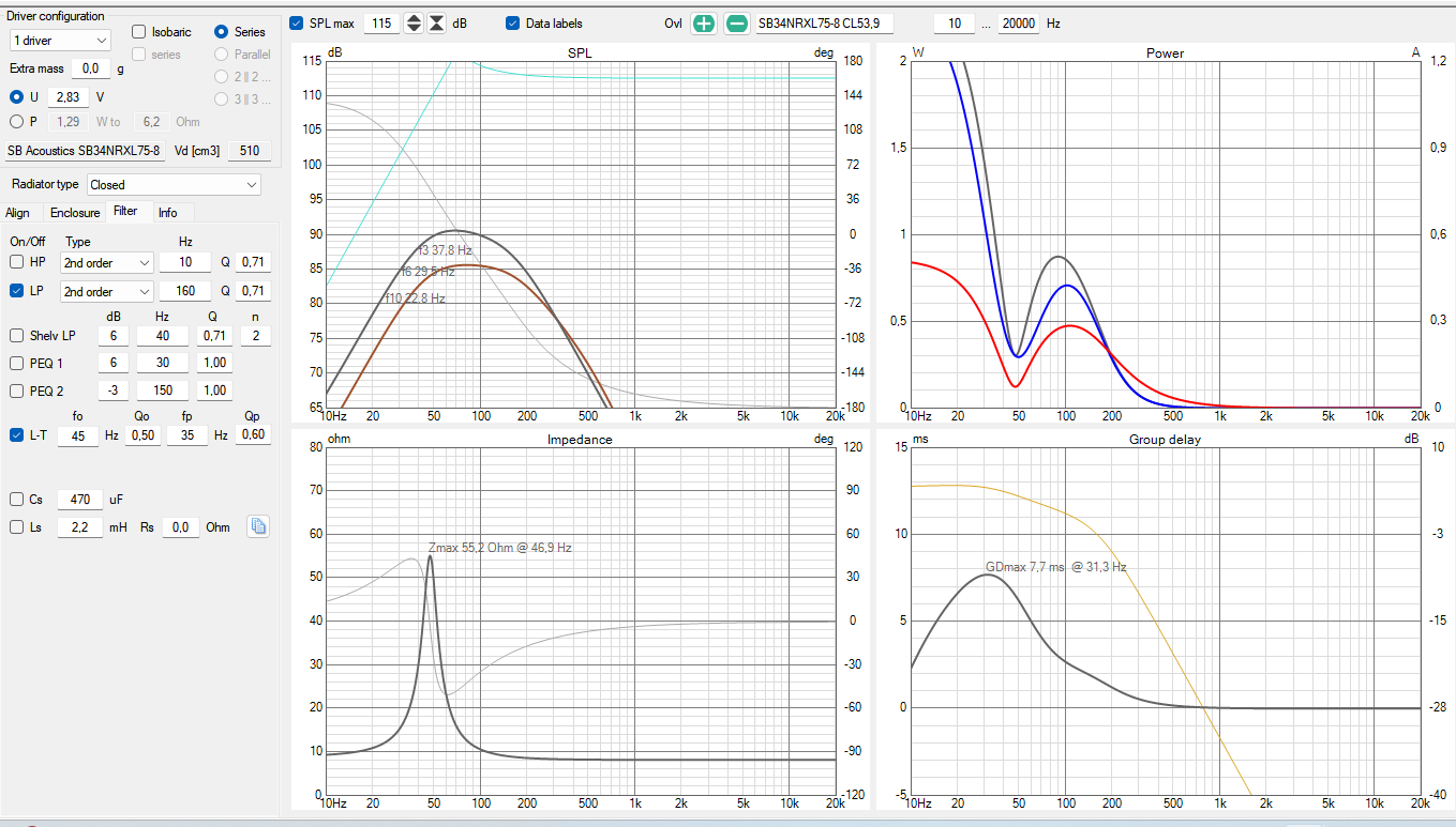

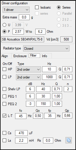

Here if I take the same LT than @Rokytheman in 57l ( qtc 0.58 ) for the L version plus a low pass 12 dB around 250 hz acoustical (-6dB). show the impedance selected.
in 4Pi space : the max spl at 2.83V is 85.6 dB (numbers on the graph are the brown 4Pi curve).
