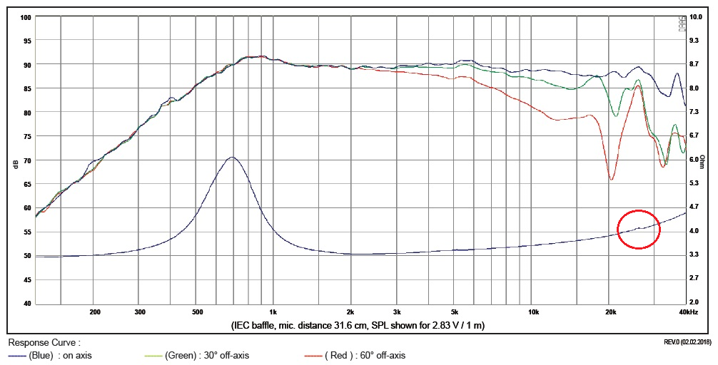

That anodised (ceramic...) SB metal dome is remarkable:
SB Acoustics :: SB26CDC-C000-4
They've got rid of the usual huge peak around supersonic 25kHz. How did they do that?

The off-axis and Z plot reveals some break-up, although if the ceramic helps about harmonic multiplication, will be good.
I have built a project with the aluminium version, and the harmonic multiplication is basically a non-issue, lower than most metal domes I've measured. Perhaps the ceramic is even better.

Any significant resonances would show up either on the on-axis or off-axis frequency response, but nothing I've seen so far on this tweeter indicates any major high-frequency problems. The frequency responses, step response, and waterfall all look good.If so, it might show up as risidual energy?
SB Acoustics SB26ADC-C000-4 | HiFiCompass
If I had to point something out, there's a moderate-Q peak around 18kHz from 30 degrees and outwards, but that's hovering around the realm of audibility for most people anyway.

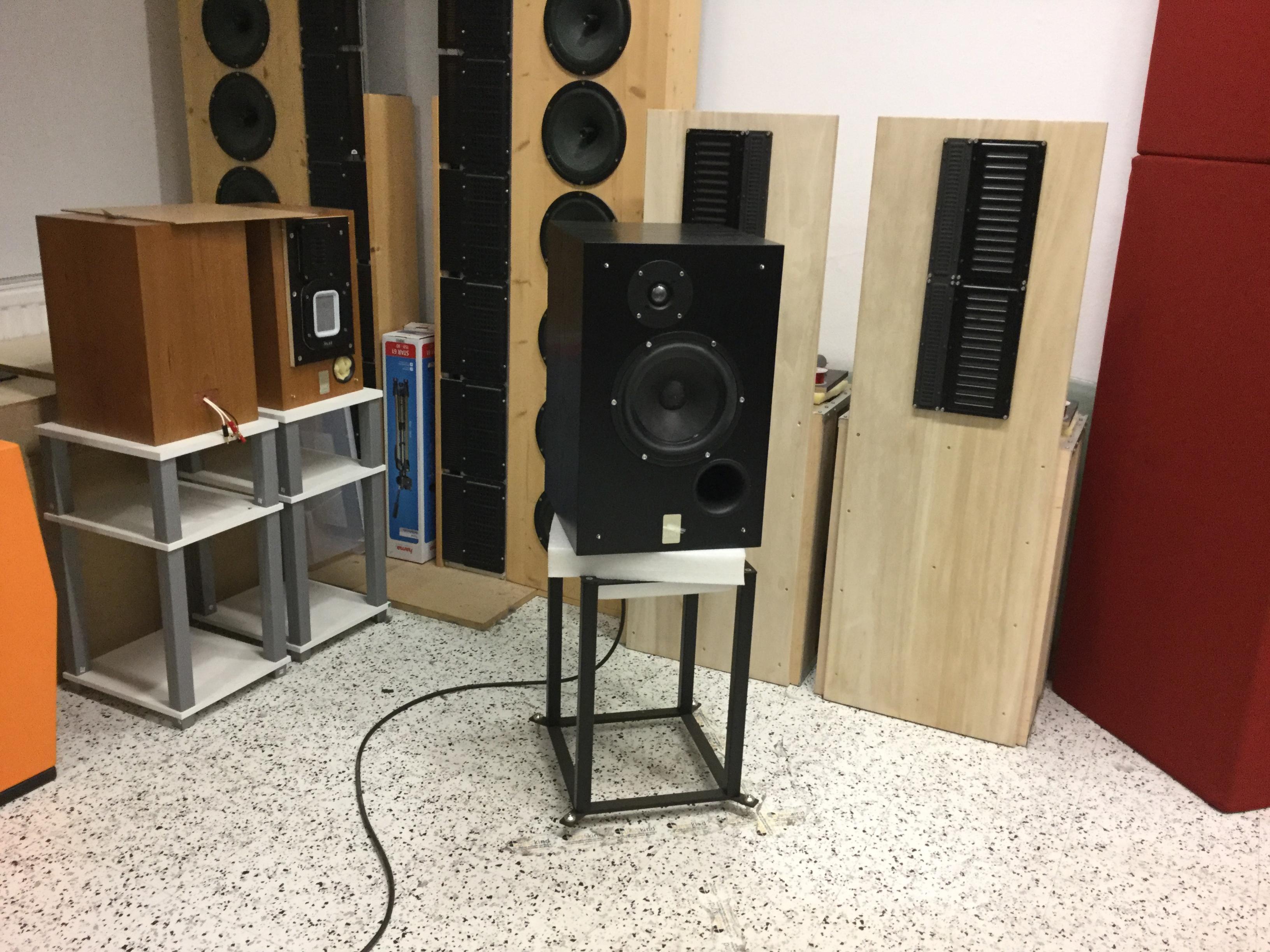

Those woofer cones look a lot like some woofers I fished out a Procus Infidibus a while ago....<picture of speaker>
Can you tell me more about yours?

Those look slightly different from what I believe are Elac units here:
The 8" Elacs are 1" cardboard voicecoil former and rubber dustcaps with small magnet.

Joachim Gerhard is always willing to have a go at the 8" plus 1" idea, here in the Arkadia 2:

Back on-topic, I think that SB metal tweeter is cleverly engineered on-axis by the phase plate, but the 25kHz breakup is still there. They've moved it off-axis.

The breakup in the ADC and CDC shows up clearly in my measurements, with or without the phase shield: SB Acoustics SB26 | somasonus. It's also clear from the manufacturer's info, excepting the on-axis of the CDC, I believe that data might be in error.

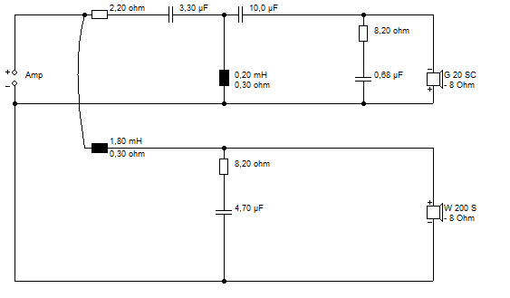

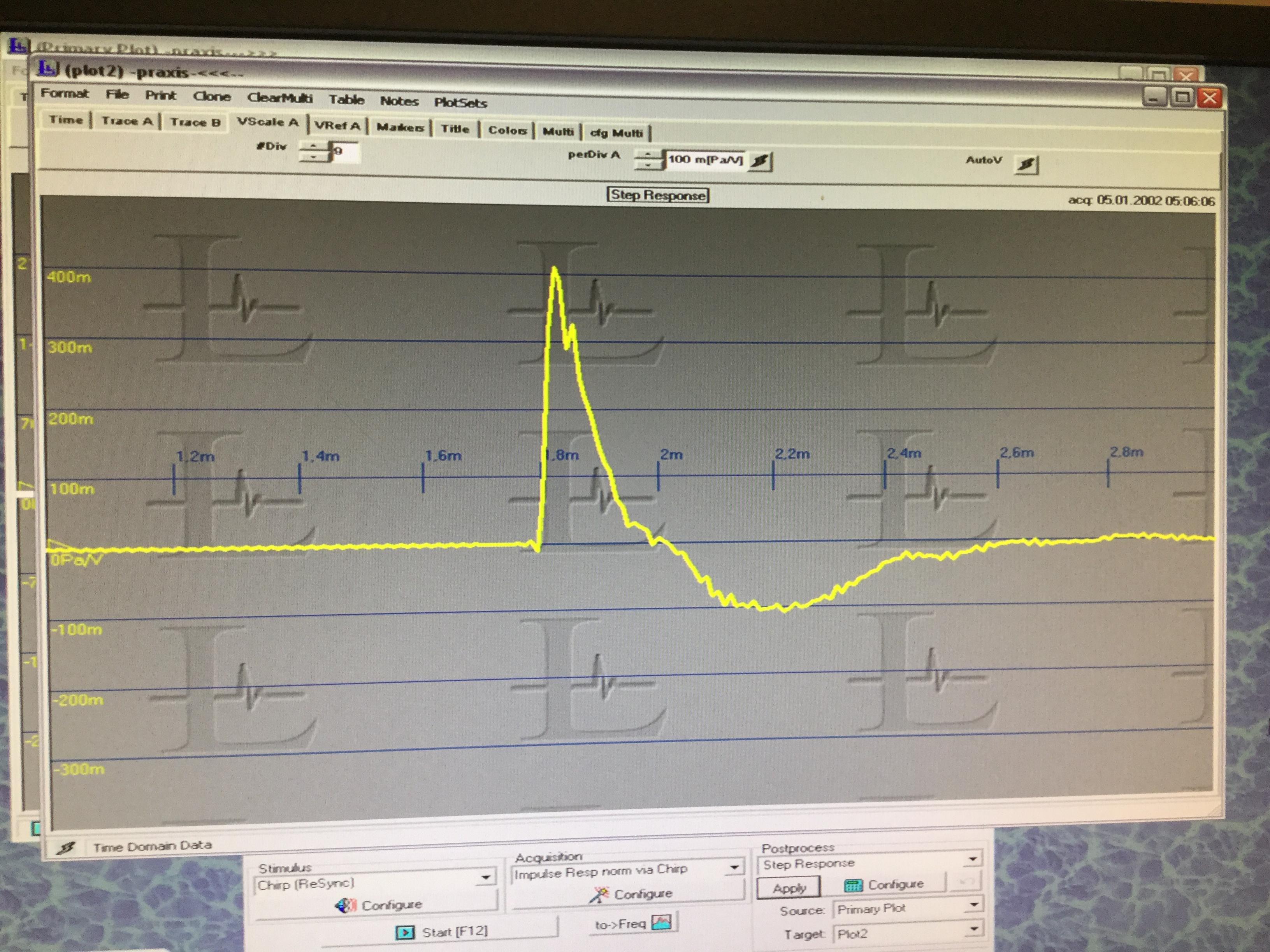

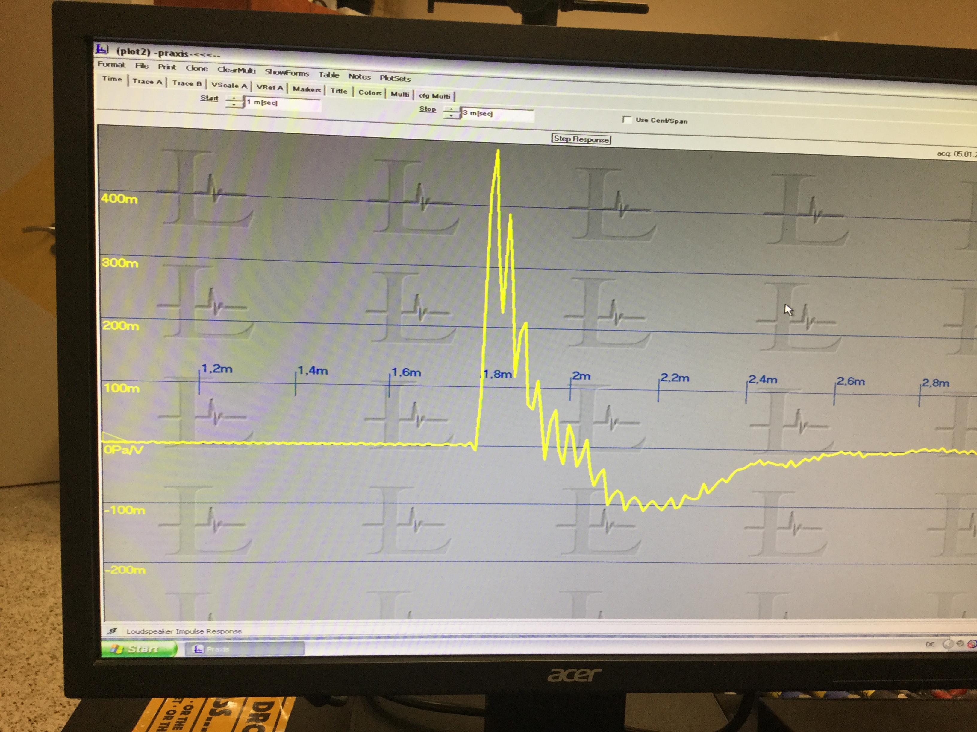

He has actually tried notching out the metal resonance, around 25-27kHz with an LCR:
Before:
After:
I have deliberately kept the images small. Look up the thread for more. It is easy to say that something above human hearing can have no effect. But that assumes amplifiers aren't struggling to deal with a huge high level, high frequency resonance.
My opinion is that they run out of steam with controlling this sort of load. And hence tend to gross distortion lower down. But I really don't know. 😕

Visaton KE25 is one of those commercially available tweeters that employ a notch at resonance frequency.

I was under the impression that the rather exotic and expensive ceramic Visaton KE 25 SC had a built-in Fs resonance LCR notch around a low 800Hz.
