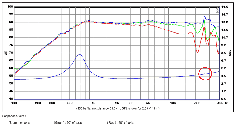

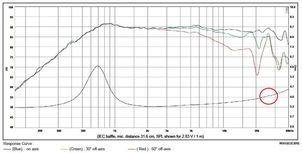

What is interesting is how the oxidizing of the ADC pushed the resonance higher and decreased its magnitude as the mms remains the same. Al2O3 should have some internal damping or I miss something.
In both tweeters break-up is visible in the same place on the impedance.

Yes, but it doesn`t look so bad (I mean, the ADC doesn`t look bad either) with the ceramic version in the frequency response.
- SB26ADC compared to SB29RDC
