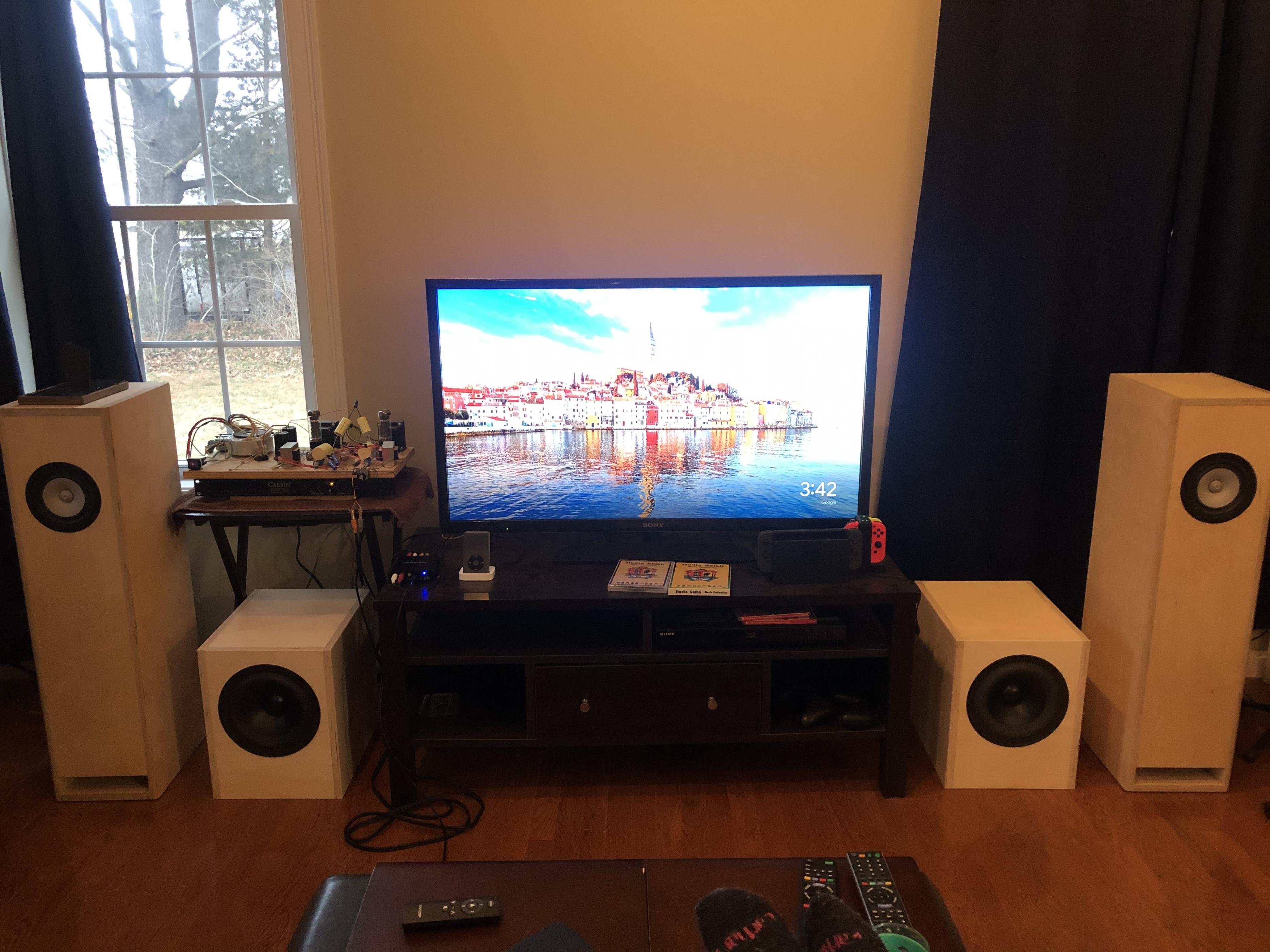

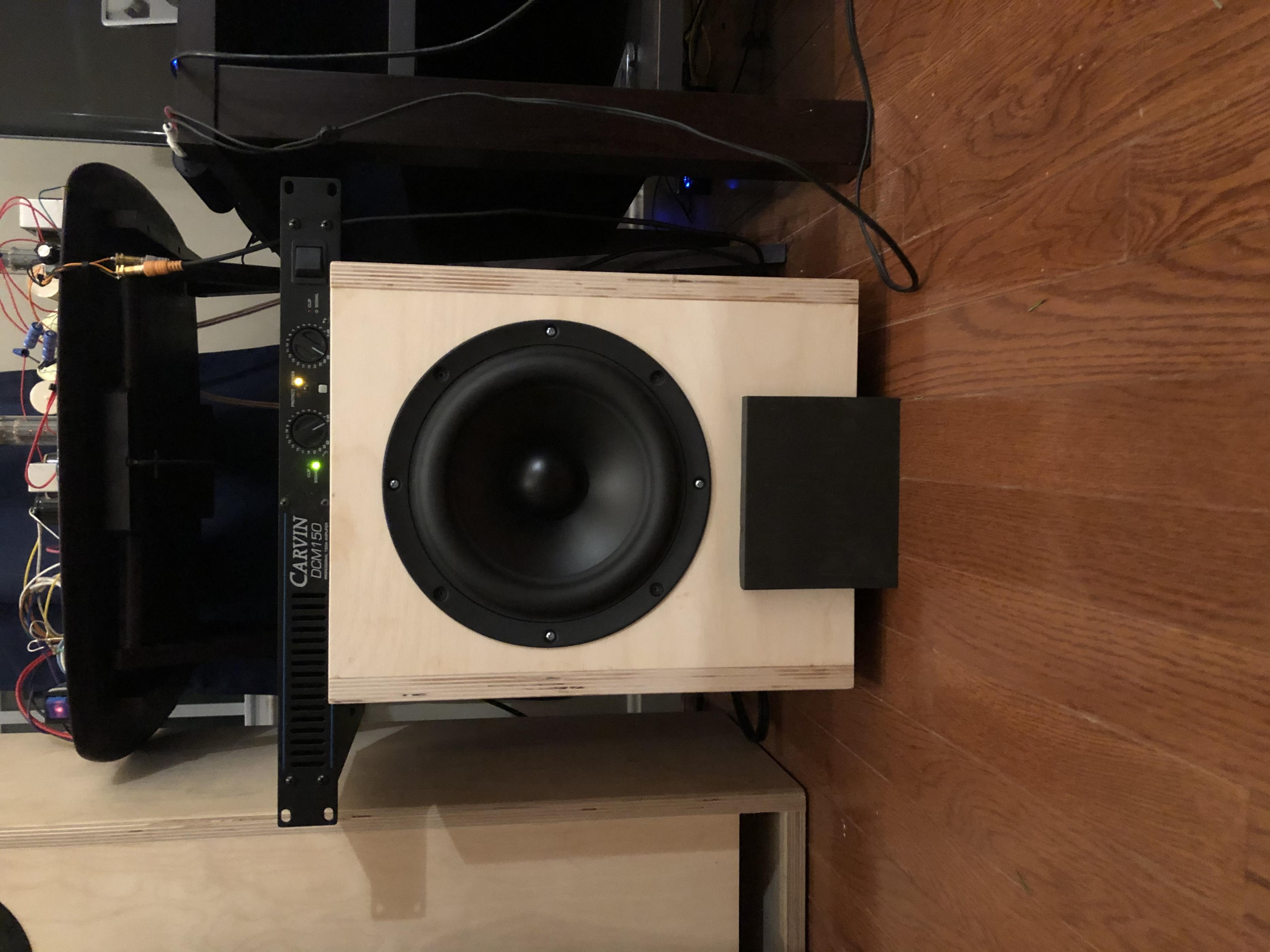

A couple pictures in the living room. The pads are some packing foam I found to keep from scratching the floor until rubber feet are added.

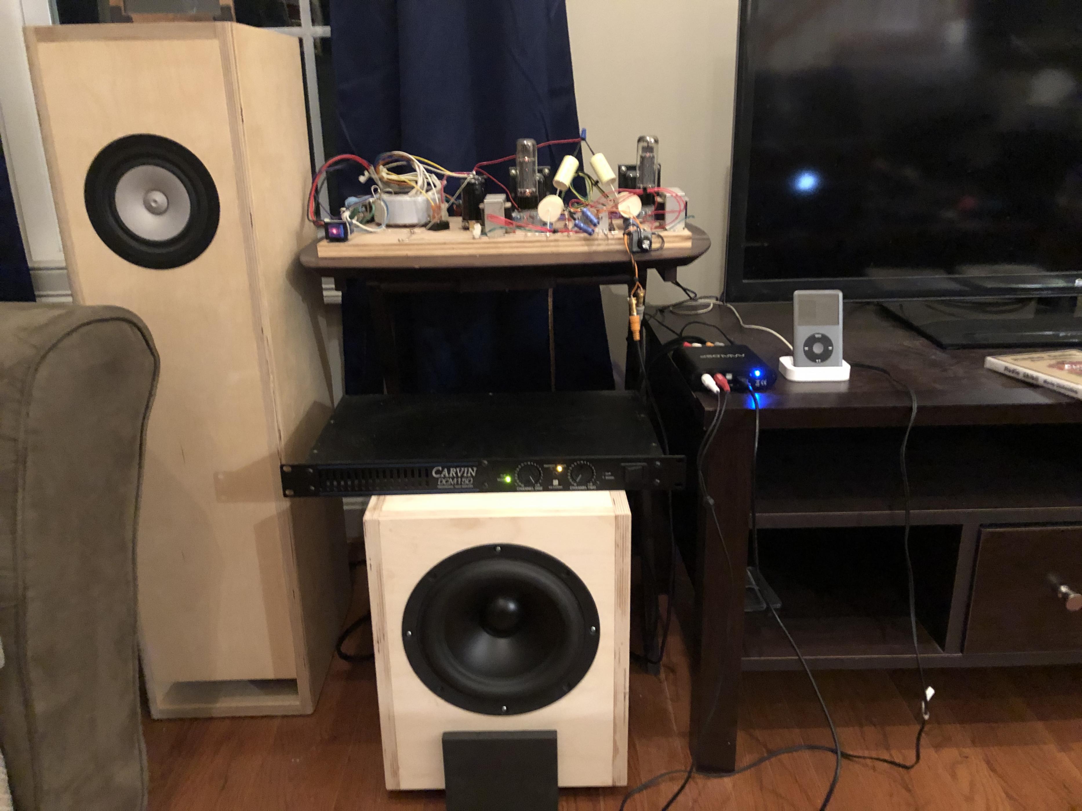

Somehow I managed to give myself more trouble building the second box but by the power of the orbital sander they both look kinda nice. No clue how to properly finish them though. If the towers are any indication this project might be done 😀
Doubling the cone area definitely adds authority to the low end.
