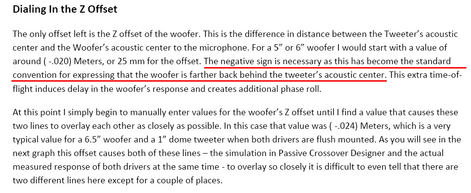

BTW, Regarding phase calculation, I have extracted from Bagby's paper
"Finding the Relative Acoustic Offset in PCD" and the "Instructions
in PCD" on how to define the Z offset, and now it looks as if there is
a discrepancy between the two. Do I conclude correctly that the
PCD Instructions are misleading or am I misinterpreting things?
I know for sure that Z offset in PCD has to be entered with a negative
sign if you want to present the woofer voicer coil being behind
the tweeter's voice coil.

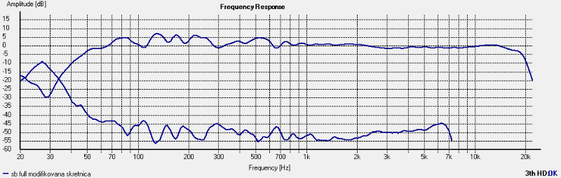

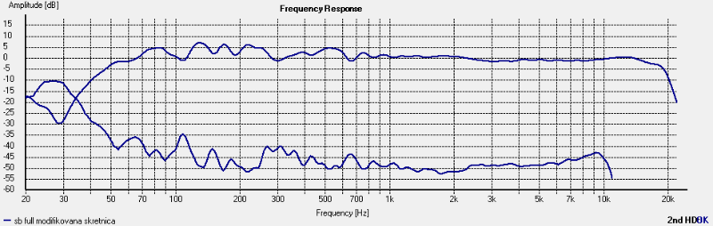

Few final touches and xover point ended up at~1650Hz. I wanted to see if i stressed them too much with low xover point so i measured distortion. Here are few distortion measurements - HD2 and HD3.
These are very good drivers as expected. It is very hard to find drivers of this quality in Europe for much more money, but at these prices, SB is a bargain. I just hope they don't change their company policy.

Line,
sign if you want to present the woofer voicer coil being behind....
Earlier versions of PCD did use a positive offset. I think the instructions didn't get updated when PCD was changed to use negative offsets.
