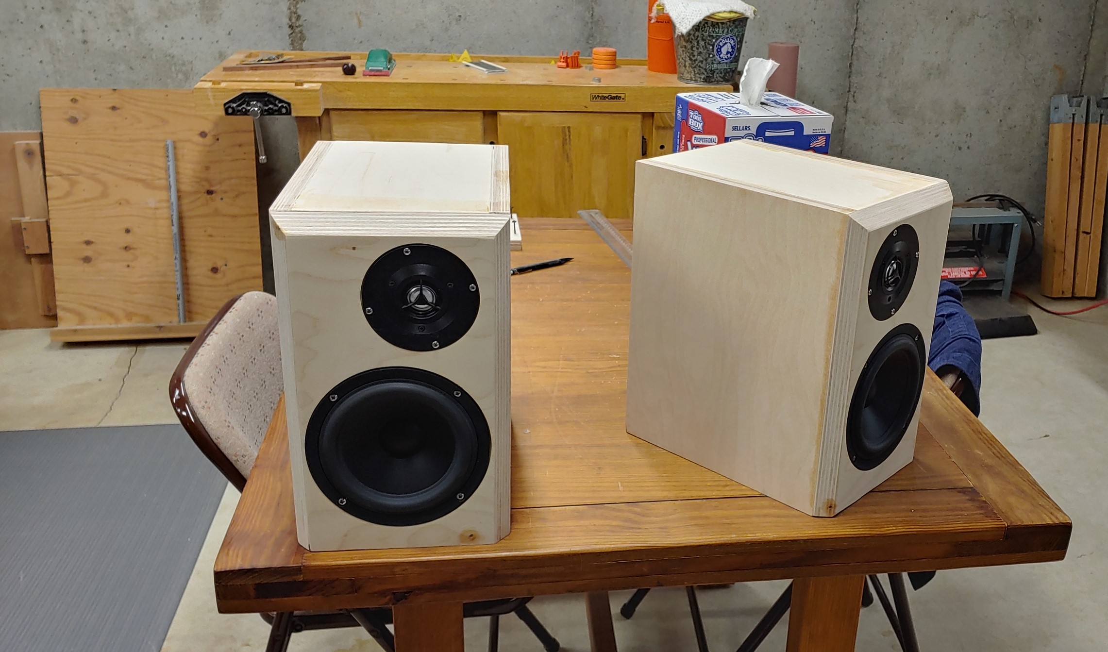

Just a different perspective... I used an SB17MFC35-8 in a small sealed box 2-way last summer... I find the bass to be articulate and punchy. Of course I do not expect high SPL, and I do not expect much response below 45 Hz.
I have never liked the sound of small vented boxes, no matter what driver is used. I think it is the high tuning frequency... if the vented box tuning frequency is greater than 30 Hz, I am not going to like it...
