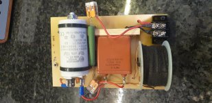

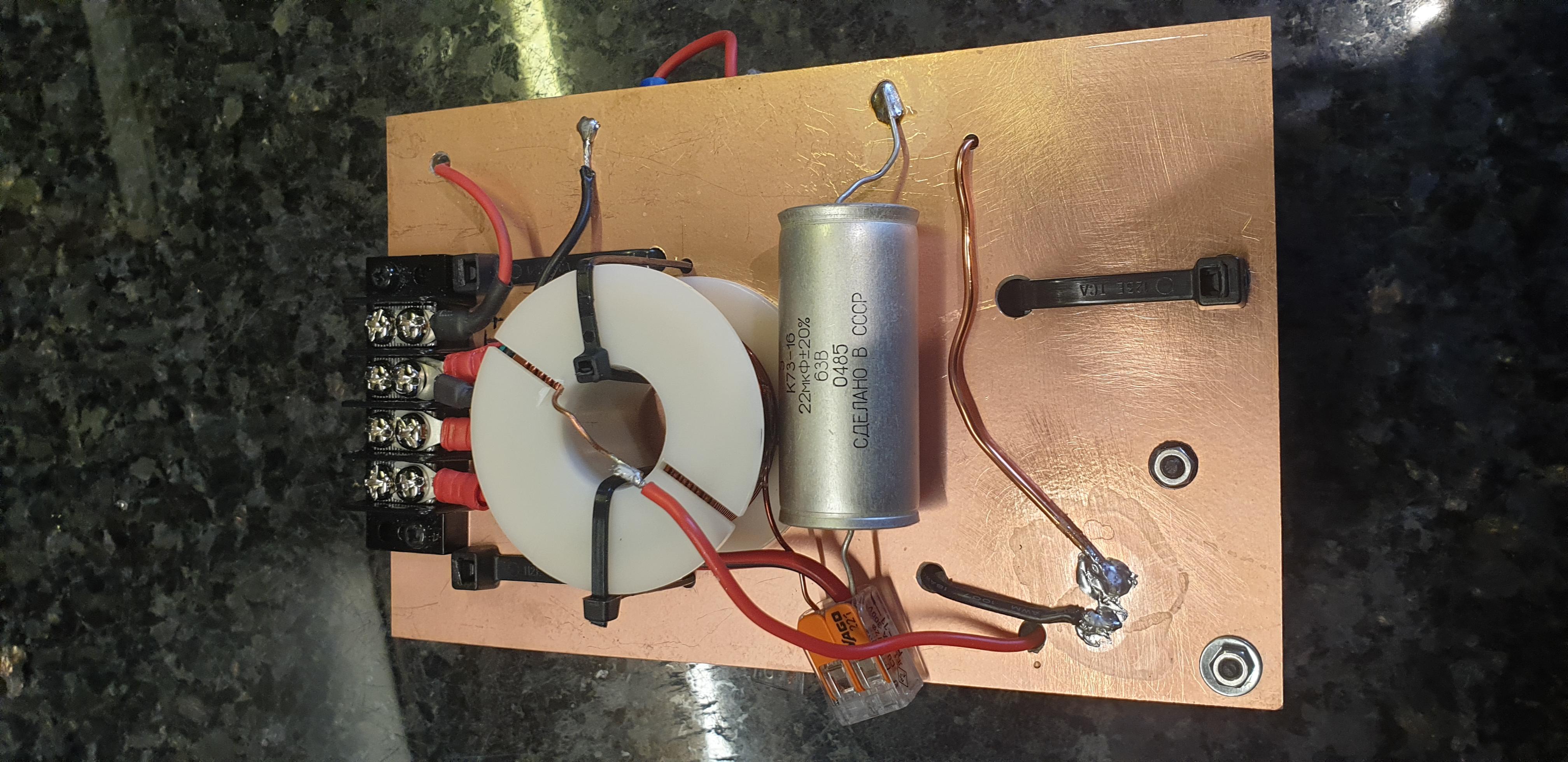

I got the new XOs in yesterday. Wow what a change
...for the better. No measurements I'm afraid. Thay 5k rise i had I guess is gone as the bass is much more prominent. Using the 4r7 pad on the tweeter at the moment. I may try the 3r3 for a little brighter presentation but I'll give them some more hours first.

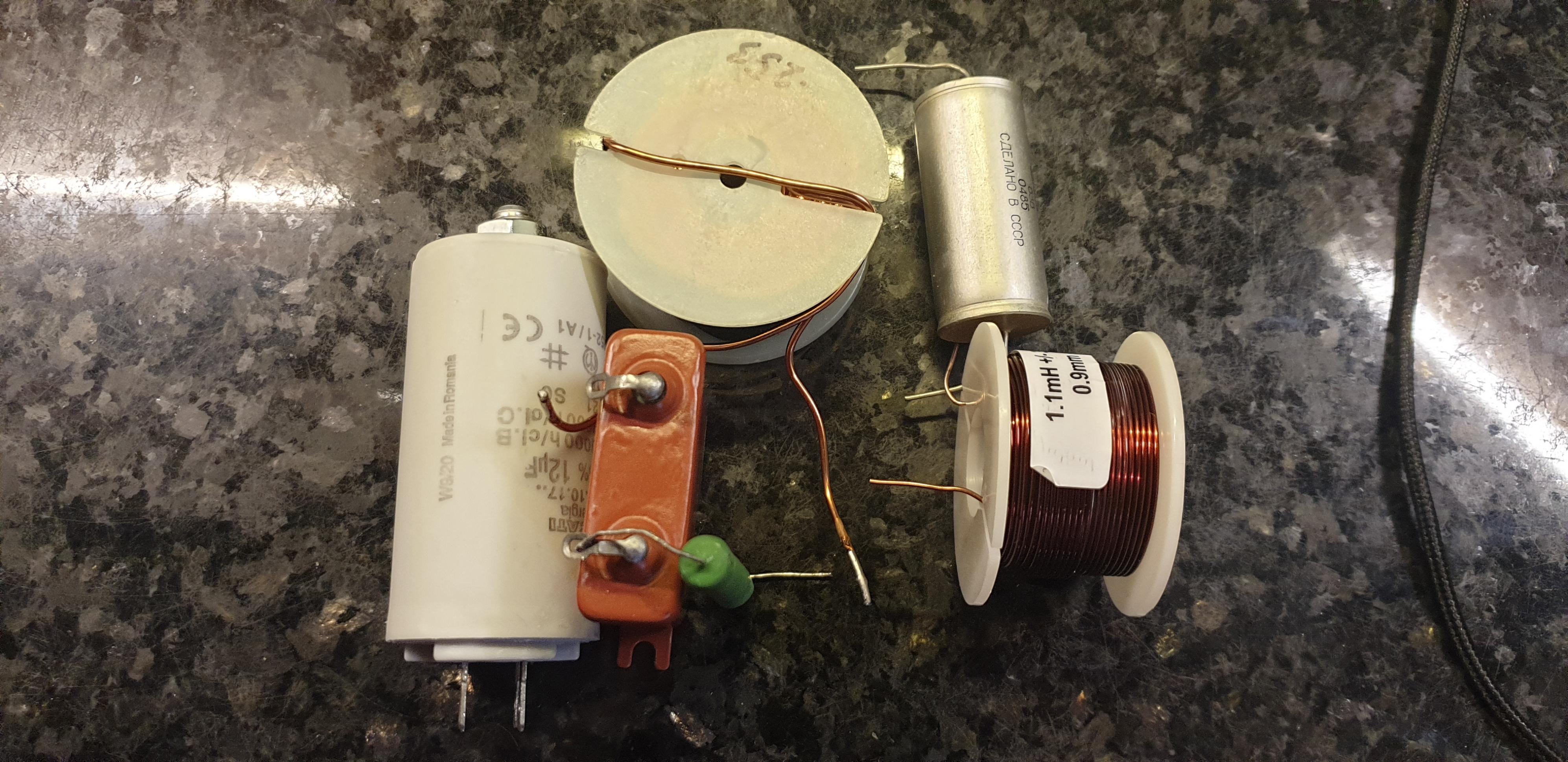

I also have some 0.01uf PP caps. I understand that these sorts of caps are used as bypasses on larger vakue caps. Should I try them on all the caps in my XO or just particular ones? I realsise this may give subjective results but I wondered if there was a rule of thumb where to add these bypasses.

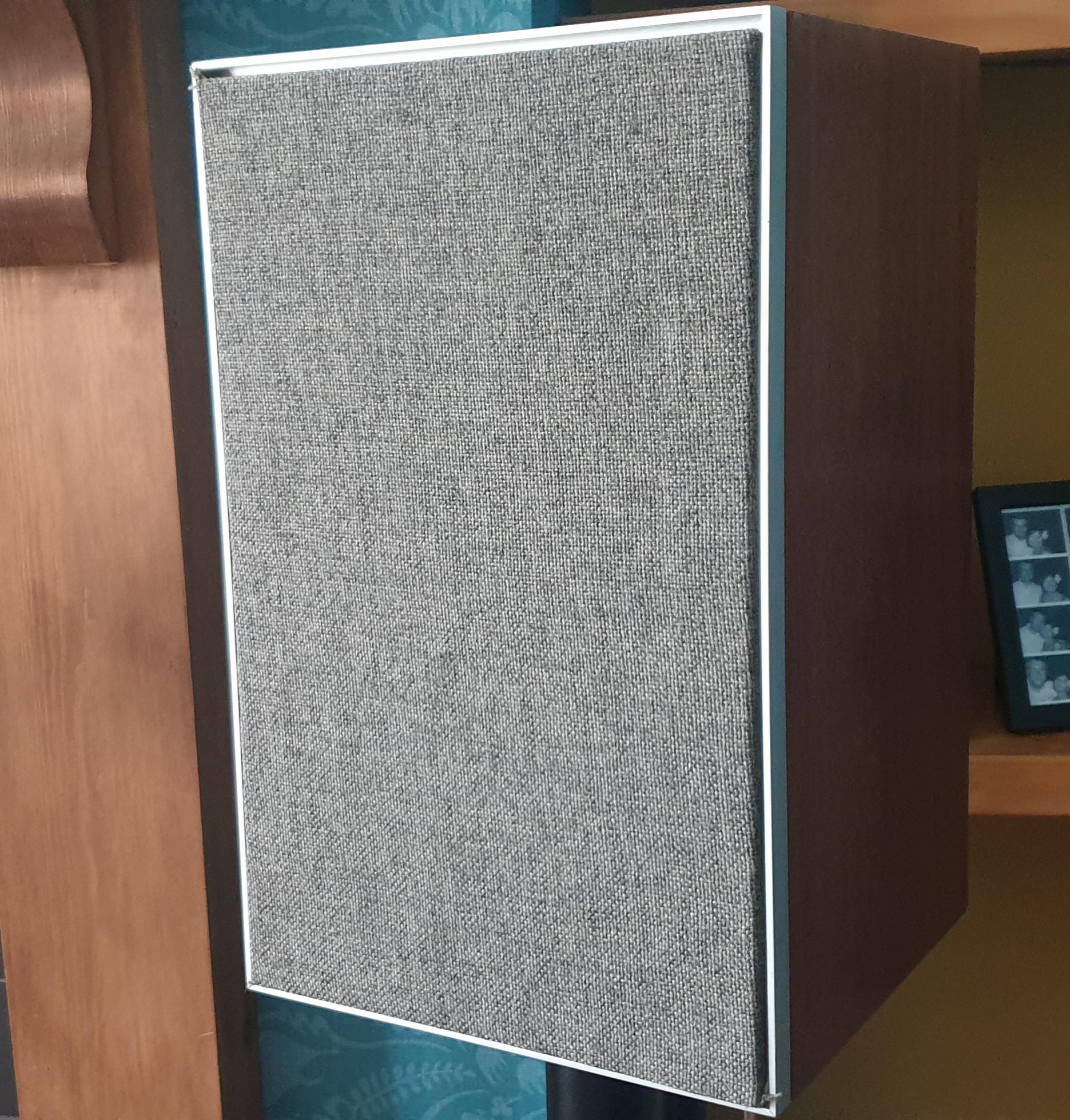

On the baffle...I could always lose the aluminium trim and see if that changes things....even add a roundover on the edges and forego the grilles/WAF. And this has just spiked a curiosity in my brian.....grilles.....I haven't tried them for any length of time with them removed.

In hindsight, it would've been worthwhile to measure the response curves with the grilles in place. Don't forgo WAF just yet, but if the grilles are a typical 1/4" MDF frame with fabric, you've got space to add more felt without impinging on the outer look.
It could well be that the grille fabric is killing off some of the high treble, so playing with the bypass cap is where I'd start first.

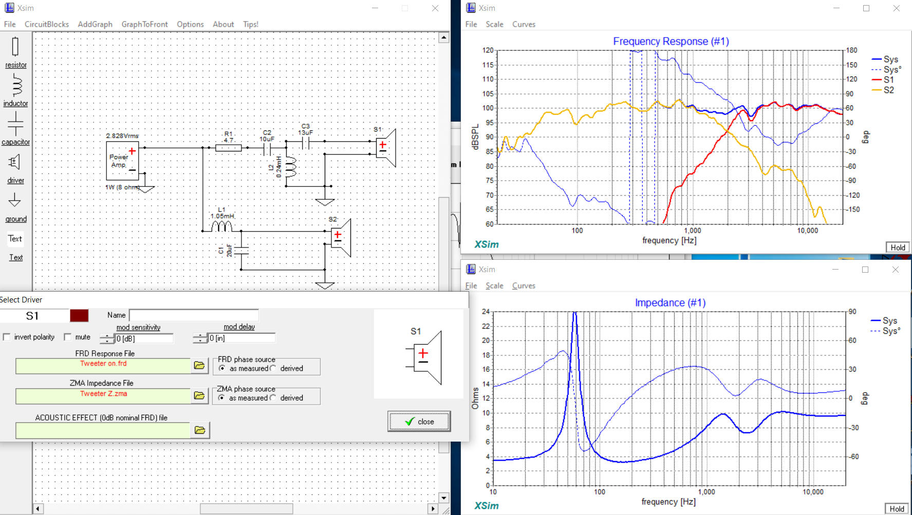

Definitely a 1uf i added into the HF circuit. XSIM shows it just adding the slightest lift above 10k. Maybe I try a slightly larger value.
I tried adding an 'ambience' tweeter into XSIM. Just picking a cheap Dayton Audio job as the frd and zma are readily available....just out of interest. I added the 60 off axis files although they would be more like 180. It does lower the overall system impedance to 3 ohms ish above 10k. Is that too low.? I realise there isn't much power in that frequency range.
Just sat down to listen to them sans grilles.!
Well, caps add in value as you put more in parallel. Grab a couple of 0.47uF per side, connect them at one end and then twist the wires together at the other to make the connection. Easy to add one at a time, switch out, etc.
3ohm at 10kHz will be fine.

I'm thinking that the 'acoustically transparent' grille material is filtering down the HF a bit. Definitely a bit brighter with them off. Perhaps not a surprise.!
Didn't transform them but interesting nonetheless. Pity they look a bit of a pig without them! I may redo the baffle and make it 'pretty ' so as to get away grilleless and then I can recess drivers properly and roundover the edges. ( I have a router circle jig now so can do decent rebates.)

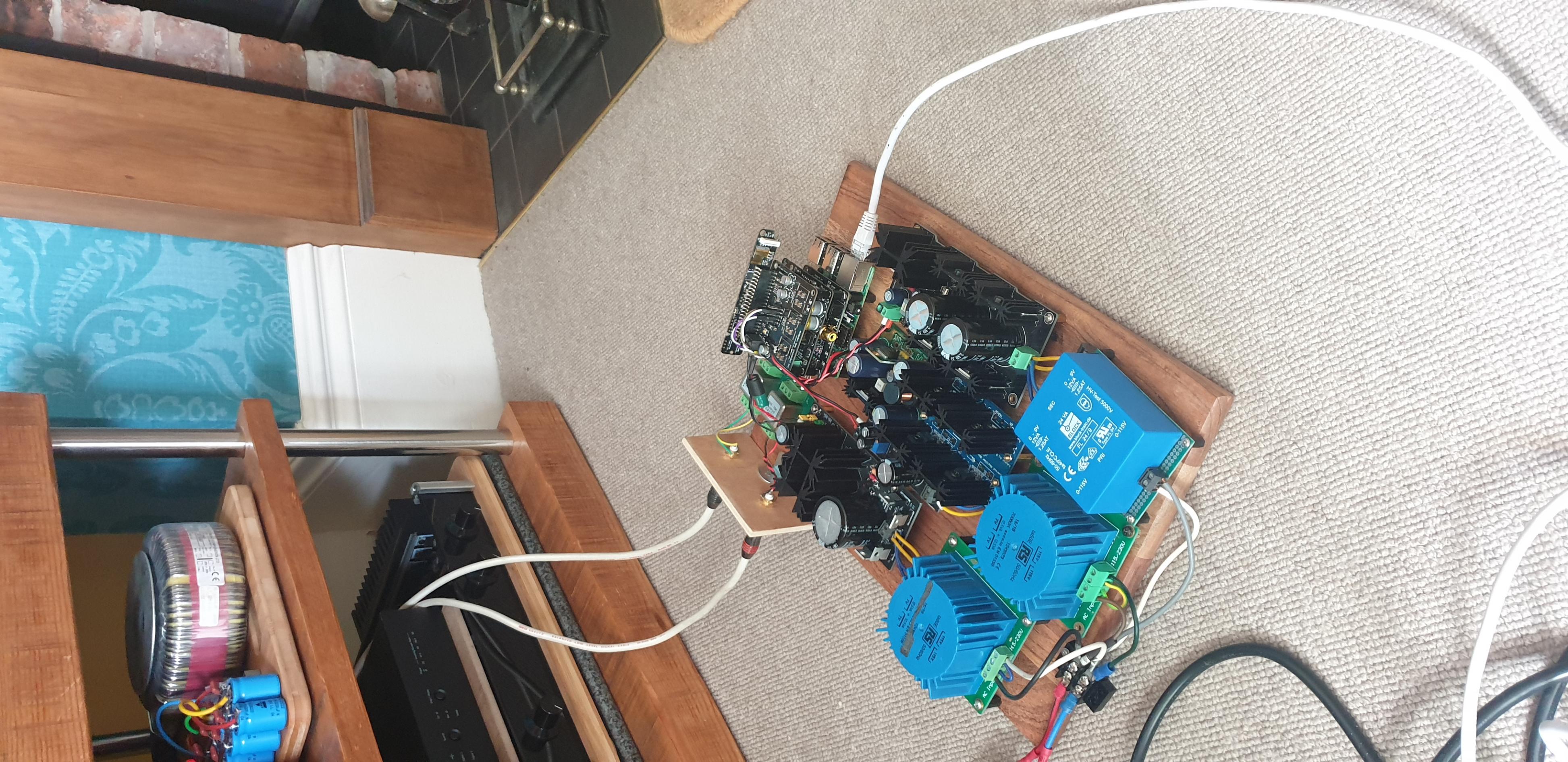

A long time later and I plugged these back into the system ....now with a class a 30w NP design amp. NOW they sound really good! Maybe a system synergy thing but all my previous doubts about them seem to have vanished. Maybe they want some current up them, but they are quite sensitive. Maybe the low impedance (4r woofer/6r tweeter) .?!
