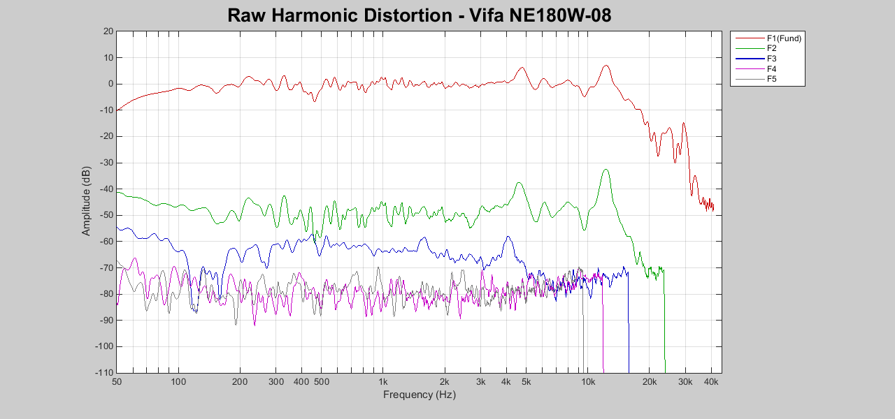

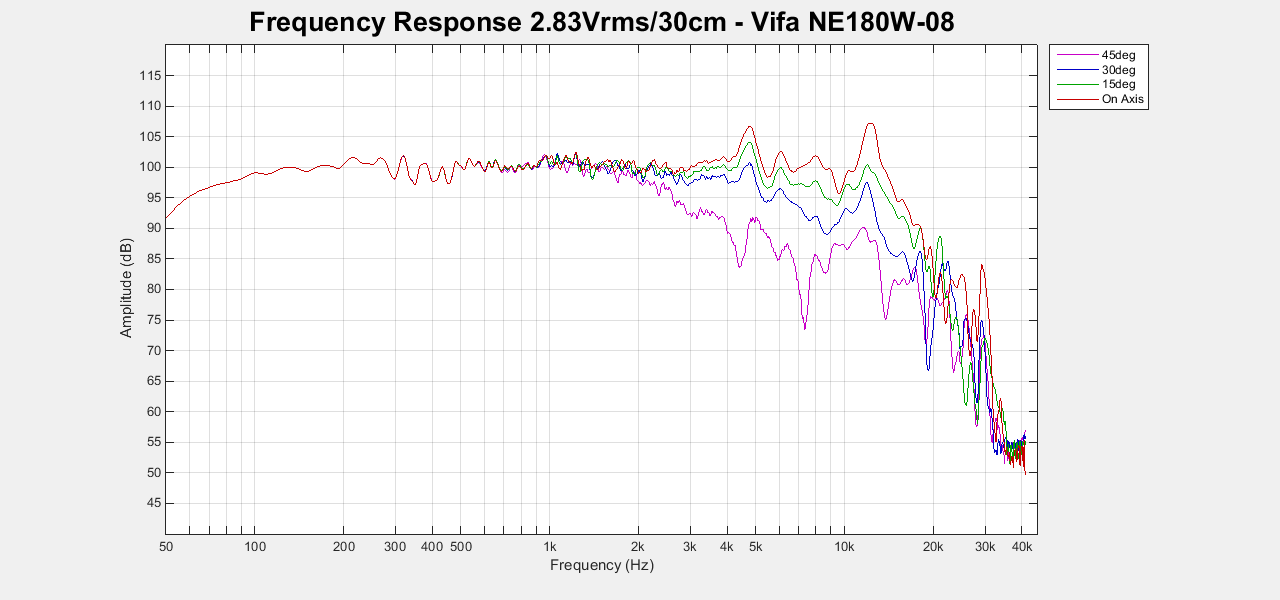

The NE180W-08 is a fantastic driver. IMO likely the best overall 7" paper cone driver you can buy for under 150 bucks. The FR measurements I've done are much smoother than production measurements published by the manufacturer. It does need a 4.8k notch in most cases if you want to use a 2nd order LP. In a 3 way system, it will keep up with 89 - 90 dB/W LF and HF drivers if you take mid band crossover summing gain into account.
I typically use this driver as a mid in larger 3way designs. It handles alot of power and doesn't exhibit much power compression like other smaller VC drivers. The basket will get warm to the touch running it hard but never gets hot. This is at 110 dB C weighted playback levels and 200 Hz LR12 HP, midfield in a 200 sq ft room. In a 2 way ported bookshelf design, it has amazing low end capabilities and will also play impressively loud at low THD. It works well together with the Morel CAT378 as a small nearfield monitor crossed over at 2200 Hz LR12.

This one looks fairly easy. I don't have the drivers to measure and can't comment too much. One thing the SB26ADC/CDC has falling response from 4-5kHz towards crossover point, peaking around 5-6k and seems like reducing the Vifa's 4.8kHz break-up would be a very good idea (RLC tank) if possible.

Any time you alter the parallel cap value of a 2nd order LP filter away from the ideal, you will get some form of peaking in your response. You will need an LCR notch to reliably remove the 4.8k woofer breakup peak. Without the LCR, you can hear that peak on axis at higher listening levels even with a relatively low 2nd order filter and especially with a very good tweeter that has low THD.
I have experimented with coatings on the NE180 and realized most of the upper mid breakup comes from the dust cap. A thin coating of silicone reduces the 4.8k area peaking by a few dB, perhaps enough to omit the LCR notch. Does it hurt the overall character of the driver? Not to my ears, but you still have alot of that hash left from the cone itself, so its not a worthwhile mod IMO considering the risks of going too far with the coating.
profiguy thanks for the silicon coating idea, just something to consider. Many hard paper cone like mentioned Vifa, SB have this hash or noise to it. Actually I don't know if I would want the LR2 with NE180. LR4 around 2k wouldn't be no problem - it should provide enough attenuation to make the break ups less noticeable. Generally not to many 6-7" midbass drivers and tweeters can be safely mated with LR2 filtering. I tried some simple modeling based on data published by Zaph (NE180W-4) and LR4 seems to do the trick, but for LR2 I would like to have one measured in the actual enclosure to say something useful.
I understand your point. I like the way LR2 combines with the HF. It just sounds a bit more natural to me and is the best compromise between phase shift and off axis summing behavior.
I've also discovered a small resonance issue in the motor system rear vent. There isn't much you can do about that, unless you want to compromise VC venting. This woofer is also very sensitive to enclosure dampening, specifically where its placed behind the driver and what kind of material is used.
