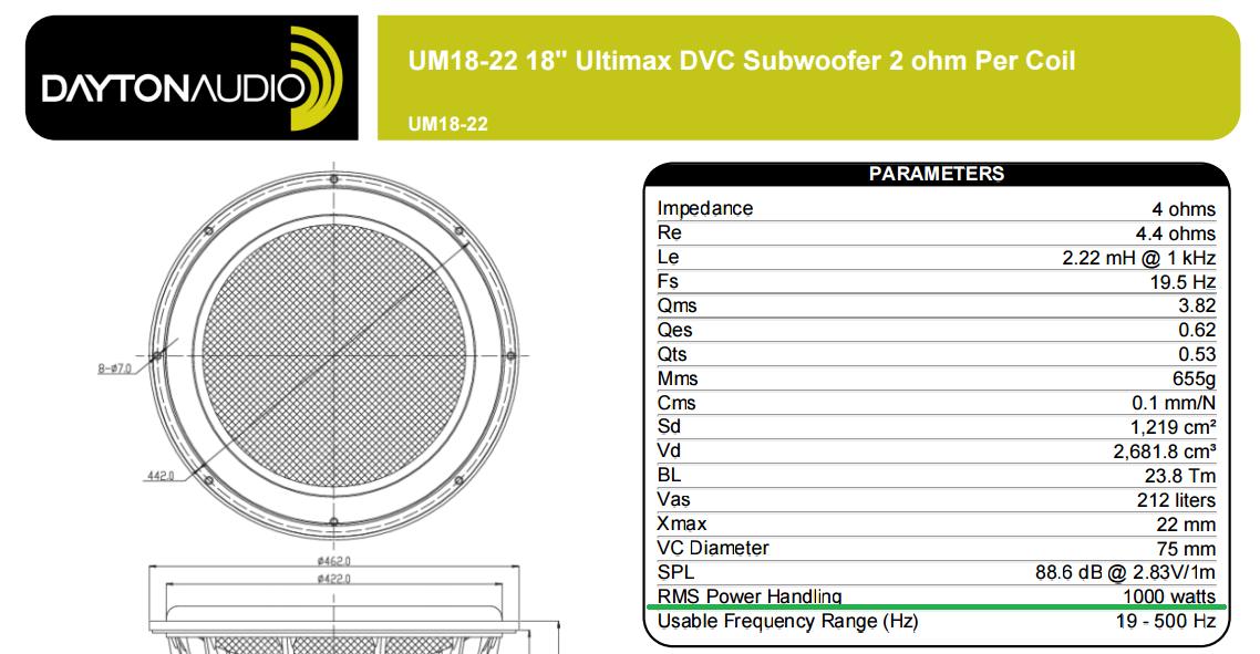

Short on photos this time :/ was excited to get the first subwoofer up and running.
Box stuffed with polyfill, mounted speakon connection.
Wired in 4ohm and bridged on the amp. That should give the driver 2400w!
Measurements tomorrow hopefully.
just out of interest really, but If it says 425w on the back.. how can it produce 2400w ?
Looks a good box volume for the driver.
but realisticly I doubt you will be using 2400watts of power
Thats why it is called an amplifier.
Hi, a amplifier amplifys the audio input signal (smaller current) using the power from the mains. (larger current)
to create a (larger current of audio signal) that is then sent to the driver.
it doesn't amplify the amount of wattage that goes in to it. what with? ..only way to do That would be with a amplifier amplifier.
Someone else can may be able to explain better.

Such amps AC consumption is usualy rated at 1/8 of full output power, so when it delivers 300 watts, the consumption with all accessories will be close to 435 watts.
Music is not sine waves in a resistor, but much more complex. Even close to clipping, an amp will never pull the peak energy from the mains, as it has energy stored in its condensers and coils. If you dont understand, maybe look for "music and crest factor".

Here is a measurement @ -28dB this is before any eq and any room treatment.
This is only one woofer. The second woofer is done in a day or two.
Forgot to mention that i did some spl max testing.
122dB @ 53 hz, then rew stopped measuring... i think the mic did not handle the volume 😱. plenty of more gain.
112dB @ 20 hz. Reached the limit i set on reciever.
109dB @ 15 hz. Reached the limit i set on reciever.
105dB @ 10 hz. Reached the limit i set on reciever

Well, it feels good... It plays really tight in music compaired to my old PB13-Ultra.
The overall output feels just as the PB-13, just a little less in the lower section. I belive a little eq and another woofer will fix this.
The output is not enouh for me but if i keep in mind that this box is about half the size as the PB-13, and 1/4 the cost........ just stack em'. 😀
