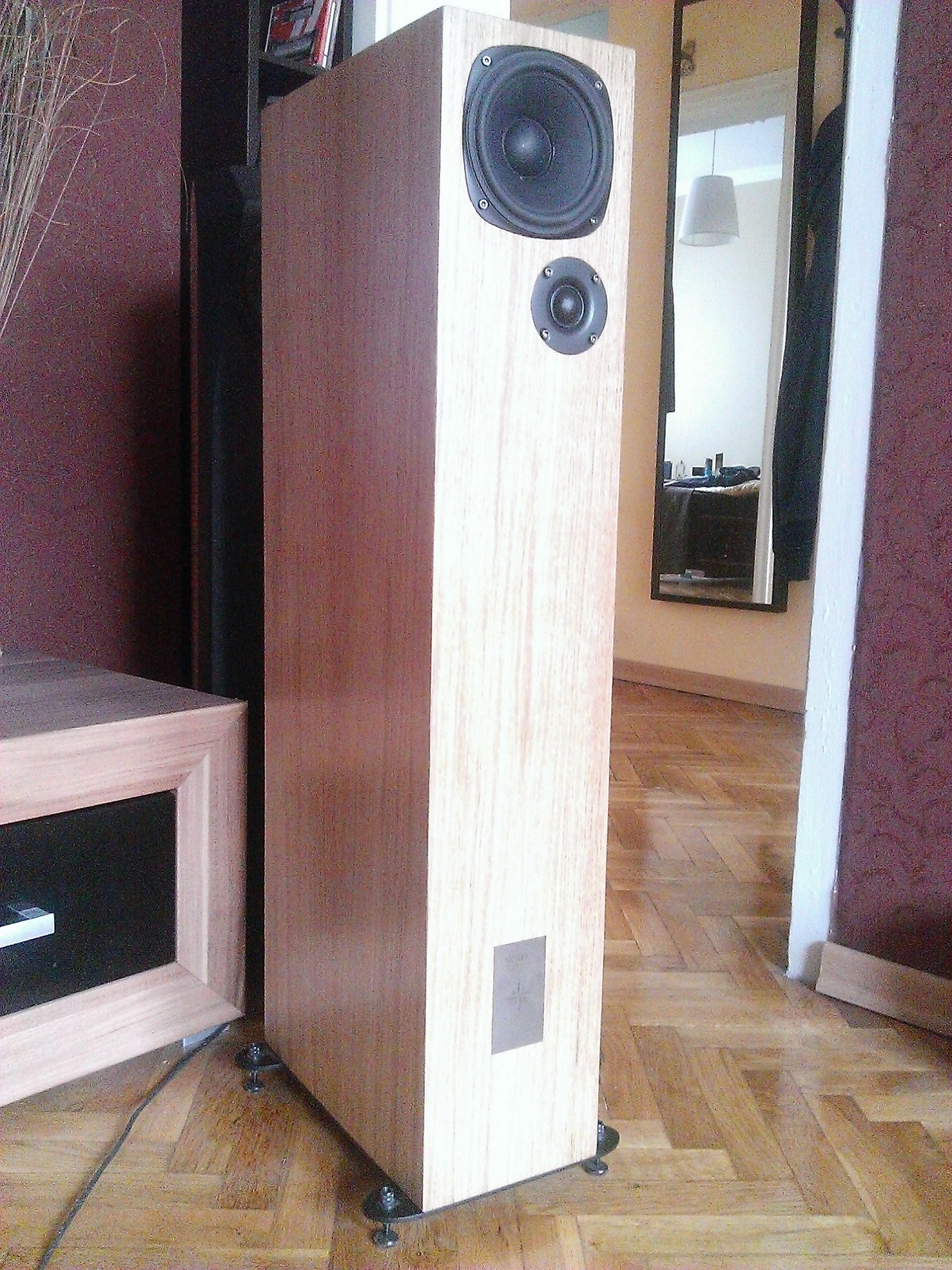

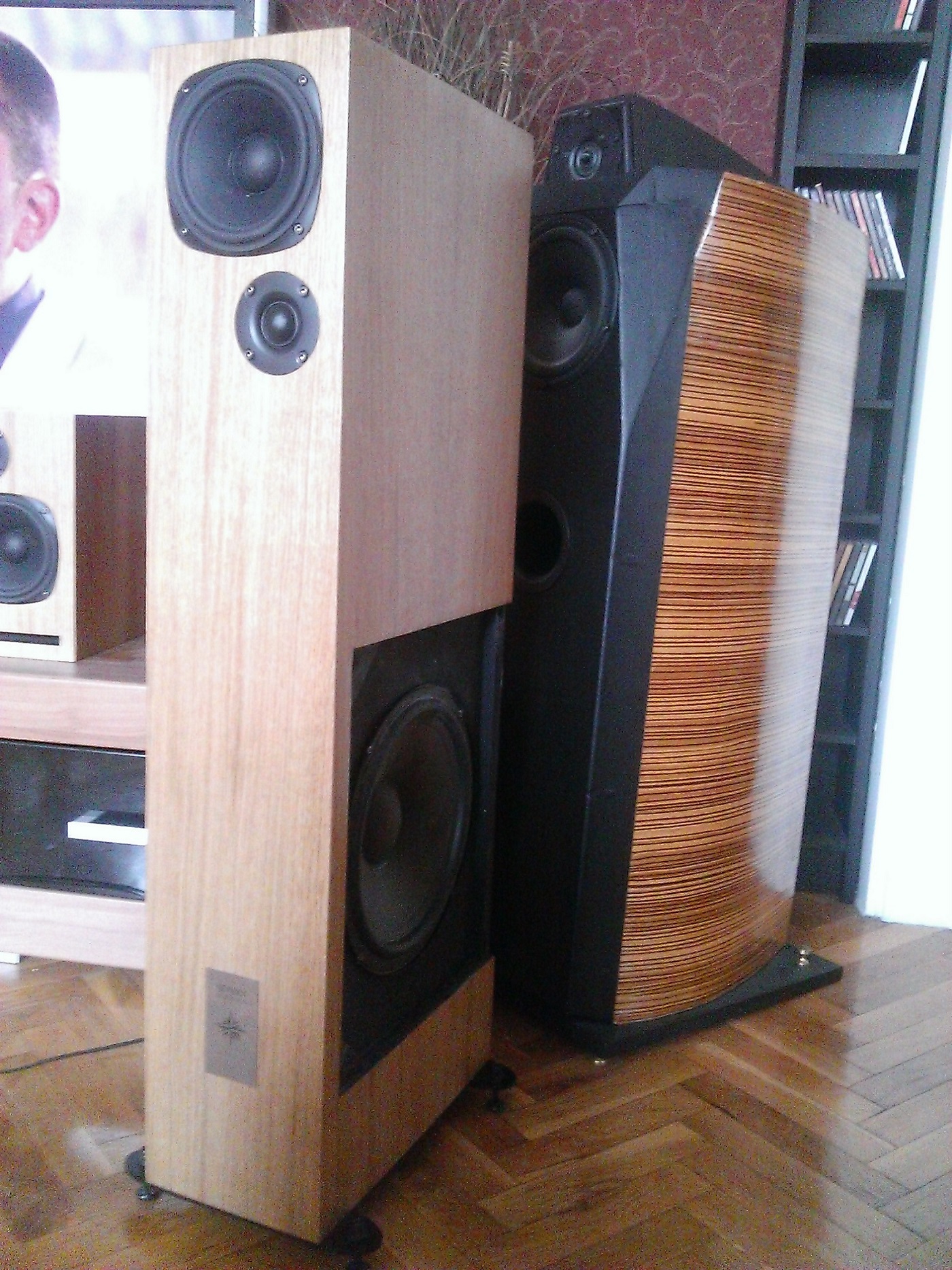

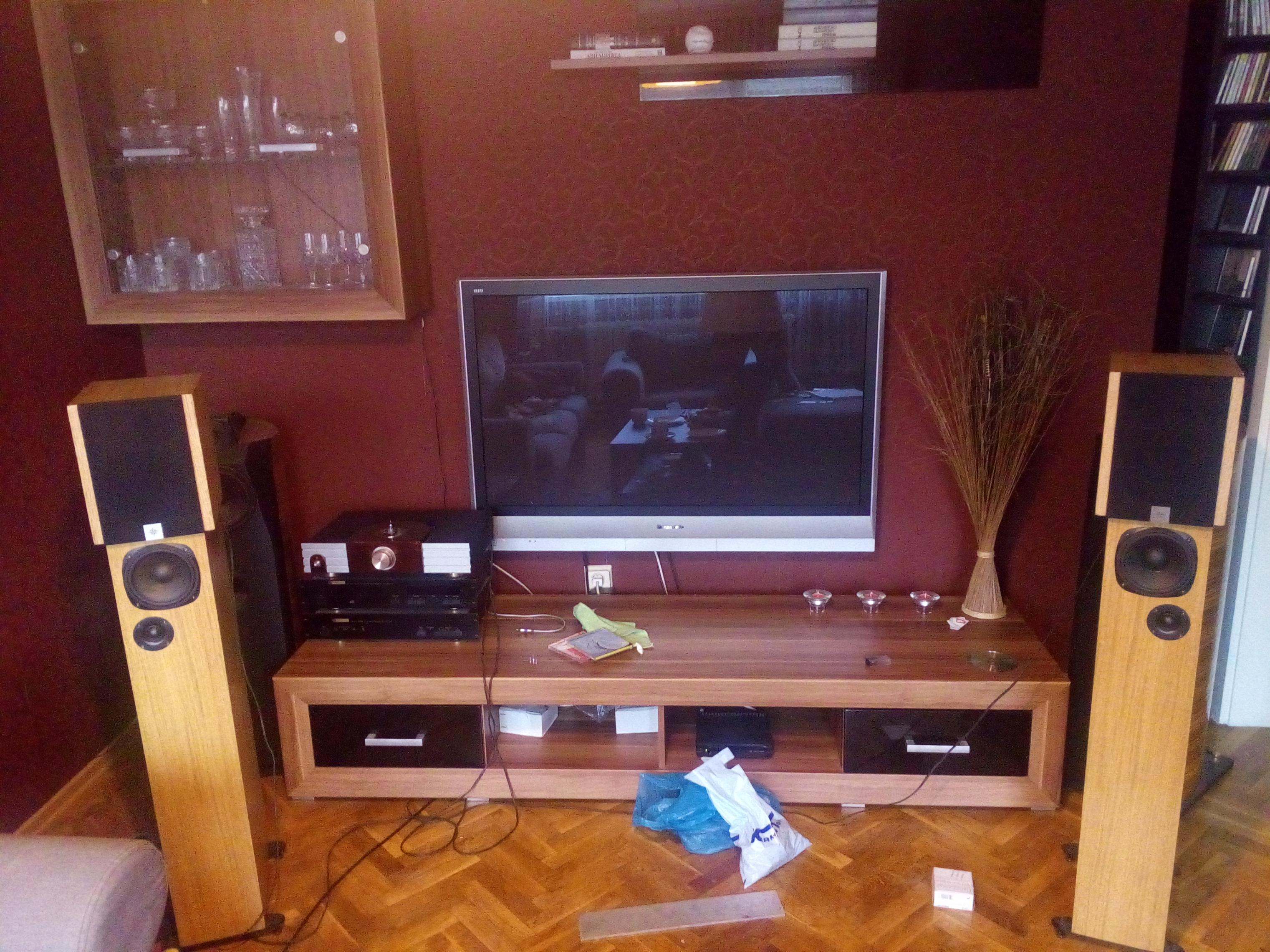

I will look for the plans and design today, can send you also a 3D cad file for CNC routing (although my previous note about this woofer still holds, added costs of CNC for small quantity orders are usually expensive enough to make buying a better midwoofer like the NRX or Seas reed cone a better option). If you like it loud, this is not your woofer or you`d have to use 2 per side (so my crossover won`t work).
Wood: I have attached a zip file with all the pieces that are CNC-d - 3D .DXF files for the front panel so can directly give them to the routing company. They`re all 18mm except the front panel which is 25mm (900x170x25). I have also attached a file with the pieces needed, you can ask a company that sells plywood or mdf sheets to cut them for you, here its like EUR9 per sheet so decent. The woofer was sunk on these so a grille can be mounted, if you want to take the chance, you can mount it on a straight side instead, but that will pull it outwards and will affect the woofer-midwoofer crossover.
The crossover was comprised of these parts, it was functionally a Linkwitz-Riley both Woofer-Midwoofer and Midwoofer-Tweeter measured on midwoofer axis (with Jantzen numbers):

Unfortunately, the assembly instructions, crossover schematic and measurements are all gone. The base DXF file also, unfortunately. I built all so can help you with assembly instructions. But the hard drive, although with a stuck arm, was accessible after the failure, I bought some USB to hard drive adapter but need some extra power supply and a SATA cable to power it up as an external - if it works and I will do it in a week or so, I will be able to pull all files with all my projects, including this one and will add measurements. I remember the speaker was ruller flat from 1Khz upwards and the midwoofer had a pretty clean CSD plot.
