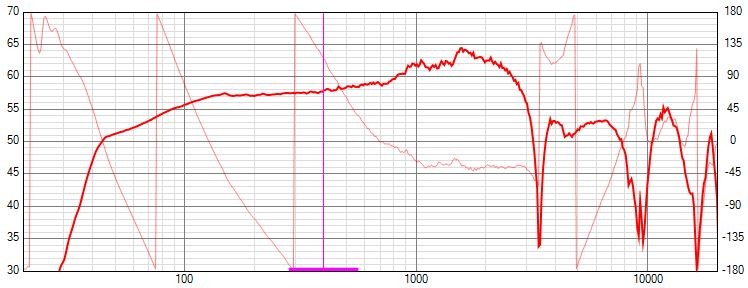

Interesting they're 3rd order electrical for both high & low pass. If it's at 2100-2200Hz as the PDF states, the tweeter rolloff starting at ~1.3 kHz would turn the high pass to acoustic >4th order from that point on.I saw that SB acoustic have just updated the paper on crossovers for the coaxial drivers, to include this one.

Qts -- Can you see whether the dome silk or poly?
Thanks for the info.Looks like silk and same as in other coaxials. I think it is SB14ST-C000-4 / Fabric.

Strange measurement (phase and various smallband dips). What is your setup?
The phase looks weird because it's not unwrapped
