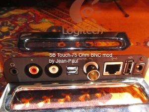

Hi, I opened up a Squeezebox Touch and I see changing the SPDIF RCA to a standard 75 Ohm BNC is not easy in that device. I am curious how any of you did that. A picture would say a lot. I modded quite some O2 Jogglers with "short neck" BNC connectors and I have some ideas for the Touch but why invent the wheel a second time if one of you can point me to a fitting type?

After much googling I discovered people talk about adding a 75 Ohm BNC to the SB Touch but few dare to do the mod (I also discovered that this is quite understandable 😉 ). I did find some pictures of SB Touch with extension cables but this was not my intention. If there will be time spent then better spent it on the optimal situation.

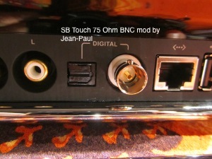

As you can see I did it. It is a tough job with high risk of things not going like you want them to go but I succeeded. The male BNC plug fits perfectly despite the slightly recessed female chassis mount connector. The solder lugs were shortened and they don't touch the PCB. I had to change and make parts myself to make it happen.
I also soldered a decoupling cap on the input DC connector as it did not have much decoupling caps there. The SB Touch sounds fine and the mods delivered what I expected, an improvement.

Hi I got some emails regarding this mod. I used the Tyco 1-1478048-0 but originally I wanted a "short neck" BNC connector. These were not in stock at the time. Please be aware that the Tyco must be modified, the nut is way too thick, the ring can not be used, contacts are too long, it fits but goes way too deep in the Touch body etc. Even the boards need to be changed and the plastic body of the Touch needs to be changed too. I fabricated a filler ring at the outer ring to make the BNC connector not too recessed. Otherwise the male connector would touch the back panel and damage it or it would be very hard to mate the connectors. All this is really an awkward job with high risk of failure, I can only recommend the result not the amount of work it needs.
It took me nearly a whole saturday to get this done without seeing any traces and to have it mechanically stable. Please bear in mind that the BNC puts a different stress on the body and that the complete rubberized backside panel needs to be taken off and needs to be glued again with 2 component glue....

Being a latecomer with the SB Touch I wish I would have seen that before (and I thought I know how to use google right 😉 ). However, I did it very differently but I also used a filler ring and secured the connector with an extra thin and less wide nut.
