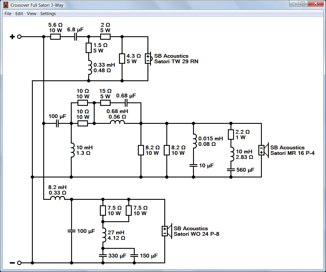

I have similar construction in process. NE265+MR16+TW29. At the beginning there was WO24P but I was not satisfied with its sound. I tried LR2-LR4 at 250-400Hz, but certain character was still there.
Images are not updated yet but Vituix six pack is up to date:

Here is a model of the NE265W 8 Ohm assuming a Qt of 0.3 (I always use an inductor with very heavy wire gauge so DCR added would be very small).
With a Ql of 15; 33 l looks pretty good; f10 about 23 Hz
With a Ql of 7; box size goes up some but I have stuffing to increase apparent box volume. f10 would still be about 23 Hz
The 4 Ohm version has more sensitivity and actually calls for a smaller box size here. I think the slightly higher Q of the 8 Ohm would be a little more to my advantage but the difference is very small considering...
Comments??? Advice??? Experience???
